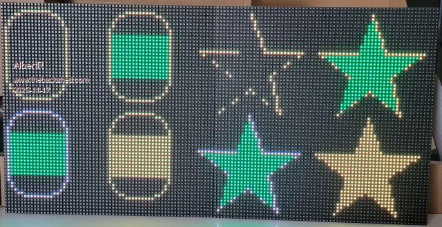

I think I have found an other bug of the Userdisplay-driver in Basic
The picture show the problem, Roundes Boxes work in Outline perfect but fails in filling, with Polygons it is reversed.
Albert
Posts: 12058
Posted: 11:01am 17 Nov 2025
Please try RC14 and report

Posted: 01:02pm 17 Nov 2025
Hi Peter,
I tried it with RC14, the same result. All other draw-functions for the "Userdisplay" works perfect as you can see in the video.
UserRboxPolygonTest_.zip
Albert

Posts: 12058
Posted: 03:59pm 17 Nov 2025
What exact firmware version are you using? RP2040/2350 PicoMite vga etc
Edited 2025-11-18 02:00 by matherp

Posts: 12058
Posted: 05:28pm 17 Nov 2025
I suspect your drawrectangle routine isn't sorting the coordinates
Sub mm.user_rectangle x1,y1,x2,y2,col
local integer t
If x2<=x1 Then
t=x1
x1=x2
x2=t
EndIf
If y2<=y1 Then
t=y1
y1=y2
y2=t
EndIf
The other bug will be fixed in RC15

Joined: 29/05/2025
Posts: 111
Posted: 06:55pm 17 Nov 2025
Hi Peter,
that helped, thanks.
Polygon and RBox work now.
Sorry, my mistake.
Greetings
Albert
