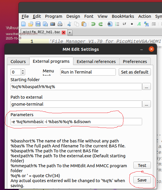

If you had enough beer, resulting in enough courage, you could install MMB4L on your Linux system. Tom provided nice instructions for that.
Then, in MMedit5, in the tab FILE/PREFERENCE you can make following changes:
Then you can run programs directly on your PC (without a mite attached).
