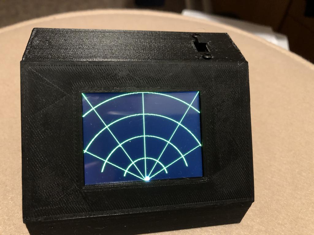

I played around with "framebuffer" a bit. Now it works. It should look like this:
framebuffer create
framebuffer layer
framebuffer write F
arc 160,240,60,,285,75,rgb(green)
arc 160,240,120,,285,75,rgb(green)
arc 160,240,180,,298,62,rgb(green)
arc 160,240,240,,318,42,rgb(green)
line 0,0,160,240,,rgb(green)
line 160,0,160,240,,rgb(green)
line 320,0,160,240,,rgb(green)
line 0,150,160,240,,rgb(green)
line 320,150,160,240,,rgb(green)
font 7:text 0,220,vers 'shows version in left bottom corner
framebuffer write L
No error messages appear!
The RP2450 is running at 200000 kHz. The network lines are not overwritten.

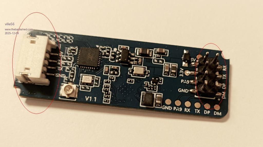

  ville56 said  If you connect the sensor to a serial-to-USB adapter and supply it with 5V you should see data coming with 256000 baud.
How are people connecting these pins which are not .1", 2.54mm O/C like Dupont wires?

On my sensor (LD-2450) there are 2 connectors
1) 8-pin pin-header:
From the manual it shows that the pin pitch is 2mm and the pins are 0.5 mm square. Mating connectors could be something like this:
Connector
if you are good in soldering, you can solder thin wires at the pins directly or at their pads on the pcb.
2) 4-pin inline housed connector:
this is the one where pigtail cables are offered with the sensor.
Both connectors offer the same signals (Vcc, GND, TX, RX), the 8-pin connector has some additional signals of, to me, unknown usage.
Note: the RD-03 seems to miss out the 8-pin header, but I'm not sure as the manuals are not very precise (in every respect).

  Quote  Note: the RD-03 seems to miss out the 8-pin header, but I'm not sure as the manuals are not very precise (in every respect).
RD-03D 4pin connector is 1.25mm jst.
The only other connection possibility is the test point pads which are 2.54mm spacing so if necessary, a standard header could be soldered on. This is what I did while waiting for some 1.25mm jst plugs.
- So the 4-pin connectors are the same on RD-03D and LD2450
- the test pads on the RD2450 do not have a Vcc pad ...

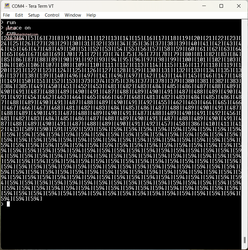

@ v.lenzer,  Loaded and ran that code but no go I get this when I have 'Trace On'
it gets stuck on line 594
Although it runs the code to display the grid nothing appears on the display.
I have never used FRAMEBUFFER before, it's all new to me.

Palcal,
the code loops waiting for characters on the serial line in order to find the header of a datagram (synchronizing). Please check the lines 32 to 42 in the code for the setup of the serial line. You have to set the following 2 lines matching your setup:
first define your pins for the serial line and assign com1 or com2. You can find more info in the MMbasic manual in appendix A (Serial Communications)
 setpin gp0,gp1,com1
next define the com, baudrate, buffersize, interrupt handler, interrupt threshold in a string
 const s_comspec = "com1:256000, 256, ser_int, 30"
Looks like the sensor is not connected to the com that is used by Joachim, or you just rewire your com-port setup.

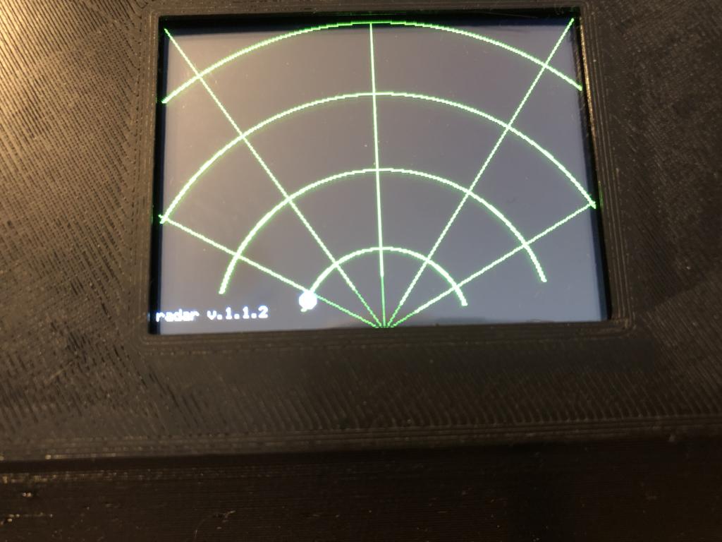

While experimenting, I accidentally added the line "framebuffer merge 0,b" twice in the `draw_data` subroutine (lines 335 and 346). While this doesn't cause any harm, it's unnecessary. One entry in line 346 is sufficient.
After switching it on, the white dot might not appear immediately. Just wait a little while or wave your hands in front of the antenna. I have the Bluetooth antenna connected to my LP2540 and can operate the radar simultaneously with the Zero and the mobile app.
Today I received the RD-03D. I'll try it with that as well. Perhaps there is a difference in sensitivity.
Best wishes! Joachim

Hi Gerald!
The BLIT version works for me too. However, the lines over which the dot has passed become thinner.
P.S: My BAUD-Rate ist 225000. You can change the baud-rate in the mobile app.

  v.lenzer said  Hi Gerald!
that is strange .... in fact I already found it couriouos that your gridlines were more than 1 pixel wide as you did not specify a width. This may have something to do with (line) drawing algorithm used in the firmware.
btw, the fact that the dot does not always appear immediatela is because the sensor deliveres data with "no target" and that is suppressed in draw_data, statement
    if param_arry(idx,0) <> 0 then
so you have to insert a target into the radar beam (hand) to get data which are worth to be displayed. You can look at the numerical data with no target just by pressing P and Z.
