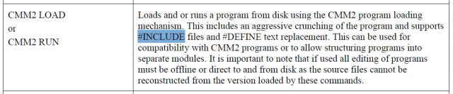

The PicoMite manual has a CMM2 LOAD command which mentions "#INCLUDE".
But "#INCLUDE" produces an error:
[11] #INCLUDE "jobrec.str"
Error : Invalid character: #
#INCLUDE would be useful for having a file which contains a structure for a file of structured data.
Edited 2026-01-08 02:22 by lizby
Posts: 12059
Posted: 04:45pm 07 Jan 2026
#include only works within a file being loaded by CMM2 LOAD or CMM2 RUN

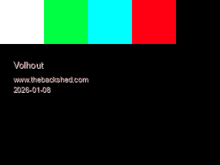

Test code for colour map on LCD (tested on ILI9341, running 5.09.00rc5 that supports colour map on lcd).
framebuffer create
framebuffer write F
dim col%(15)=(0,0,0,0,0,0,0,0,0,0,0,0,rgb(white),rgb(green),rgb(cyan),rgb(red))
dim indx(3)=(12,13,14,15)
dim paint(3)
colour map indx(),paint(),col%()
for i=0 to 3
 box i*64,0,64,64,1,paint(i),paint(i)
next
framebuffer copy F,N
Edited 2026-01-08 19:16 by Volhout
Posts: 12059
Posted: 09:40am 08 Jan 2026
What should I see?
Posts: 6197
Posted: 10:00am 08 Jan 2026
Peter,

Posts: 6197
Posted: 10:56am 08 Jan 2026
@Peter,
RC3 colour map works in LCD, heap size is 159kbyte (even the unaltered Thermal Camera works on LCD with this version). I quickly checked Petscii on LCD, and that works as well.
Looks like you optimizing and tuning really payed of.
Excellent work !
