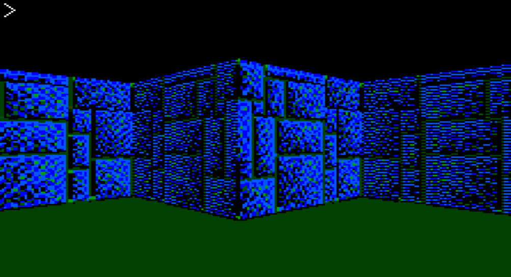

Hi Dietmar,
Yes but the x, y and frame speed are not visible?
Plus you get the coloured stripes down the side of the screen, which I believe are the dithering patterns, which should not be visible, so clearly something is not correct?
Regards, Kevin.

Kevin,
my last post with this as I don't want to spoil Martin's thread.
I think something goes wrong with blit framebuffer and might be a firmware issue.
Try
Blit framebuffer F,N,0,0,0,0,MM.HRES,MM.VRES
works while
Blit framebuffer F,N,0,0,0,0,MM.HRES-1,MM.VRES
does not.

Hi Dietmar,
I've made a discovery, looks like it's a bug, if you'd like to post it up for Peter.
If you set Blit framebuffer F,N,0,0,0,0,480,240 (ie full frame width, but reduced height) it works, except we are copying the whole width, which is not what we want, if you change the width to anything other than full width, it fails.

  dddns said  Kevin,
Try
works while
does not.
Regards Dietmar
Wasn't there something about Blit Memory that meant it always had to be an even number of horizontal pixels? So that it always worked with full bytes. It's quite possible that it's similar with BLIT Framebuffer.

@Homa
Hello Matthias,
I took the time to implement your suggestion.
It looks really good for a Pico.
However, as expected, the frame rate drops to below 1 FPS/s.
What still runs and looks quite acceptable under MMB4W is simply no longer (seriously) executable for the Pico or Pico2.
I'm not sure if it's possible to improve the frame rate, but I'm afraid it's not possible to make it run on the Pico.
Of course, as you suggest, you can increase the step width both horizontally and vertically and then work with the box command, but this will make the texture coarser beyond recognition.
The solution here would be a scalable version of the Blit command, but we don't have that.For the sake of completeness, I'll attach it anyway.
Maybe someone can speed things up after all.
ccast.zip
Martin
'no comment
