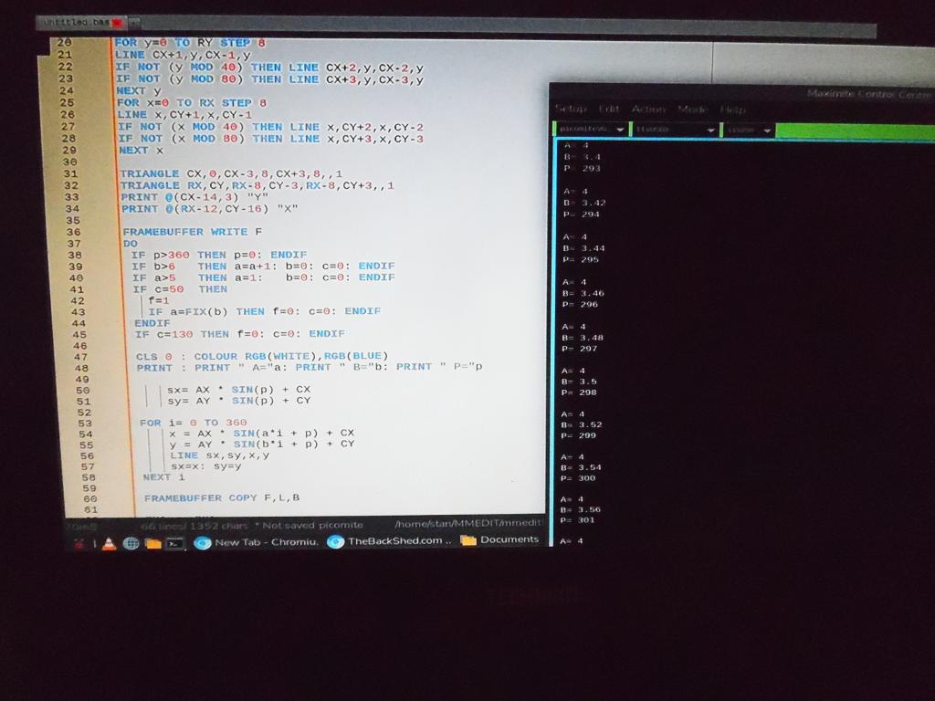

@Jim. Brill! latest zip tar version WORKS! ... extracting was confusing, just zip was easier. Try flashing code next. Thanks again. regards stan
edit, just flashed the lissajours code and it works. got to remember groups dialup usb for it to use usb to ttl
