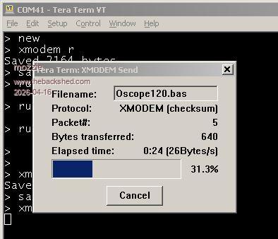

G'day Peter,
File Manager is looking good, a welcome addition now we might have USB mass storage.
Testing V6.02.02B2/B4 has shown XModem is working to program memory but locking up when saving to A:
> option list
PicoMiteHDMI MMBasic USB RP2350A Edition V6.02.02B4
OPTION FLASH SIZE 4194304
OPTION COLOURCODE ON
OPTION KEYBOARD US
OPTION RESOLUTION 800x480 @ 333000KHz
OPTION DISPLAY 40, 100
This is working OK in V6.02.02B1 (on another device) with similar options.
> option list
PicoMiteHDMI MMBasic USB RP2350A Edition V6.02.02B1
OPTION KEYBOARD US
OPTION HDMI PINS  1, 5, 3, 7

Posted: 04:28pm 15 Apr 2026
Just worked perfectly for me saving a 72Kb file to the A: drive HDMIUSB version B4

Posted: 07:40pm 15 Apr 2026
  mozzie said  Testing V6.02.02B2/B4 has shown XModem is working to program memory but locking up when saving to A:
Lyle,
check your version of Tera Term! I also had to upgrade from an older version to 5.2 (I think 5.6 is the latest) to sort out some Xmodem issues.

Posted: 08:06pm 15 Apr 2026
i tested  XMODEM r  and XMODEM r "test.bas" , works OK , using Tera Term V5.3 x86
