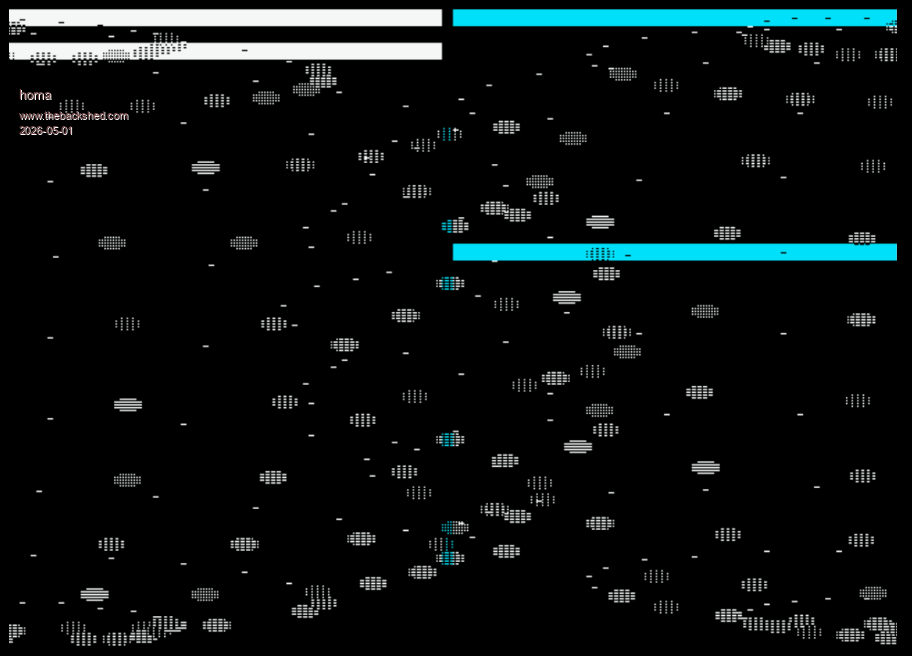

And in B3 there are graphics mode issues. For example, starting demo.bas from FM and aborting it with Ctrl-C leads to this strange behavior when returning to FM. If you then exit FM, the old graphics return. Image 2.
If you restart it, it often recovers.
With other programs as well, after loading and starting them, you sometimes see the screens from the previous programs. If needed, I can record an HDMI video.

@Peter: Check out this video.
https://youtu.be/ooXQd0MIFFQ
I restarted the HDMIUSB device, so it was a clean boot. Despite the graphics and HEAP errors, a reset wasn’t necessary. At the point where only the graphics were visible, I could have entered “mode 1” in the console, which is what I did.
The ZIP file contains the files from Drive A shown in the video demonstration.
The "option tracechace on" setting in the last programme (at 1:05) leads to incorrect calculations and display; without this setting, everything works fine again,
Matthias

What is the sequence to make this happen?
On the graphics mode do you just mean the flash of garbage before FM redraws?
The mod stuttering is just as playback starts or does it continue? If just the start it may be just one of those things until the Picos cache catches up.

Posted: 04:55pm 01 May 2026
Have you watched the video?
FM does not return correctly; a graphics error occurs. By the way: is there an option to load/run a programme in CMM2 mode from within FM?
The mod stutters only at the start and when you continue using FM, such as when changing directories, etc.
But if you start it from the CLI, it doesn’t stutter!
> play modfile "axel_f.mod"
Playing axel.f
After editing ccast.bas in FM (F2), then pressing RUN (ENTER) and exit, and then EDIT again, a HEAP error will occur at the latest.

I think I've fixed everything except perhaps the graphics error. Please try this version and if the graphics problem is still there report exactly the sequence to create it

Fixes bugs introduced in LIST PINS and LIST SYSTEM I2C
Fixes bug in cache optimisation of NOT command
Fixes stall of audio on startup and directory change in FM
Fixes memory leak when exiting a program with TRACECACHE enabled back to FM
Fixes memory leak and display corruption when exiting a program writing to a framebuffer back to FM
Fixes temporary screen flash when exiting a program running a different mode back to FM
