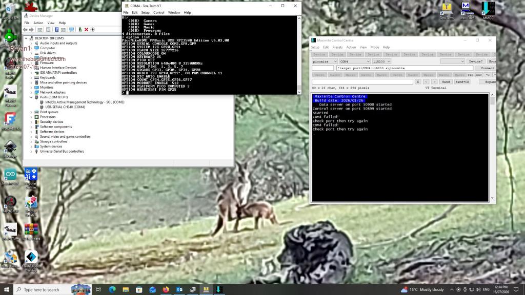

Well the boards turned up this morning
So I got on and downloaded V3 from Peters site and loaded it up, hooked up my mouse,keyboard and the HDMI and tested out the audio and now got stairway to heaven playing   so the audio works nice.
But no COM port assigned for the serial output and the C USB is connected providing power but nothing when I start MCCC and looking in device manager.
Later today I can get 2 boards in the post now Panky and expo if you still want the boards could you please PM your address's.

Posted: 03:23am 15 Jul 2026
I assume you have done "OPTION RESET PICO COMPUTER 3".
Does OPTION LIST or LIST PINS show the console using GP8 & GP9 ?
If either of them show the console using GP8 & GP9 perhaps the CH340 (U7) or USB-C socket isn't soldered correctly. Check with a magnifying glass.
Is your USB-C cable a data cable or power only?
Perhaps load and configure the other boards to see if it is just that one.

Ok I loaded V3 on all 5 boards and tried a different USB cable which fixed the problem so each board did show the keyboard and mouse and each one was audio tested and all worked

So finally got some time to have a play and got tera term connected but sadly can't get MCCC to connect.
I found I had to change the baud rate to get tera term to connect properly but trying the same in MCCC didn't work.
Posts: 3420
Posted: 03:07am 16 Jul 2026
MMCC won't connect while Tera Term is connected to the same com port.
Either disconnect Tera Term (Alt-I) or close it then try to connect in MMCC again.
