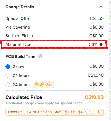

Posts: 3884
Posted: 11:39am 19 Aug 2026
Any idea, Mick, why JLCPCB would add C$11.38 for "Material Type"?
I did note that upon import, it said the width was 100.01mm.
Posts: 9174
Posted: 12:16pm 19 Aug 2026
I'll be surprised if 0.01mm concerns them. I must confess that SL6 measures this at 100.008mm, but I've already had several boards made using this outline already without incurring extra charges.

Posts: 3884
Posted: 01:20pm 19 Aug 2026
  Mixtel90 said  I'll be surprised if 0.01mm concerns them
Me too, and it's not clear that it did. I still wonder what the "Material" charge is for.
Posts: 9174
Posted: 01:29pm 19 Aug 2026
What have you selected? 1.6mm FR4 in green?
