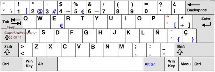

Hi Peter,
I realise this is a long shot, but I got a couple of cheap Spanish Raspbery Pi keyboards, which work fine on a PicoMite if I set the keyboard to Spanish, but on Fuzix the AltGr key is not giving the correct characters, (any characters) when I set kbd to es, see image, curley brackets are particularly useful in C. :-(
Is there any chance of a fix? Thanks.
Regards Kevin.
