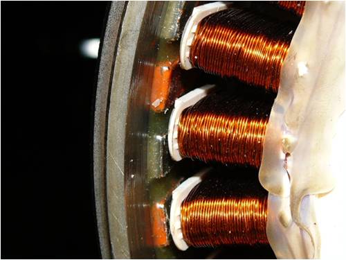

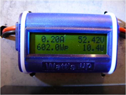

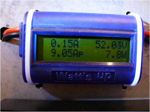

Ok I've got some new numbers on out put. Thinks are looken up over here. Single stator F&P 36 finger 60dc-7s-2p Delta, Neo magnets, caps voltage doubler.
Moderate winds. 602 peak watts/9.05 peak amps so far.

The audio caps will eventually short over time. Not high enough power rating. The can is quite small. I used these on my first 24V unit. I had made a voltage doubler with 2x33uF @ 100VAC Audio caps for each cap position. I had one cap go short. Replaced complete unit with 100uF @ 200VDC caps instead. These are about 3 times bigger, physically. All working well now.
The WattsUp meter works well as a companion to logging as well. I have one, as I mentioned a while back. The peak hold function is really useful. Wish there was a max volts hold instead of a min. These are intended of course for the electric powered model enthusiast.

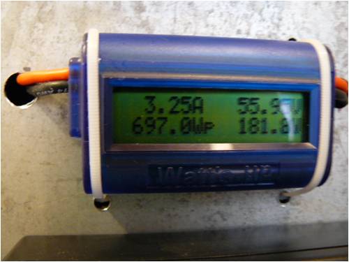

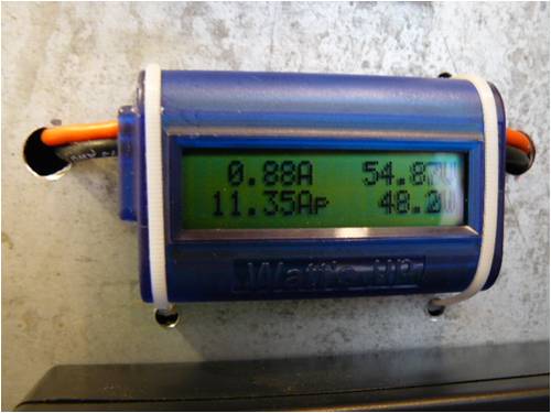

Made a few changes to increase performance.
1.Reduced the alternator offset.
2.Changed the tail offset as well. She is now facing directly in to the wind during average wind speeds which should increase over all amp hours.
697 watts peak, 11.35 amps peak, with caps/voltage doubler @ 25.4 mph winds.
Looks as if these changes help to keep the mill from turning out of the wind to soon. I do believe the mill it's self has reached or has gotten very close to it's max out put. There is more room for improvement with different cap arrangements.
She's still there and flying. With the winter winds, ice and snow on there way we will see how well it hold up?

Hi Jim,
readers should be aware, that the important number in the photos above is only the Ap, and the Wp in the bottom left position of the LCD. The WattsUp meters have a peak record function, and the numbers scroll at that display position.
Gordon.

Jim,
It may be wise to check to see if it still furls ok.... otherwise you may have set yourself up for runaway and overspeed. Try and make sure the new furling changes still protect you from armature reactance problems.

The tail has moved about half furled so far and has furled several times. Haven't had higher winds as of yet. I have been watching it carefully.
Seems to be Ok for now but the jury is still out. I wasn't at home when she reached Ap, Wp. My anemometer recorded 25.4 mph.
Haven't had any problems stopping it with dynamic braking
I would think that the neo's helped.
Thanks for your concern. Your comments and warnings are always heeded.

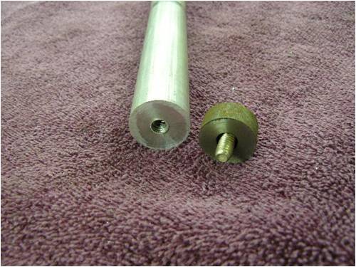

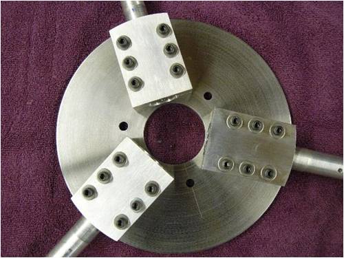

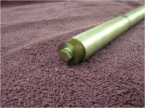

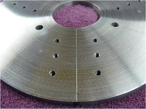

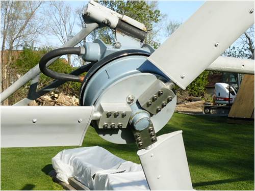

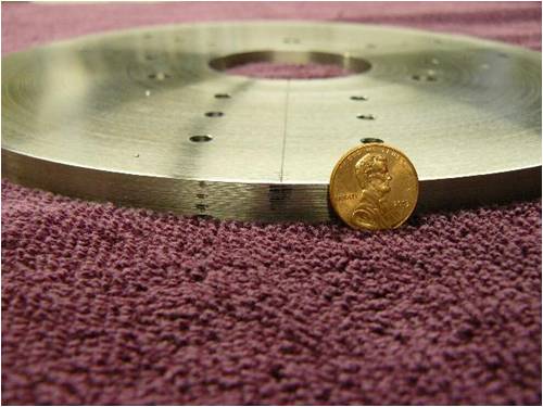

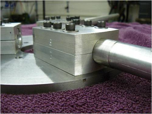

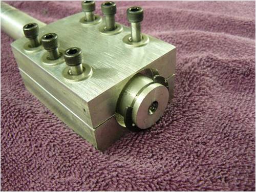

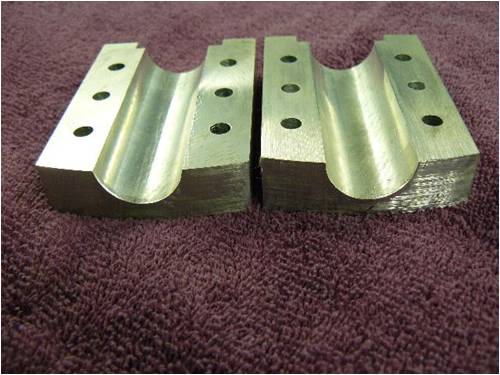

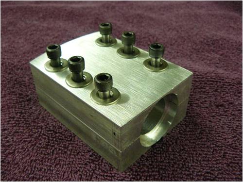

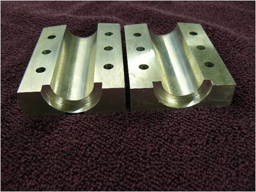

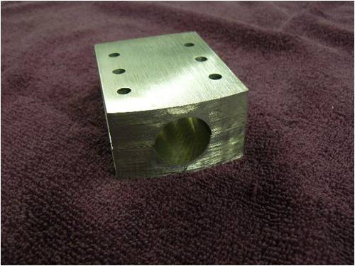

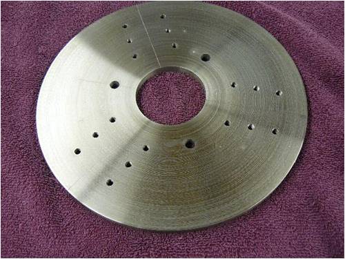

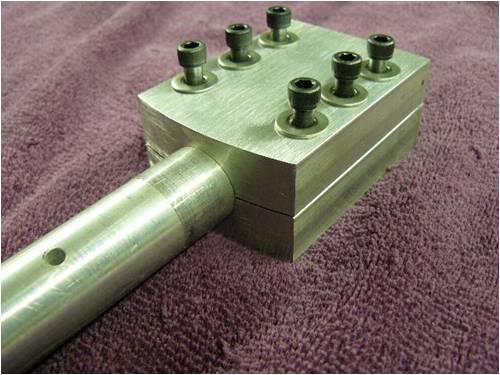

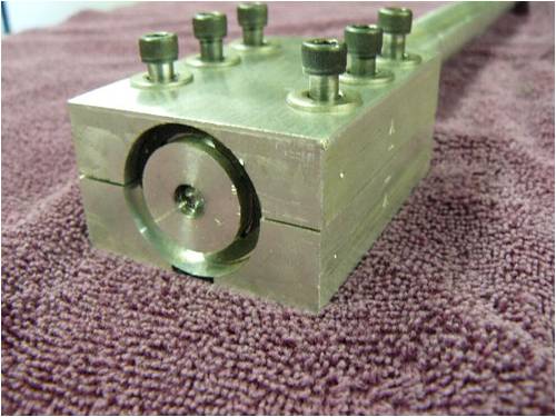

My mill has performed better then I could have imagined over all I am very pleased, however I have had some problems keeping it properly balanced. After a winter of several heavy blows, it has development a slight wobble or an imbalanced situation and of course, it has been driving crazy. I said to my self (this cannot go on!) Therefore, I set out to design and built a better blade mounting system.
I was using 1” steel cores in alum tubing. This is of course is a very lightweight arrangement; I believe this is what contributed or help cause the instability. The mill stayed together even with the Alum tubes instead of steel or stainless.
I remained with steel for the hub plate. Starting out with ½ thick plate but decided it was to heavy and cut it down to 3/8. The original plate was 3/16 thick.
I used 6061-T6 extruded alum rectangle stock to machine three mounting blocks to mount the alum rods to the steel hub plate.
Using six ¼ 28 socket head cap screws per mounting block to secure both the blocks and rods to the hub plate gave me plenty of pressure to keep things nice and tight. Maintaining a gap of approximately 20 thousands of an inch between the upper and lower extrude-ions applies a spring pressure
(if you will) on the rods to eliminate the cap screws loosening from vibration.

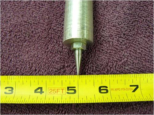

I decided to go to 1” 6061-T651 solid alum rod instead of tubing for blade mounts. The rods extend 3’ in to my existing 4’ long blades.
Using external e clips on the rods ends helps keep the blades at the same length from the hub and adds some security to keep the blades from flying off in cause the mounting bolts work them self’s loose.

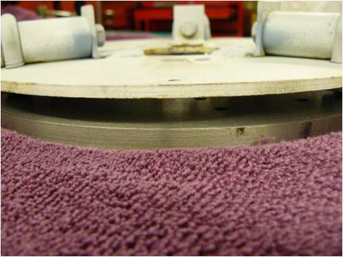

I turned out three-center points to increase accuracy in measuring tip-to-tip distance. Tip to tip is 1/16 of an inch. Blade run out measures 1/8 on an inch.
This time balancing came relatively easy because all components where kept within a close tolerance. I bolted one small weight to the end of one blade and that did the job. I believe the imbalance came form the cast iron drum
I’ve had the new system up and flying for three days with moderate winds and all is well no wobble or vibration. Happy days are here again.
As always, any comments are most welcome.

Wow!
That's some fine workmanship. I love seeing well executed home builts. Looks like I have to go back to the start and read through this whole thread.

Hi Jimbo
Top Job mate some real thought has gone into this, now all you have to do is work out how to put some twist into the blades to increase their efficiency a bit.How did you fit the neo's did you use the original rotor or a reinforced one, this interests me as I am making a twin stator machine and would like to get the best output I can to make the effort worthwhile, Karl is running a dual machine but only getting similar power to your single.
How about a picture of the whole machine now with the new hub.

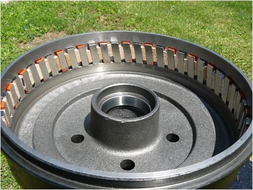

Photos of my mill are in this topic, (earlier posting)here are a few pics for you to view. Neo's where mounted with fiberglass resin. The drum (rotor)is cast iron. The spindle and drum are from a 1700lb trailer assembly.
The neo magnets are what give my single stator the ability to produce the same or similar out put as the dual stator with ceramic magnets.

Yes Jim , I agree with that output. Mine gave around double the ceramics.
Working on an LG hub soon . They appear to be a much sturdier (steel) and larger 25% hub and stator . Also the shaft is larger (30mm) and bearings are much larger.

Thanks for the photos I did see your earlier photos but didn't twig on the rotor construction really a top job I am very interested in doing a neo conversion for my twin rotor one as I haven't started on the engineering yet so it is a clean slate, yours looks like a 100 series stator so we are on the same track a little info in the neos would be appreciated supplier price etc. Also some info on the little digital meter you have would be appreciated.

During lathe testing the neo's easily out performed the ceramics. I seen your LG posting. The LG's look very nice. The larger diameter hub/rotor should lead to some impressive results. Looking forward to seeing your progress.

Gordon is correct he gave me the go ahead with the Watts Up meter. I must admit I did burn out a couple of meters because of over voltage. Do not let the voltage go over 60v or it will die a very fast death, but over all it's nice to have especially when it reads out wattage.
My stator is an 60dc-7s-2p-star/delta. Can't say I am very good at rewires so I purchased from EcoInnovation, yes it was on the expensive side but it did come with a warranty and has performed well. There is very little or no clogging with this 60dc unit even with the neo's.
On Gordons advice I run it in Delta and use caps/doubler. The caps most guys are using with ceramic magnets did not work well for me. A 150uf will stall the mill 50uf to 100uf is what I use, the neo's change things a bit.
Forum member imsmooth is the guy you want to contact about the neo's. I purchased them through him. He did the design work. I like when things work.
Bruce is working on a LG hub setup you may be able to start with a larger and heavier LG stator. I would probably go in this direction. Keep in mind that wind mills take a beating so stay on the heavy side if you can just my thoughts. I think the members that are using the PVC/ALUM blades would agree they are the ticket and affordable.
I have often played with the idea of a dual stator/ single rotor, how ever with a cast iron rotor this would get pretty heavy. Some light truck spindles may work well and a Alum rotor would be a hott setup.
