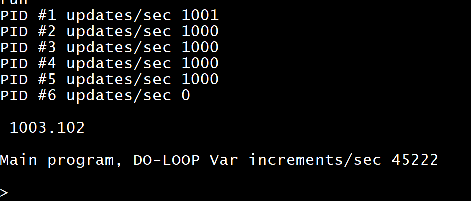

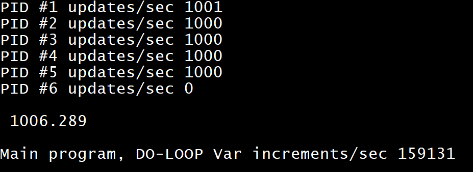

  matherp said  Version V7.00.00b6 is now available at https://github.com/UKTailwind/PicoMite/releases/tag/PicoMite-V7.0.00b6
Improvements to the RP2350 compiler + retry on web connection
Is this even possible?
B5
B6
