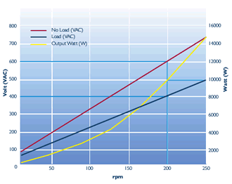

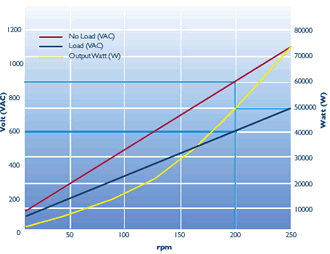

heres an alt i came across a while back
10k
i think they are axial flux (the smaller units certainly are) and suspect the price is astronomical but certainly seem rare and interesting
50k ?
i was told by a dealer here that the us military
use this make (windro?) for some of their stuff so if
thats the case someone in the states is importing them
erm...i,m not recommending them or anything like that ,
hopefully some owner feedback might filter through at some stage
niall
edit...sorry Perry you already mentioned this alt... didnt check your earlier link properly... Edited by niall1 2010-03-21
niall
