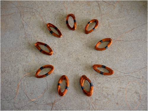

Update 7-5-2010
Building The Stator
This is the part that gets into actually making the electricity. The stator consists in this case of 9 coils arranged in a circle and stuck in place with epoxy resin.

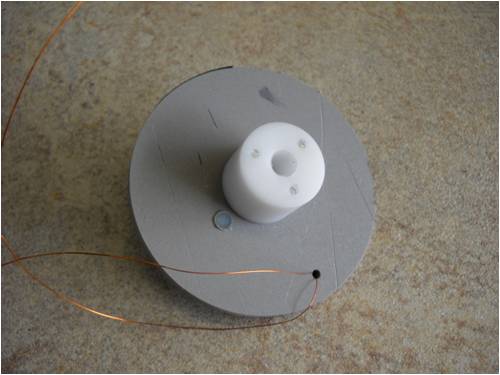

First off, I built a little gadget to wind the coils with using my lathe. As easy as this might sound, it was actually anything but easy.

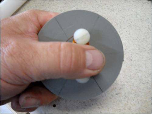

Here's what I came up with. It's a sheet plastic disk screwed to a plastic
hub. Everything was spun and cut on center. I added two 1/4-20
plastic bolts, which serve as posts on which to wind the wire. That
black stripe is so I can count the turns as it spins chucked in my lathe.
Here it is from the back side showing the three little 6-32 threaded holes
that house the three screws, which hold the plate to the hub. That small
hole in the grey plastic is a "keeper" used to hold the starting end of wire
while the coil is wound about the two plastic screws on the face.

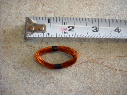

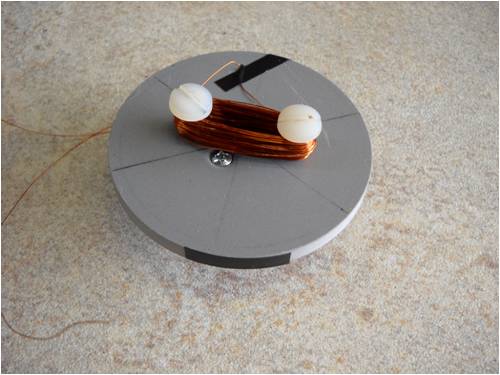

Here's one completed coil. Note the size; it's tiny. Nine of these little
rascals will share the space between the two 12-magnet wheels.

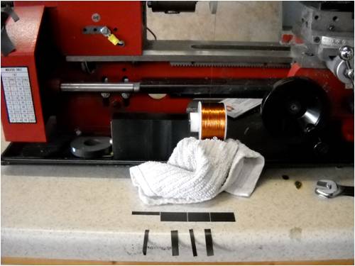

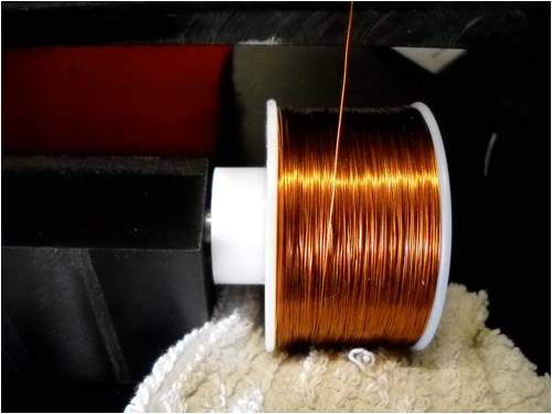

I manufactured a spool holder and stuck it to my lathe bed using a
magnet (temporary mounting). The towel adds "drag" to the spool of
copper wire. I found out the hard way what happens when an unbridled
spool of wire traveling too fast gets away; bird's nest mess! The towel
slows the feed and I put the lathe in "granny gear" and ran it way slow!
Those little black strips are electrical tape that have been scored with
a razor knife. I use them to tape the sides of the coils so they won't
unravel.
This shot shows the spool of copper wire and the rag underneath
helping slow it down so it doesn't get ahead of itself and make a bird's
nest.

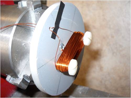

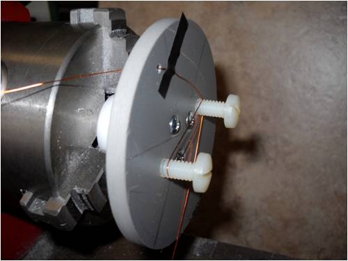

This is the winding plate and those two nylon-plastic bolts. The little
hole keeps the end of the wire out of the fray. I also tape the wire
where it goes through the little hole in the plate. This keeps it tight
against the plate and not interfering with the rest of the windings. A
small piece of tape on the circumference gives me a visual cue as to
how many turns the thing has spun. These coils each have 150 turns.
Here is one 150-turn, 30-gauge enameled copper wire coil ready to
be taken off the winder.
Remember to hold the coil so it doesn't jump off and make a mess
when the turning-peg screw is removed. I just slipped the coil over
the top of the remaining screw and taped each leg with electrical tape.
Here are all 9 coils arranged in a circle. The next step is to make a mold
and encase all these coils in epoxy. Something to keep in mind is the
direction of the wire in the coils. When three coils are tied together
forming a single "phase" you'll want to know which wire is which. If
you hook it up backwards it won't do diddly; we don't want that!
As soon as I figure out the "potting" process, I'll post the resulting build here, so stay tuned for the next installment. For now, I'm finishing up some 4-foot Coroflute blades, which are 3" at the root and 2" at the tip. They should be fast as well as powerful and provide more than enough power to crank this little ax-fx!
. . . . . MacEdited by MacGyver 2010-07-07

oztules
Joined: 26/07/2007
Posts: 1686
Posted: 08:05am 06 Jul 2010

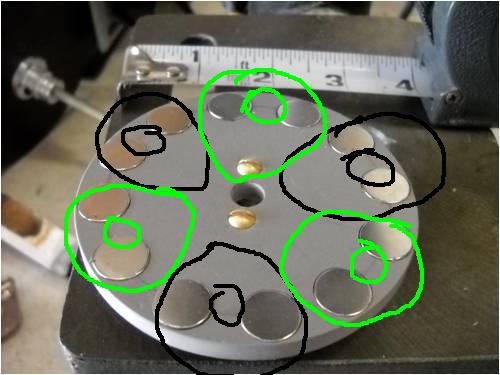

Seems a lot of spare real estate there.
Those magnets are 1/2" X 1/4" by the looks of it, that means your magnet gap will need to be less than 3/8" thick.... so a stator in the order of 1/4" thick max.(plus 1/16th inch air gap each side)
It may better that you just wind round coils, 1/8" thick with a 1/2" hole (use a 1/2" former), and see if that will fit.... you still need a bit of glass in there to help the resin have some body.... best not to use epoxy for the stator, fibreglass resin seems to handle this better.
How did you arrive at the turns number?.
...........oztules

oztules
Joined: 26/07/2007
Posts: 1686
Posted: 11:12pm 06 Jul 2010
Somehow I guessed how the calculations were done
Do a test coil. (or use one of those to get number of turns per volt at a fixed rpm). For a 12 volt system using your new corflute blades, and guessing a TSR=6, we get the following scenario.
For a little blade set like this, it will spin easy (because it is axfx), but not really worth saddling up until about 10 mph, unless it has good adjustable furling.
Even here, while there is 13 Watts available at the blade.... to aim for a lower cutin would give us much more extra resistance in the stator,..... so if we wind for lower cutin, resistance will likely cook the stator too easily, for very little gain... big blades for a little alternator.... we compromise.
So blades= 1.2M (4')
Cutin speed @ 10mph, rpm = 400 .
So @ 400 rpm we need to see X volts in a single coil
We want to see 13vdc @ 400 rpm.
So we multiply the 13vX .7 to get the AC voltage we would need to have to get the 13v peaks when we rectify. So our 13vX.7 = about 9.1vac
We will use star to get this voltage so each coil group will contribute about .58..so
9.1X.58=5.3vac per phase.
We have 3 coils per phase, so we can divide that by 3. So 5.3/3=approx 1.8vac per coil @ 400 rpm.
Going the other way.
We have 1.8v per coil @ 400 rpm
3 coils gives us 5.4vac per phase.
For star we multiply by 1.7
5.4 X 1.7 = 9.18vac.
We rectify and so we get the peak value as 1.4 X 9.18 = 12.85
This was pretty rough maths, and good enough for this purpose.
So at 400 rpm, we want to see about 1.8vac from a single coil.
We then can use the thin wire and wind this many turns to get this voltage, and check again.
If we have lots of room to spare, you wind two in hand or three in hand to fill the thickness and the leg width window.
This will get you the best you can do within the physical constraints placed on the system. (your design)
Now your 4 footer will be developing 150 watts @ 20 mph. (8-900 rpm) I'm not sure this tiny unit will stand up to this, even with late cutin.
..........oztulesEdited by oztules 2010-07-08

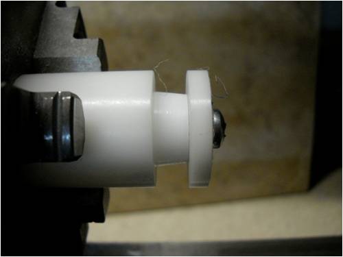

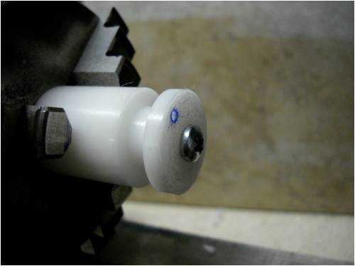

I manufactured a new coil winder this evening after work:
It's one piece of 1" acetal rod with a 10-24 thread running down the
middle. The end is a 'washer' I cut off after threading things. Note
how the center thimble is tapered. This lets me slide the finished
coil off the thing without having to tug.
Look closely and you'll see a little "blue-ringed" hole cut into the end
washer. This lets me thread through the initial piece of wire for each
new coil. The hole holds the wire in place for the first several turns.

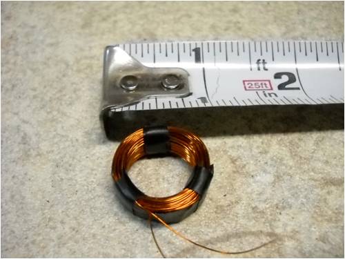

Here's a finished coil. The inside diameter is 1/2" and the outside is
just under 1". It is 1/4" thick and holds 200 turns of 30-gauge wire.
There was enough wire on one of the previous 150-turn coils to make
this one with even some left over.
I have not yet tested the coil. I had to play plumber (my profession) all day long and didn't get home until about 8 p.m. Tomorrow, I'll chuck up the 12-magnet-pair ax-fx wheels in the lathe and spin it at several known speeds to determine how much voltage one coil makes. Once I know how much electricity (a.c.) a single coil produces, it will tell me how to make the other 8 coils. There are to be 9 independent coils in the stator when it's a done deal.
I found that by cutting a 1/4" strip of electrical tape about 2 inches long, it wrapped around the coils of wire while it was still clamped inside the winding spool on the lathe. When I slid it off (it almost "jumped" off the winder peg by the way -- thanks to that taper I cut into it!) the winding peg, I held it gently and wrapped three more little 1/8" x 1" electrical tape pieces at 120-degrees around the circle to hold all the tiny wires in place so I can handle it without things coming unraveled.
I'll post the coil-test results as soon as I can take the time.
. . . . . . Mac

Mac,
Getting the voltage you want at the revs you want is the easy part, thats only wire turns.
240v, 12v, it is all easy..... but...
Getting useable power out is a different story, and requires the best use of what you have got, as voltage without current carrying abilities is not much value.
You cant drive much with the spark from an ignition coil, but you sure have voltage
..........oztules

[Quote=Oztules]You cant drive much with the spark from an ignition coil, but you sure have voltage.
I know that, but I had to start somewhere and I just happened to have a roll of 30-gauge wire kicking around, so that's what I used.
I imagine anything worth having will be in the neighborhood of 16 to 14 gauge wire as far as current-carrying ability goes, but i didn't want to spend lots of $ on spools of wire right out of the gate and decided to go with what I had on hand. I'll fine tune this thing as I clean it up. For now, I'm still taking 'baby steps'.
. . . . . . Mac

Mac,
As Oz said earlier you dont need to buy a different wire size you just wind two or three strands in hand.
This means you wind 2 or 3 strands of wire together in parallel.
It is like running 2 water pipes next to each other to double the flow (as you like a plumbing answer)
Once wound then join the strands together on each end.
Think of it as, 2x 1" pipes = a 2" pipe. so 2x 0.5mm wires = 1x1mm wire.
The bigger the size copper wire (or total of) the greater the Amps output for the same amount of turns.
As Oz quoted you need to workout how many turns are needed, then fill the "Real Estate" you have, with as much copper wire as you can get in, with maintaining the number of turns needed.
If its 50 turns you need, then wind as many strands of wire as you can possiable fit in for the area avaliable for each coil.
At your present rate you will end up with lots of short length of wire all wound into little coils but not much good, other than using them to rewind into another coil for 2 or more in hand.
Pete.

MacGyver
Joined: 12/05/2009
Posts: 1330
Posted: 05:02am 07 Jul 2010
Pete
Thanks for that. You see, all along I've kinda wondered what "in hand" meant. Now I understand. It makes perfectly good sense both from an electrical as well as a plumbing point of view.
I'm going to see what I get with the 200-wind coil I made this evening gust for kicks & giggles anyway. I already took the time to build it; may as well test it, eh?
I still think a basic terminology section would be well worth the time it would take to build and post here on the 4m. This is a perfect example. "In hand" may be somewhat of a colloquialism but for someone not of the same region, it's Greek! Then again, maybe I'm just thick; thick headed -- the rest of me is getting pretty fit of late!
. . . . . . Mac
