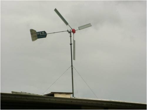

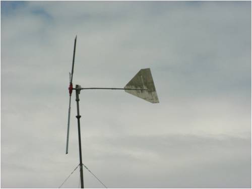

Hi Rastus
The one I have up at the moment has ventilation holes in it, but I do not think they a necessary if the machine is operated at its rated level 500 to 700 watts, the two things that can destroy these alternators and any others for that matter is prolonged overload in excess of 1000 watts and not furling properly as the centrifugal force distorts the rotor causing magnets to rub.
The other killer is the shorting switch brake if used when they are already very hot as to short the windings can cause very high amps at very low volts and nearly instantly cook the windings as the inertia of the blades packs a fair amount of kinetic energy. If you must use a shorting switch make sure there is enough resistance in circuit to dissipate the energy so it not done in the windings.
The units are light and efficient and easy to work on and with, the blades are in my opinion the best I have seen on a small turbine and the price is right, the complete kit only cost a little more than a set of neo's for a AFAX. OK not the high output but id really performed in a low wind environment.

Fillm has kindly emailed me his further furling mods,(original furling mods are available as I`ve kept all emails) so hopefully I can get my units furling better. I have replied to your email, Fillm, on the 4M to keep others informed. I do not wish to be frustrated by incorrect assumptions by 4M members as illustrated earlier in this thread by Amack`s trials with these mills. I have a further safety circuit breaker of 15amp on the DC output of each mill. These have never tripped, in the time both mills have been in service(since May11). I drilled cooling holes 6*3/16 on windward side 6*5/16 on downwind side angled to pick up and exhaust air(as per Bob`s mod, but smaller holes). As stated in the thread OEM mills, my mills do not achieve much over 500watt peak(638watt peak recorded), logging now confirms this whether this is because I left the original wiring in the head, only 2.5mm2 from mill to rectfiers, my angle of attack is too much to achieve revs reqd., or as I have suggested Film`s logging has an error here.
Current cloudy weather has allowed me to leave the mills on continually without overcharging batteries. I am getting an average of around 600watt/hr per day from both mills, the Selectronic inverters logger with current shunts for sensors agrees more closely with my DC clamp meter(records MAX) than the SC logger with hall effect sensors. I am tending to think shunts are more accurate and linear than the hall effect sensors I am using, have wired two sensors in series and logged, this has supported my thinking. Next I will try 2 shunts in series and log, just a matter of getting around to it.
Regardless of my criticisms of the OEM`s, they are mighty little Mills although for my 48v system they are not ideal, but are giving good results with the cap-doublers at my not ideal wind site, I plan on switching back to cap-trebblers on one mill now I have logging for a test. My solar cells are the backbone of my system with the OEM`s putting that bit of icing on top. Edited by norcold 2012-01-05

Hi Vic
Nice to see you are having success with the little mills now, your results are very good considering a less than Ideal position for wind.
Your wiring is a bit lighter than mine but on 48 volts that shouldn't be a big issue, I have finally got some more mills from Phill so can try out a 48 volt version, I was also able to get a five blade rotor from Phill to try out some other ideas I have.
Interesting what you say about the hall effect sensors I have been thinking of shifting my shunts so I can use them if ever I get around to doing a bit of logging.
