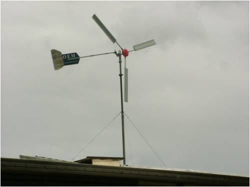

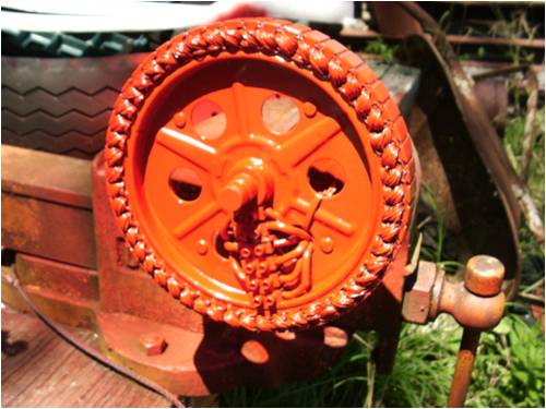

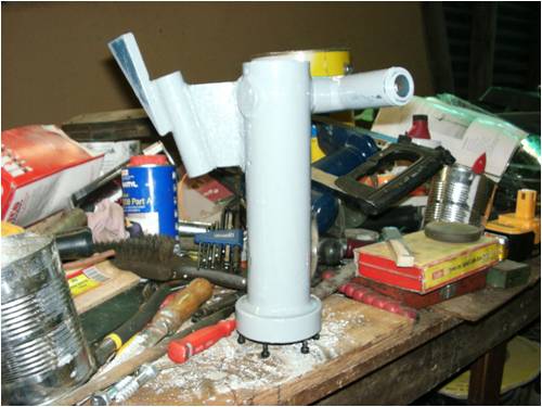

I am getting to the fun end of the project now, the next thing to do was to do the balance of the blades, they where set up as in the photo with the whole assembly carried on bearings with seal removed the grease washed out and lubricated with sewing machine oil, this allows for very low rotational drag, to do the final balancing.
The blades where balanced with paint added to the blades as required to bring them to the same weight. All this sounded very good and workable but balancing the assembly with the stator in there as well resulted in a slight miss balance due to the terminal block on the stator and the wiring being on one side of the stator. Unfortunately this has resulted in a slight vibration of the mill when its running, so another balance is needed in the near future.

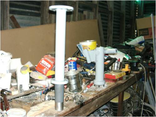

This is the mast head adapter, it has a flanged coupling to the top of the mast for ease of assembly, in the picture it is showing the two bearing seats, the lower bearing is a ball race thrust assembly to carry the weight and allow smooth rotation.
The upper bearing is a precision needle roller bearing to take the side thrust, it goes directly on the adapter shaft and has a sleeve on the outside to fit the machined surface inside the head adapter. This is a well engineered rotation system.

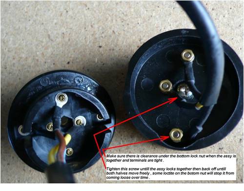

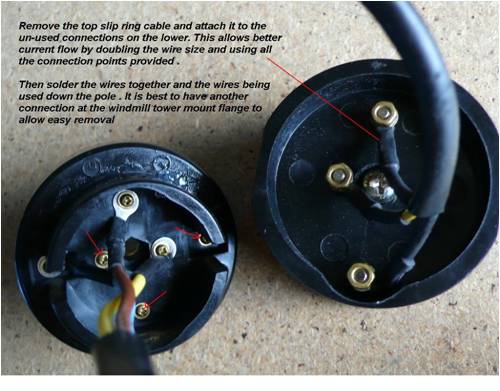

The wire comes up inside the mast and I clamped the mast wire inside the adapter flange, and terminated with a multi wire connector the same as the one in the stator, this allows the head to be disconnected without disturbing the wiring.

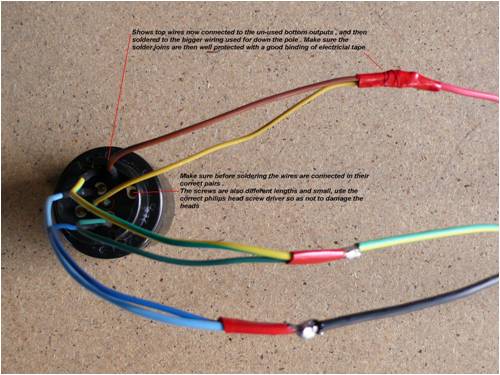

From this terminal there are two wires per phase going to the underside of the wire slip ring assembly.
The next photos are from Phills photo file, Thanks Phill.
I used spade terminal for the connectors as they are more substantial than a conventional connector, and they fitted in very nicely with a small trim on the edges to fit them in the slots, on the bottom there are two connectors per slip ring as the connection screws are small it allows two paths for the current from the slip ring. The upper connections use a spade terminal but with a yellow sleeve as this takes the 3mm wire coming from the alternator.
This is the head assembly that the alternator shaft is locked into, it also has the furling assembly and connects to the top of the slip ring assembly, The main shaft on the alternator goes into the mounting sleeve and is retained with two grub screws, these proved to be soft Chinese steel thats not worth a pie, I replaced these with two 3/8 UNC grade 8 bolts and nyloch nuts to lock them in place.
I drilled the hole right through the sleeve to allow the thicker wire to go out the back without doing the twist and turn to fit the wire internally, a cover was made out of a asparagus tin that was just the right diameter to fit to the top of the head fitting a hole in the side of the tin 3/8" was finished with a screw driver shank to remove the sharp edge and 2 layers of heat shrink was fitted to avoid the silicone wire abrasion. A terminal block is fitted under the cover, this is to allow the alternator to be removed without disturbing the head assembly and slip rings.

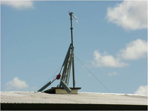

The tower was made of the top section of the kit tower to get the mounting flange sleeved to fit a 2" gal water pipe, a set of 3 attach points where welded at this point for bracing to the roof. The 2" pipe is clamped to the shed structure at 4 meters height and had a angle welded on the end thats bolted to the floor.
The wire down from the alternator is 2 - 3 wire extension 1.5mm power leads connected in parallel, it comes out a hole in the pipe at 3.6 meters up the pipe and thence to the electronics, Another story.
The alternator was fitted to the head assembly from the top of a step ladder tied to the tower for stability, I made a platform that sits over the ridge of the roof so its not as bad as it seems. Bit scary while doing it though.

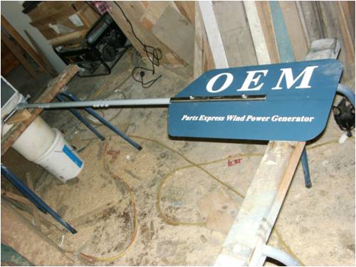

The tail proved to be a bit small so I fitted the extension in the above photo, this tracked better but is under revision in the near future, I am making a larger one to go higher and lower to equalize the spiraling effect of the wind stream. Another story if it works.
All the best
Bob

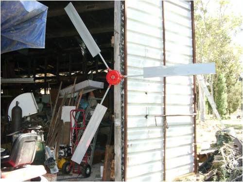

The tale of the tail

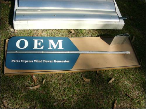

The original mill had smaller diameter blades 2.4 meter I think but my increasing the blades to 2.8 meter meant that the tail didn't have enough control of the blades and the mill wandered around in the wind aimlessly, Phill had supplied an extension kit for the tail boom the photo below is the original tail and boom.
After fitting the tail boom kit lengthily the boom around 600 mm I tried it and it was better but still slow to react to wind changes.
The next step was to shift the vane back by drilling out the rivets ans shifting it rearward by one rivet spacing, about 250 mm this was an improvement but still not happy with.
Phill knows best, in the end I fitted a bigger end on the vane as Phill had suggested and found the mill responded much better, and will now track wind down to .4 ms, this is very important for starting, as the mill needs to direct into what wind there is.
The mill will now start consistently at .7 ms and starts generating at 1.2 ms, this charges the capacitors so when the the wind increases its ready to go.
At this point in time the furling hasn't been tried as the wind is very light so cant report anything there.
The furling angles where reset as per Phills specifications, so hope that will work out OK, the furling bracket was cut off the head and raised for the boom to be in line with the shaft of the alternator, the main reason I did this was, I cut the bracket of the head shaft and didn't want to weld it back on where it was as it may have caused distortion in the tube near the top bearing and cause it to bind, Phill said I should have cut the furling pivot bush off and re welded it, but I felt this may have caused binding in the furling action, so I did it the hard way as I usually do.
I am considering a larger tail section in the future which will shorten the boom length a bit, but for the moment it is working and generating so will leave well enough alone, I found a steering damper of a motorbike that is fully adjustable and will fit that next time I have it down, this is to stop the tail whipping around and hitting the blades.
Next week I will do a block diagram of the electrics set up, at the moment it is a work in progress, and still waiting for some bits to turn up. With what I am using so far the magic smoke has stayed in, so it is so far so good.
All the best
Bob

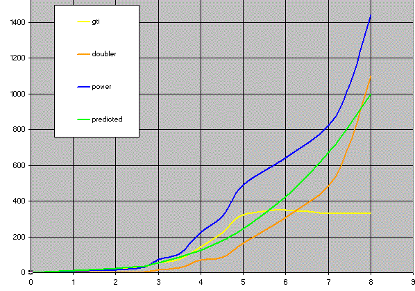

GWatPE
Joined: 01/09/2006
Posts: 2127
Posted: 01:43pm 11 Dec 2010
Hi Bob,
the windmill certainly appears to be making good power.
I have taken the liberty of plotting the data for you.
The graphs are according to the legend, and the X-axis is windspeed and the Y axis is Power.
I have included the predicted power from Allton's calculator.
It is interesting that the measured power is significantly greater than predicted from the windspeed. I think that there is still a problem with measured windspeed, but it is a good start. Windspeed is probably measuring 1m/s lower than it really is.
The GTI seems to be working. I think those without a grid, but RE battery, would get similar results running the alternator in star, with only main rectifiers and a cap doubler. A small reduction in top end max power may be evident, but the wind distribution and load usage patterns would determine if this was significant.
I think I can say a good result.
Gordon.
PS: The graphs show no signs of any change in output at the high power levels with windspeed. This indicates that furling is not close to being effective. The windmill potentially has the ability to make more current still. Take care as i^2R losses can take hold very quickly.

Greenbelt
Joined: 11/01/2009
Posts: 566
Posted: 09:57pm 11 Dec 2010
VK4AYQ;
HI Bob,
Again, Kudos to you and PHIL,
That extended blade design puts out the torque when the Gen.loads
up.
Gordon's power graph gives a good picture of the performance of
this mill. and if errors exist in your hurried calculations they could not be so great as to call this mill a failure.
According to Allton's Calc. you should get a "maximum 1000 Watts @ 24 KM.PH. wind speed
If you discounted 30% as an error in calc's you would still have 8 Watts more than allton Permits. I suspect that your errors are not that large. Good work Bob.
Hope you get that Logger soon. best to you always, ---Roe

The doubler passes 3 amps before the voltages equalize on the main rectifier, so that is working well, with the GTI disconnected it boosts a bit earlier due to the unloading of the alternator.
Also I think these blades are more efficient than the representation in Altons calculations, based on the comparison to the other mill these blades start much earlier, I am sitting watching the two mills now the new mill is doing 80 rpm and the old mill is just creeping.
Once again thanks for the chart.
All the best
Bob

Hi Greenbelt
Thanks for the encouragement, I am very pleased with the results so far but will have to reduce the furling speed to prevent lung cancer. The problem with the weather station record times makes it a indication rather than an absolute for wind speed, hope to have a logger going in January, that will stop the wind completely.I have a couple more things I want to try on the bottom end to salvage a bit more energy, but looking at Gordon's graph there isn't much in it to play with.
These blades are more efficient at low speeds than the design that Alton uses in his calculator, with a C/L of 2.4 as compared to his at 1.3, I think that is part of the story, and also they wont spin up as fast as his due to the increase of drag in the L/D ratio.

Hi All
Another storm front today 36 C stirred up a strong front that came through around 4 pm 20 + ms winds for half an hour once again pegged out the amp meter but I was more interested in watching the furling, or should I say lack thereof.
Watching the furling it would start to furl then the blades just pulled back into the wind and kept going, the tail was wagging like a dogs tail but no significant furling.
This indicated a lack of offset on the mill, in this case around 5 inches, apparently not enough for the bigger blades, the larger tail proposed will stabilize the tail somewhat,and the lower weight should bring in furling earlier, this may allow furling before the blades lock into the wind and are held there by gyroscopic forces that the furling cant overcome.
I will be aiming for a furl at 10 - 12 ms allowing full output of 1500 watts but not allowing the blades to accelerate to the point of having enough gyro forces to negate furling.
The electrical systems are working well so no issues there but are a bit overloaded with to much power, today over 2000 watts but no magic smoke. This indicates to me that if the control is established with the furling, the rest of the works is a real success.
