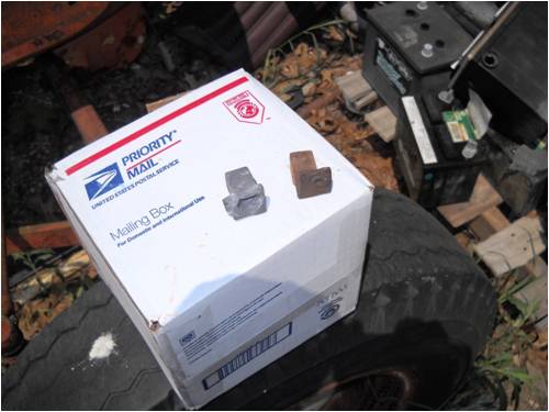

We are going too make a stab at the pictures.

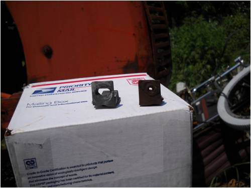

This picture shows a couple of the cell connector straps note the size of the contact spots,
This is another of the connector straps

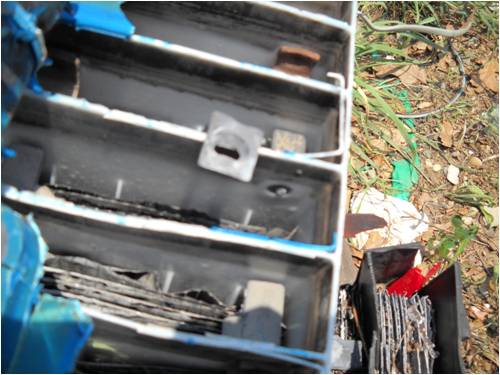

This picture below shows the connector strap and where it connected to the next cell over. looks like a 1/4 pin coming through the cell wall.
Notice the amount of contact area.
Each cell has two of these connector straps one + and a - .
I just laid the strap on the separator so you can see the comparison.

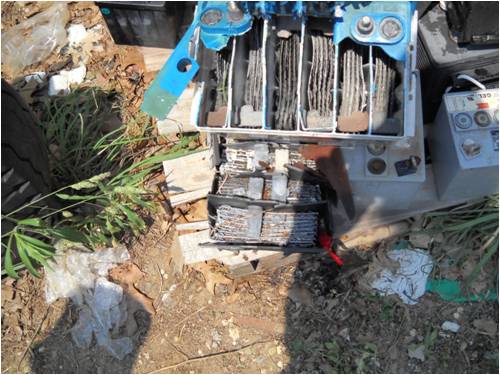

This picture below shows the inside of the battery and you can see some of the remaining connector straps.
The top battery is the one that expired last week the one it is setting on is the one out of my dozer and it blew (the one that blew up in my face!)
the whole top off the top one didn't blow it all off I had to help it some to get the pictures we wanted.

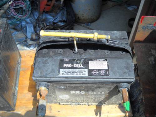

This next picture is of a car battery that I peeled the sticker off the top to expose the caps and my dry wall screw .
I made into a T handle to pull the caps.
Some times you can reuse the sticker to help reseal the caps,

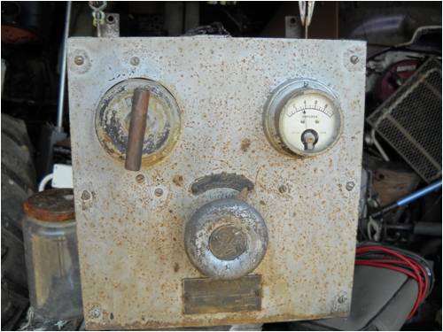

This is the last picture of the day and it is my old Tungar battery charger that used the old vacuum bulb rectifier and we updated it to solid state 70 amp rectifier.
this will charge up to 6 battery's at a time if you have enough connector straps.
We hope this helps out some of the new battery reclaimers.

I've dismantled one of my stouborn batteries, not by explosion, with a hand saw. I wanted to see for myself if I could locate the problems inside to get a better understanding of what I was dealing with. Sometimes you just have to do an awtopsi, post mortum in this case.
Those are some pretty interesting pictures in you'r posting.

Sometimes you have to waste one to find out what your up against and usually will pay a good dividend.

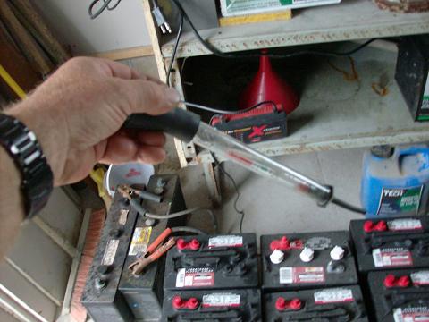

Another experiment for all to try is if you are working on reclaiming a battery and it gets wet looking on the top take VOM. and hook the neg to the neg then take the meter positive and run it around the top of the battery where it looks wet or dirty and see what readings you get. You'll be surprised and this can cause the explosion!
We may try and get a picture up of this also.Walmart has a battery cleaner detector that cleans thing up pretty good. you spray it on and let it foam up then rinse it off but BE SURE YOU HAVE THE CAPS ON AND THE CELLS SEALED.IF YOU GET IT IN THE CELL IT WILL NEUTRALISE THE ACID IN THAT CELL OR CELLS.
Hey Bob you got any battery's like in picture 3 and 4?

Id go back and give them a longer run on the desulfitator and check the specific gravity of each cell.keep at it until that gravity cheeks good on all cells.
You can get a tester at tsc or Walmarts that just uses little balls like some if the antifreeze testers when it floats all the bulbs you should be good.
