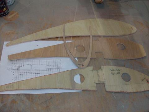

Make you'r self a good set of templets/patterns, and keep theses because you may be building a replacement wind sometime in the future.
Master pattern...used to make all other patterns, and usually has important info, measurements/angles ect.
...Calipers, I have one I made and use it as I form the profile of the leading edge.
...and your going to want to save that wing jigg too, so find some place to store all this.
Thats the basics of makeing you'r wing, first full set for me...next time I'll know what I'm doing...sorta anyway.

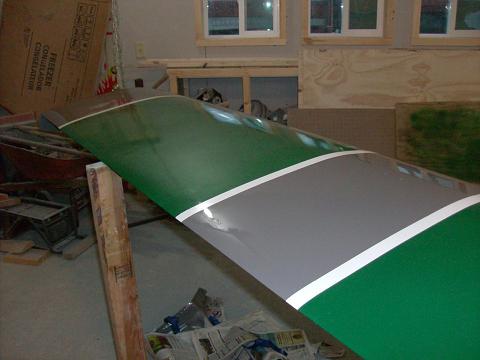

I had just enough fair weather today to paint the third wing, another storm rolling is as I speak.
You can see the air blower to the left of the picture...used it to draw air through the small wind tunnel. Use it to filter the air in the shop now, just pop on a furnace filter, works pretty good as long as I place it within 6 feet of where I'm sanding. (3-speed). I use the pleated 4 micron filters. Came off an old, large gas furnace, built the box out of left overs. Price was right, free.

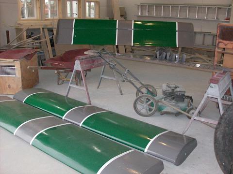

I thought I'd share this picture with you. I'm getting "the touch" back, been a few years since I've done any painting like this. This wing is the best yet, makes the first one look sick.
When ever you spray automotive paint products always have and wear an approved respirator with the correct filters. You don't want this stuff inside you'r lungs.

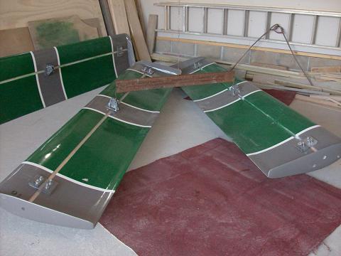

When balanceing my wings, I have them weighted to center gravity naturally at 8*, and balanced within 1 oz. tip to tip, and also balanced within 1 oz. between all three wings on total weight. I have'nt had the opportunity to test mount the first wing yet, still waiting for "calm wind".

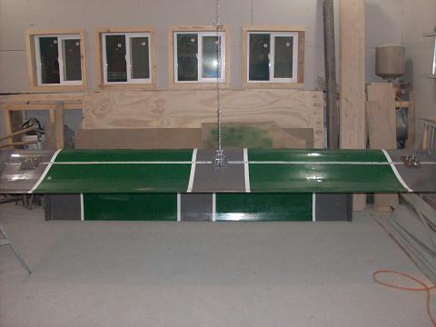

mac46
Joined: 07/02/2008
Posts: 412
Posted: 02:55am 04 May 2011
Here is a picture of the blades after tip to tip balanceing, I was referanceing this in the last post. Fiberglass and paint added more weight than I thought.
.....Mac46

mac46
Joined: 07/02/2008
Posts: 412
Posted: 11:17am 05 May 2011
Although I did weigh each wing with a digital platform scale, I also double checked their relitive weights by putting them on a balance beam. Incredibly, you can see the differance by adding or removeing a single 5/16ths. flat washer. Final balanceing is complete, with a weight of 53.4 pounds each.
Fiberglassing and paint added approx. 15 pounds to each wing...thats more than I thought it would, but still within reason.

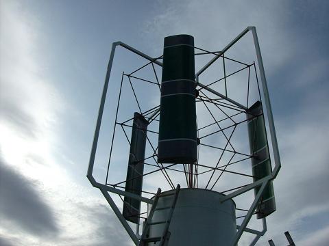

I had calm wind today,
As you can see, I have the baldes on.
I think I'll take a day off to recouperate.

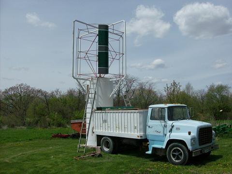

In this picture you can see that I used my old truck as a elevated platform to work off of. This worked real well, a few 2x12 planks with a sheet of plywood made a good solid base to set my step ladder. I threw a rope up over the top frame and hoisted each wing up in place. "Ever have a situation where you need to be in two places at once?" Things were alittle tricky at times, especially when a gust of wind came up. All went according to the plan, (x3). Plan you'r work, - work you'r plan.
The wings are tied off and stationary at this time as I have several things to check out with the entire machine. It may be a few days before I allow it to run free. It is pulling at the teathers wanting to go.
