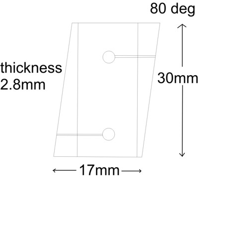

G'day Matt, I don't know if normal rivets will do the trick as they require the body to pass through the material being used. The grooved was the only one I found that didn't need this. It appears to act like a mini dyna bolt.
I tried to tap a thread in a stator finger and it's a bit messy due to the laminations.
I rang coventry fasteners and they sell a countersunk self tapper, that may be an option as well. I'll go down and buy a few of each on Sat and test them out.

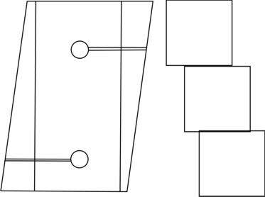

Hey guys, while I'm waiting to fix these plates on I thought I'd start with the neo rotor.
I can have three lines of neo's with different pattern options.
#1 have them all vertically aligned in three rows.
#2 have a stagger reversed to the slant of the T plates.
I like the second one.Perhaps 1.5mm stagger between each row, total of 3mm added sweep
Any thoughts on that?
I don't think it will work with the T plates as the gaps are so small but I still think this is a good idea, if airx use it there must be some merit in the principal.

G' day Highlander, If you can manage the T plates in the end, maybe the vertical arrangement of magnets would be OK. But as Gizmo has recently discovered, one of the reasons for the new F&P having reduced cogging is that they have arranged their magnets like a "greater than" or "less than" sign, or maybe you could describe it as a V turned through 90 degrees. I would guess that neos are so strong that cogging could rear its head again, like it did with brucedownunder2's adventurous rotor. (incidentally brucedownunder2, have you been game enough to drive that rotor up with a big drill to measure volts and amps out?) So I would tend towards the sideways V for neos, but it's a suck it and see thing, like much of the work going on in this area!

Hey Megawatt, yeah I saw that but those magnets interact with a strait pole 90 deg to rotational travel. With the slanted T I thought an arrow or a strait line may concentrate the field in one area ie cogg. The opposite stagger may help a little, I'm not really that sure or worried about it. Just something to tinker with really. I'll get there eventually.
I had a go with plain old self tapping counter sunk screws and they worked fine. They survived quite a few blows with a heavy hammer without coming loose.
I'll start again with a fresh stator on the weekend

Dwyer, thanks for the offer to test mate.
I think the countersunk self tappers and loctite glue combination will be ok.
But if you want to try it the measurements are:
(hole size 4mm)
It might be a good idea to use exactly the same material I was using to get an exact replication of the test.
Can I mail you a few plates? Email link in profile if you want to send your details.
No need to bother really I think glue & screw will be fine.

I started with the fresh stator today, I had to cut new plates so the screw holes were perfectly centred.
I bought some 406 locktite glue to give an added bond.
