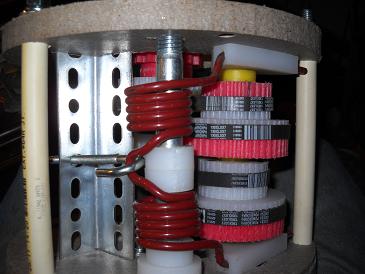

Hi Govertical,
Another optical illussion,the belts already look like they are mis-aligned and running at angles.I feel that implementing perry's suggestion will increase belt life considerably and having them aligned true reduces side shedding and negates belt runoff.Allowing a larger surface area allows the belts to stretch and retract randomly placing uneven forces on the tensioner.Defeating the purpose of keeping the noise down and even/consistant belt tension.My comments are only conjecture of course,I'll happily be proven wrong!Cheers Rastus

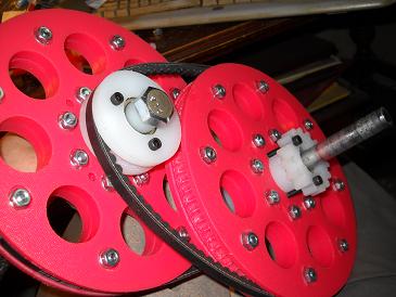

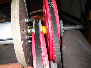

Greetings, project update:
Timing belts and pulleys are installed on a test rig. Because the pulleys are made using two pieces I was able to bevel each piece toward the center of the pulley. This forces the belts to track toward the center of the pulley so a lip is not required. I have to find the correct tool to bend the spring into the correct shape. This a first attempt but it appears to be working. The spring pulls on the top and bottom of the movable shaft and all belts have tension. Again this is a experiment and a learning experience, I do not know how long the belts will last. The next step is to mount it on the PMA and perform a road test. The current configuration is a 1 : 6 ratio.

Posted: 02:55pm 25 Sep 2011
If you mean that the center of each pulley has a slightly larger diameter by "bevel each piece toward the center of the pulley" then this would work for the old fashioned flat belts.
Toothed timing belts are constructed to run on a flat pulley, I'm not sure if what you did might also shorten their life as the load is taken at the center of the belt now.
My suggestion is to bite the bullet and fit shoulder disks, all those commercial toothed pulley makers surely could not be wrong .

Hi, the center of each pulley set is a slightly smaller diameter. Thanks for the suggestion if the current configuration becomes a problem I can add shoulders to the pulleys. The belts are only installed on a test rig and I am able to spin test the current configuration manually. When the shafts are parallel the belts track to the center of the pulleys. The belts are very quiet and the units spins very easily compared to the gears that I was trying use. I am surprised how well the timing belts grip the pulleys. I hope to be able to perform a road test within the next week. Enjoy the day.

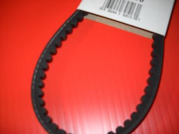

Greetings, the 3/8 timing belt is just to small for the intended application. Even under tension the belts would skip the pulleys at higher RPM’s. I was able to find larger tooth V belts at the local auto parts store. They are a larger diameter with larger teeth. This should resolve the problem. I have to fabricate new pulley. Enjoy the day.

  govertical said   Greetings, the 3/8 timing belt is just to small for the intended application. Even under tension the belts would skip the pulleys at higher RPM’s. I was able to find larger tooth V belts at the local auto parts store. They are a larger diameter with larger teeth. This should resolve the problem. I have to fabricate new pulley. Enjoy the day.
That belt looks very much like an ordinary 'Vee' belt used on alternators. It is not meant to run on a toothed hub at all, just in a Vee groove. I think the 'teeth' allow the belt to flex more reliably on small pulleys.
You would do much better to look for automotive flat belts with either teeth or several longitudinal Vee grooves on the inside. These are designed to transmit high power loads. Even some Harley Davidson bikes use a toothed belt drive to the rear wheel.

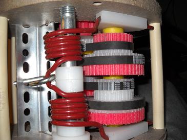

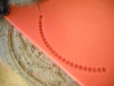

Posted: 07:15pm 02 Oct 2011

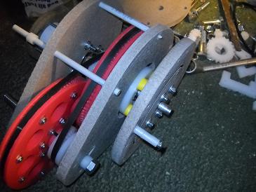

Greetings, milling notched pulleys. It will be interesting to see how long the belts will last. Fabricating pulleys using two pieces, each side will have a lip to contain belts. Current ratio is 1: 7. Enjoy the day.

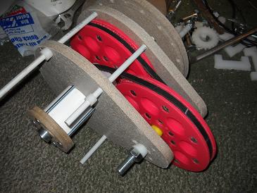

govertical
Joined: 11/12/2008
Posts: 383

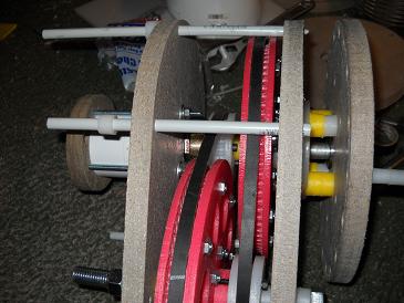

Posted: 01:51am 05 Oct 2011

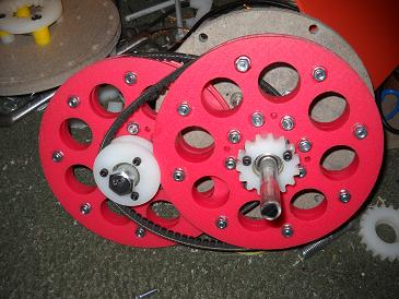

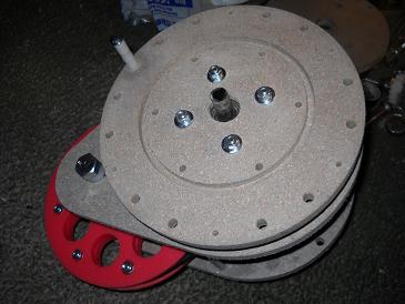

Greetings, just some photos of the 1: 7 synchronous belt drive transmission on the test fixture. I have to add spring loaded bolts to apply tension to the belt pulleys on the movable shaft.

govertical
Joined: 11/12/2008
Posts: 383

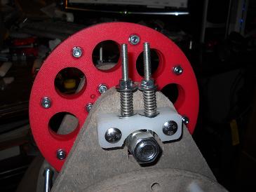

Posted: 10:32pm 05 Oct 2011
Greetings, I completed the spring loaded bolt mounts to maintain a constant tension on the belts. The springs pulsates when I spin the rotor. This is showing that the pulleys are not prefect circles or the belt is riding up on the pulley teeth or a combination of both. This is a problem that will have to be resolved. It does work well enough for a road test. Comments welcome.
just because your a GURU or forum administer does not mean your always correct :)
Posted: 12:11pm 06 Oct 2011
Movable shafts are fine, IMO, to preset the belt tension. The moving part is then locked securely.
Having the shaft moving all the time against a spring is, IMO, not a good idea.
Its heaps better to have individual spring loaded idle roller tensioners on each belt.
I'm speaking from what I have observed during my working live on successful machinery.
It may be wise to imitate what others have found out the hard way long ago instead of trying to reinvent the wheel so to speak.
But I can see you are having lots of fun and will no doubt learn a lot along the way to make the perfect wind generator RPM increasing gear set up.
govertical
Joined: 11/12/2008
Posts: 383
Posted: 05:55pm 06 Oct 2011
Hi, earlier designs did not have the space to place a idler pulley on the side because there were just to many belts. I saw the spring idea used on early turn of the century machinery and thought I would give it a try. Using just two belts there is now enough room for the idler pulleys to be mounted on the side. It is a better idea and will be included in the next modification. Thank you. I have to round off the teeth on the pulleys because the belt is riding out of the grooves and causing a pulsation during rotation. After the modifications the problems should be resolved. Thank again and enjoy the day.

Rastus
Joined: 29/10/2010
Posts: 301
Posted: 07:58am 07 Oct 2011
Hi Govertical,
There seems to be to many springs to compound the proplem.Remove the mount bolt springs and bolt up solid against the tyne spring tension.I hope that will stop the bouncing you are getting.Cheers Rastus

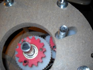

Posted: 01:09pm 07 Oct 2011

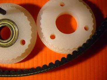

Hi, when I made the pulleys I did not have the tooth pitch and tooth spacing of the belt that I am using. I have to make new pulleys with correct size teeth. I am searching for the design specs for a Dayco 10A0775 automotive v-belt. Once the pulley teeth are in the correct place the problem will be solved. I emailed the company but if anyone knows how I can find the design specs for the belt please let me know.

Posted: 03:35pm 07 Oct 2011

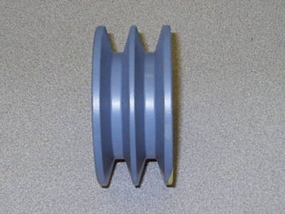

i would be very surprised if dayco responds at all. It is an automotive V-belt not a toothed belt. the cogs are not designed to touch anything just flex. There is no load bearing structure inside the "teeth" the belt will not sit upright under tension and with a driven load the cogs will just tear off.
the belt is designed to be driven by its sides at the line you can see the fibre spine by a pulley like this.
if you have ever heard an old car with a badly squealing fan belt, air-con belt or power steering belt it is usually because the VEE in the pulley is worn to a U shape and the belt is bottoming out in the pulley, no amount of belt tension will help this.
V pulleys are not that hard to build if you can chamfer the V belt angle on 2 plates, they can be bolted together with spacers and shims to get the correct width.You could probably do it with your current pulleys. Could you do the little pulleys first and try it? they are the ones that get hammered.

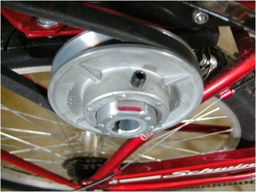

Posted: 07:17am 09 Oct 2011
Govertical
these can be quite effective for a bit of prototyping
Its called a variable pitch pulley, if you live in a drier region they will be on your local hardware shop's shelf for about $8, $12 if you want one with a key-way. It is used for adjusting the load on the electric motor of an evaporative air conditioner.
Just back off the allen key, wind one sheave in or out on the thread, line the allen key up with the flat and re-tighten.
With an "A" section belt it adjusts from 2 inch to 3 inch diameter, about 30 % speed change. They are capable of 2 horsepower. It pays to lube the thread with a graphite grease so it adjusts easily but even then the spring loaded tensioners may cause colourfull language
regards yahoo

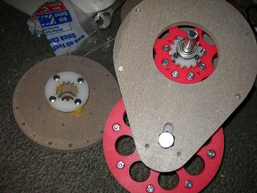

govertical
Joined: 11/12/2008
Posts: 383

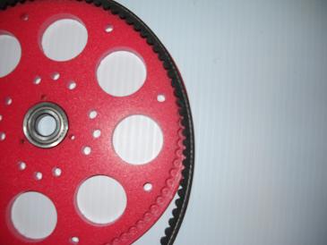

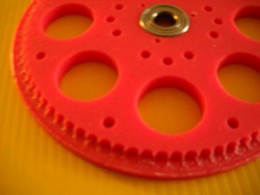

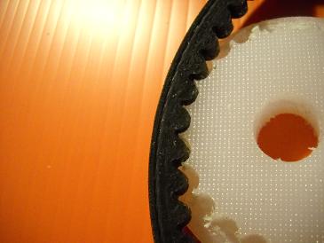

Posted: 12:32am 10 Oct 2011

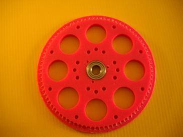

Hi, the pulley teeth are now more likes waves. Thank you for all the help I am receiving. Basically it shows I can fabricate the needed pulleys. Because of the resizing of the pulleys the ratio is now 1: 5

Rastus
Joined: 29/10/2010
Posts: 301
Posted: 11:48am 10 Oct 2011
Hi Govertical,
You've manufactured another quality component.How did you decide on the pitch of the "teeth".The picture shows the belt partially compressed around the gear.I think the belt will ride in and out of profile at different stages of drive and could leave you with the problem that prompted this alteration.I hope you'll accept my comments as observations not criticism.To my knowledge the belts are toothed for durability by reducing the repetitive compression (around the pulleys) and exspansion (straightening out) in opperation.Cheers Rastus
