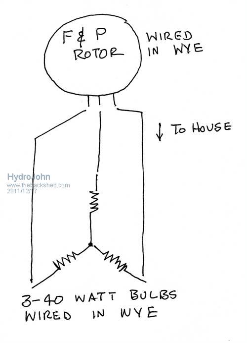

Hello Friends,
[quote=Warpspeed]I assumed you were feeding three phases down three wires to your home, as that is the most efficient method of transmission, and measuring phase to phase, as there will be no neutral wire with this delta connection.[/quote]
Just so I understand everything, I am sending a diagram of the way I have the wires connected to the 3 -40 watt bulbs. I think they are connected in Wye and not delta. I'm not sure if I have things hooked up right, but I think so. Also a picture of my unaltered 60 F&P rotor. There are 36 coils total with 12 in each phase. I think the 12 coils in each phase are connected in series and it looks like one terminal of each phase is connected to a common point and the other end of each phase exits the rotor to my house. Would this mean that the rotor is wired in Wye? The voltage reading I took was across 2 of the wires coming out of the rotor and not across the 40 watt bulbs.

Posted: 11:14pm 16 Dec 2011
That is all exactly as I expected.
The F&P must be connected in wye, to eliminate any circulating harmonic currents in the windings, car alternators are wired the exact same way, for the same reason.
To turn the 211 volts phase to phase voltage into 290 volts dc, you require six diodes, assuming that is what you wish to do.

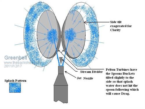

FROM PAGE 4,
Posted: 14 December 2011 at 6:25am | IP Logged Report Post Quote Hydro John
Hello Friends,
Greenbelt wrote:
The Jet stream from the Nozzle may need to be a bit lower down ( nearer to a tangent to the turbine cups) maybe down 3/8", I say this because I have read various documents about the design of Pelton wheels and the principal of energy transfer from water to wheel,
Hydro John, Wrote;
( I have tried many different positions and the one pictured below seems to give the best results.)
It is possibly causing some Drag when it is lowered because the splash water at 180 Deg. return may be hitting the Bucket behind it tending to slow it.
Not Picking your work apart you are already showing positive results, just passing a few things on that I've picked up over a long time.
This drawing will show how this problem was solved by others who Worked on these things. ---------
Cheers, Roe

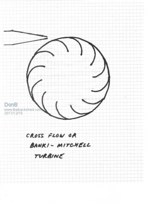

Hi John
I gather that you are having to rebuild your Pelton wheel – presumably because it did not stand up well in service. Maybe you should consider building a cross-flow or Banki-Mitchell wheel instead, as I think one of the earlier posts suggested.
A crossflow wheel would be really simple to build. All you need are two end plates, and a number of quarter pipe sections. A typical section is shown in the attached sketch. The only things to note are that the inner ends of the pipe sections should align with radials from the centre, and the outer ends should be more or less be a tangent to the diameter of the end plate diameter. The runner edges do need to be smooth though for best effect.
I am not sure of how many runners to suggest. It is probably best to draw a wheel up full size, and see how many sections of the pipe that you have seem to make a good fit
Note that the nozzle tip, which is directed at the top of the wheel, is rectangular in cross section. These type of nozzles would be easy to make, being just a piece of pipe with the end flattened to a slit, although a long taper would be less lossy than a short one.
The cross flow turbine works in two stages. At the top, the spray velocity is turned through 90 degrees, and exits towards the centre. The spray then flows towards the bottom of the wheel, and exits via runners at the bottom, where the flow is turned another 90 degrees, imparting further energy to the wheel as it departs. Having a shaft in the centre of the wheel probably disrupts the spray flow and, if the wheel is sufficiently robust, it should be removed.
When running at optimum speed (ie runners at half nozzle velocity), the water should virtually drop out of the wheel, with little, or no, horizontal component.
The runners can be any practical length, and this can give you extra versatility. The wheel needs to be wider than the (main) nozzle to account for sideways spread anyway, but there is nothing to stop it being wide enough to accommodate, say, 3 nozzles, so that you can use more or less water, depending on the available water supply. One of the advantages of a cross flow turbine is that it can accommodate a wide range of flow variations (and hence power outputs) with little change in speed or efficiency.
You are probably well on the way to upgrading your Pelton wheel by now, but I still feel that this alternative, being simple to make, might be a better focus for your efforts.

herbnz
Joined: 18/02/2007
Posts: 258
Posted: 11:20pm 18 Dec 2011
Hi
Dc high voltage is the way to go. All my attempts to use the Ac 3 phase have created losses due to the high frequency I have posted before tests on this connot find now tho.
Warpspeed We have visited the area of dc dc converters before a few years OK they got linked to Mppt and the subject was shutdown.
I have in isolation carried on working here with old pc supplies and now have a commercial solar MPPT Tristar that allows 150v max this works a treat I have had it on both wind solar and hydro.
your find of a battery charger is good value as this Tristar cost $700, there is a fully setup commercial unit that does all three Midnite Classic available up to 250v input but cost is $1200 +.
Ok tho one thing you must remember is as the batteries become charged and load is backed off the input voltage will go up to double ( in a well designed hydro) a voltage clamping cct is needed before the charger to dump load in this case. I have build various ccts out junk round here but I am sure you could come up with a better design.
Don
I have here in a text book a detailed design of a banki with all measurements an formulas I have also seen on the Net
but cannot find now
but here is a link to a site that has some detail
http://www.cd3wd.com/CD3WD_40/VITA/BANKITUR/EN/BANKITUR.HTM

Posted: 11:23pm 18 Dec 2011
Hi Don.
Thanks for the info, I might go for the Banki-Mitchell wheel in my own set up.
  Quote  I find it very frustrating that you can't simply attach or embed a sketch in a Word document and upload the lot. I will try again to add the sketch.
Unfortunately thats the nature of html ( web ) pages, incompatible with Word formated pages. But html does have cross platform compatibility and small file size, so they load faster and everyone can see it. Designed that way.

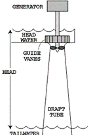

yahoo2
Joined: 05/04/2011
Posts: 1166
Posted: 12:22am 19 Dec 2011
I have wondered myself why a low head propeller style generator would not be very practical for smaller systems
credit these are from microhydropower.com
I can think of a number of ways to design a setup with a 2 or 3 metre head with off the shelf channel irrigation equipment or perhaps using piping down the river bank and then out a small jetty.
