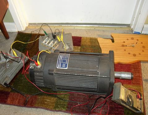

This one starts to charge a 12 volt battery at 150 rpm and I see usually
around 5-10 amps when the wind is blowing with a 6' hand carved prop on it.
I do see more than 30 amps on occasion, I have the furling
set up at 30 amps and 25mph winds to be safe for now.
I feel I could push it more. I looked up this motors specs
and it's max amps for the winding is 80 amps. I just need a
better tower for it and a larger prop.
This is my big unit I have on my main tower now.
It charges a 12 volt battery at 60 rpm, too slow for a 12'prop.
So I rewired my battery bank and bought a 24 volt inverter
and set up a 1500 watt dump load. Now it charges the 24 volt
bank at 120 rpm. I'm putting a larger prop on it as soon as
I can get around to it.
I expect to get 3000 watts out of it. 100 amps @30 volts.
Its name plate says 300 volt 80 amps and 1500 rpm.
I found the data sheet and its max amps is 320 amps.
I just don't need all that power! This is a 20kw motor
I got off ebay brand new for $50 and $50 for shipping.
I just know what to look for.

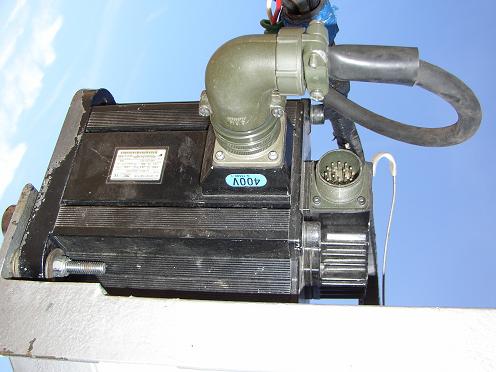

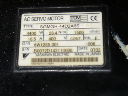

Here is a 400 volt 4.5kw motor @1500 rpm
It starts to charge my 24 volt bank @ 97 rpm.
I'm getting 38 amps @ around 25 mph @30 volts
a little over 1000 watts.
I have about a dozen servo motors and they are all different.
The trick is to match the blades to the motor.
I can't even count all the props I have carved.
So far 12' has been my biggest. I'm working on a larger
one for the 20kw motor. I just need to get another
tower up. That's where the real work is.

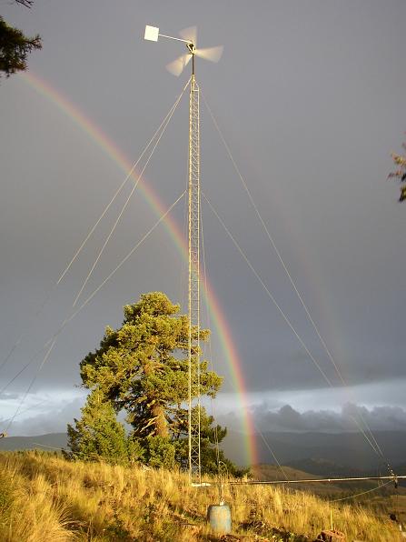

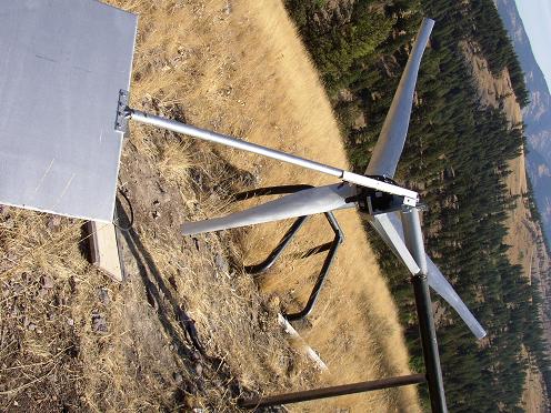

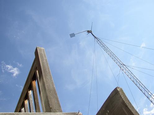

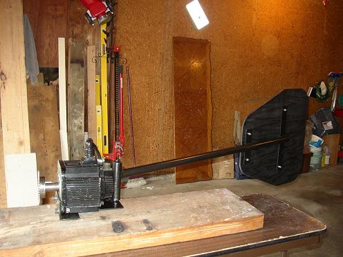

Here is the big one after I got the 70' tower done.
And the 8' & 10' props on these two machines.
I've seen 80 amps @30 volts so far out of the big one
with the 10' prop on it. It's a very well behaved machine.
The picture above is when it is furling and still putting
out massive power. (around 2000 watts) My tower is a Rohn 45G.
It will handle a Bergy excel 26' prop. I'm not going to go
that big but ya never know? Edited by 97fishmt 2012-01-16

Posted: 10:52pm 14 Jan 2012
Here is the tag on the 400 volt motor.
It measures 8" x 8"x 10"
This is why I look for the newer ones.
They are only about 30 pounds for a
1000 watt wind turbine.
Good hunting. Edited by 97fishmt 2012-01-16

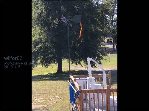

I put together a little 2.2a, 3000rpm Sanyo Denki servo motor, with a
4'6"(dia) PVC prop. I have this in series with a 1/4hp ECM motor
(ghurd modified, of course) to produce low wind speed voltages
(12vdc charging). We don't get any decent wind except in the winter months
here in Alabama. But both of these in series, does the trick. I also have
360w of solar on a tracker panel for back up. That does really good, with the
gennies for cloudy days.
It's all 97fishmt's fault!!! He made me do it.... I also borrowed his idea
for the universal mount and its worked super great. Thank you 97fishmt,
"You da Man!!"
I'm starting to put together an OMRON servo motor, 600w, 3000rpm, 240vac, with
some 5' PVC blades. Really anxious to see what it will put out when it hits a
decent wind. I hate these addictions we have!!!
Again, thanks "97fishmt".....
