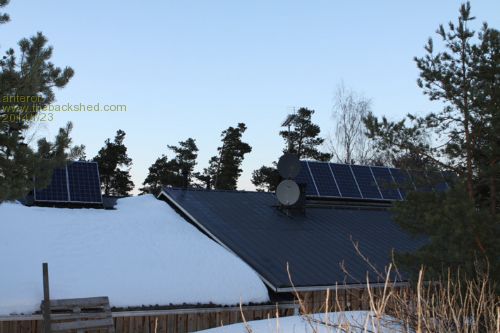

I have Schot Solar Perform 250W solar panels 11 units in my roof.
They really perform.
When I started this I wanted to have sun-tracking system, but wind conditions here
are very rough and 11 units in the roof, mission impossible.(picture)
My only option was to mount them on the roof, because the elevation of the terrain.
Now they are all at a steep angle, because snow falls from them very easily and
late in the autumn and early in the spring, the best angle is deep..
Short time sunlight and sun is shining from very low angle.
WE had winter solstice at 22.12-13 and now day is getting longer and sun
is getting higher and higher day after day.
Now we have temperature -26C that is -14,8 Fahrenheit.
There is now snow in my roof (picture is not from this winter) which acts as little mirrors and I get a lot of scattered radiation and also from surrounding terrain which is covered with snow.
The atmosphere is also particularly dry and clean, when there is so cold.
The amount of light is at maximum and very bright.
No wonder there is so called snow blindness among helicopter pilots
and hikers in snowy terrain with full sunshine.
I have got record high readings from my solar panels.
Also panels give their max power readings(and more with with snow blindnes..) without any heat loss, when weather is so cold.
Even when the sun is shining just a short time 4-5 hours a day now, I can get my batteries charged.
In the summertime I get 85-90 Amps from my panels, now I get 105-135amps,
with 24V system.
I have got 10-25Kwh daily now, when there is so cold and high pressure,
with full sunlight with just few hours.

  Antero said  When I started this I wanted to have sun-tracking system, but wind conditions here
are very rough
My original RAPS system was/is trackable and I found I got about 20% more power by sun tracking. That was fine when panels were at best, poly silicon and expensive. Now mono high efficiency panels are relatively cheap so it is easier to fit an extra 20% of panels and have them fixed. No tracking mechanism to break or electronics to fail (lightning strikes etc.)
I guess the snow would act like a reflector. When I first started, I used to prop up a sheet of shiny galvanized steel to reflect the morning light onto the panel before the normal sunshine got that far. It made quite a few amps difference but was just another "wind vane" to try and tie down. Now I have another roof mounted mono system connected as grid connect to my battery inverter "grid" Even on cloudy days my batteries still charge. And if we are lucky enough, the wind blows occasionally and our little OEM 500watt unit kicks in. What more could I want?
