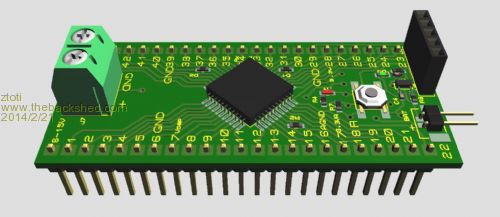

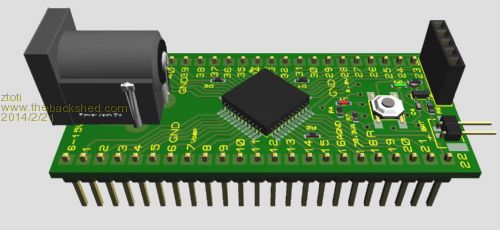

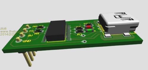

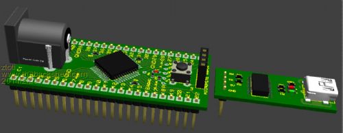

Posted: 10:42am 20 Feb 2014
Hello,
There is my idea for micromite.
The microcontrolers I use for hardware design and I was so happy with micromite idea.
Anyway, in my case USB/serial converter I use just for programming and debugging and when job is done I don't need it any more. That is a reason why I maked 2 PCBs: Micromite and USB board. Another thing, for many projects I need 12-15V DC for relay, motors...so this is perfect place for step down converter to provide 3.3V on output and input of 12V to drive some load.
This Micromite version will works with 5-15V on DC jack or 5v from USB/serial converter as well.
I'm happy to share my version with this great community.
https://dl.dropboxusercontent.com/u/42611861/MICROMITE.pdf
https://dl.dropboxusercontent.com/u/42611861/Micromite44PIN% 20-%20CADCAM.ZIP
https://dl.dropboxusercontent.com/u/42611861/MICROMITE_USB%2 0-%20CADCAM.ZIPEdited by ztoti 2014-02-21

Ztoti,
Very good idea to keep Micromite and usb adapter boards separate.
Once Micromite is programmed and deployed, there is no need for usb adapter.
Couple of suggestions:
- try to make USB adapter pinouts same/compatible with the cheap ebay etc. adapters.
3.3v,5v,Txd,Rxd,Gnd.
http://www.ebay.com.au/itm/USB-To-RS232-TTL-Auto-Converter-M odule-Converter-Adapter-For-Arduino-S9-E0Xc-/310807648933?pt =AU_CablesConnectors&hash=item485d945aa5&_uhb=1
- Provide an option for 2 pin PCB screw terminal connector for power connection.
Basically provide pads/mounting holes next to power jack, so that either can be used.
http://www.ebay.com/itm/50x2way-2Pin-Screw-Terminal-Block-Co nnector-5mm-Pitch-Panel-PCB-Mount-K2301-oo-/390733924938?pt= LH_DefaultDomain_0&hash=item5af98e8a4a
- Also consider a Li-Ion battery connector with on board charger for portable applications, Micromite has provision to sleep/wake to conserve power.
To help you take this further I would be interested in purchasing a large number of Micromite PCB's, subject to reasonable pricing.

ztoti
Joined: 27/10/2011
Posts: 65
Posted: 03:09pm 20 Feb 2014
Hi all,
I said this is my vision of Micromite, what I need to do my pcb for my project.
If somebody like it, this is free to download.
JohnL thanks for suggestion, I already start to make a new version with Li-ion connector and charger .
About USB/serial adapter, I made it to be compatible with Parallax/Propeller and with Micromite but I'll make a new version.
Zoran

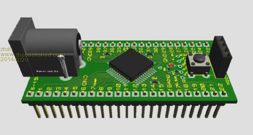

Posted: 06:31pm 20 Feb 2014
Hello,
I added to the PCB some improvements:
Li-Ion charger, 5 pin connector for USB/serial, Li-Ion connector and I made 2 versions, with DC Jack and with terminal block.
Tomorrow I will update a new version of USB/serial with 5 pins and the gerber files.
Sorry JohnL, no room for ULN2803, this version has to be small DIP package.
Zoran
https://dl.dropboxusercontent.com/u/42611861/MICROMITE3D_1.p df
https://dl.dropboxusercontent.com/u/42611861/MICROMITE3D_2.p df
ps. If any problem with DropBox, please check file extension ".pdf" not ".p df"
