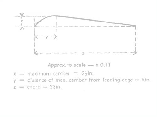

Just had a quick read of roger miller's book
This caught my eye on dementions
He writes
"The width of the blades must equal the radius of revolution of their central vertical axis about the fixed shaft. The height of the blades should not be less than their width"
Still reading

good to see you have the book turnymf
this bit has lost me.
"The width of the blades must equal the radius of revolution of their central vertical axis about the fixed shaft"
the second part I get lol.

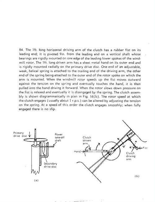

He also wanted to use a centrifigal clutch to apply the load depending on rpm

[quote]"The width of the blades must equal the radius of revolution of their central vertical axis about the fixed shaft" [/quote]
To me this says if your blade is 23" (cord) than the blade will be mounted at 11.5" central to the shaft at a radius of 23" to the face of the blade.
He means the radius is measured to the central point of the blade not to the tips.
The camber is what makes the difference in balance to make it spin then.
Pete.

"To me this says if your blade is 23" (cord) than the blade will be mounted at 11.5" central to the shaft at a radius of 23" to the face of the blade.
He means the radius is measured to the central point of the blade not to the tips"
Exactly
The camber adds torque according to Miller

ok miller enthusiasts, what do you reckon about the camber? is that going to help starting and efficiency? it looks like it should.

I can't help thinking a curved camber would be better than a straight one

It would be nice to have the f&p hub move up and down on the stator with rpm, like a clutch
If the rpm of the miller falls too low then it won't get in it's power band, won't fly so to speak
I have this problem with my lenz
Here is Miller's idea from his book

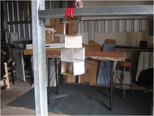

I made a test model miller. 27cmx36cm panels with adjustable camber and panel radius spacing.
using a pedistal fan about a metre away [very unscientific I realise] I got these results.
panel radius. rpm
26cm 72
30cm 66
35cm 60
40cm 51
Adjusting the camber either way made no difference at all
for rpm or starting.Increasing the camber to more than in turnymf's diagram decreases rpm. The panel radius also made little difference to starting.I didn't take any torque/camber measurements.
I think I will make my next miller without camber and make the panel radius about the same as the panel width.
cheers clarence
Edited by clarence 2010-03-12

Got any pics?
Having some sort of camber would be advantagious
The spacing / chord seems key, I can't get it out of my head that the back wing is working a little off the wake of the front wing

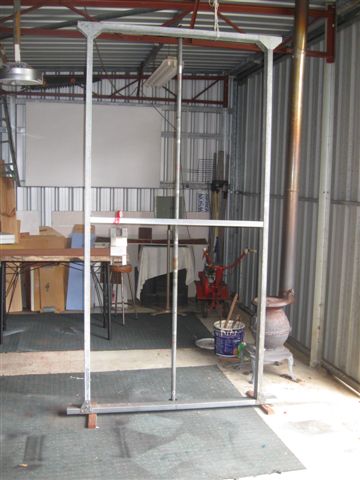

Posted: 03:43am 16 May 2010
Hey Clarence, how's your mill going?
I haven't progressed very far
I do have the frame done, and have worked out the vane configuration
Just have to decide on the vane( 300mm x 600mm) material
It's not to Miller's or Ron's spec, more to make the 4 tier easier to build
and not get too tall
cheers
