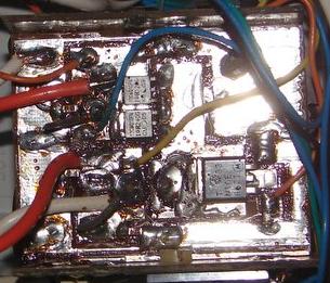

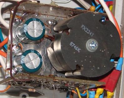

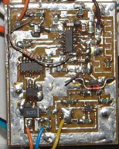

I have attached some photos. I have described how the cct works in previous posts.
pic 1...mill in operate mode, red light ON means caution when working on mill.
pic 2...mill in brake mode. green light ON means safe to work on mill.
pic 3...cct includes control 12v supply, modulator and fixed low end current shunt.
pic 4...cct includes swithing transistor and steering diodes and bypass caps.
pic 5...topside of pic3 showing input and output main filter caps and pot core inductor.
pic 6...cct includes voltage controlled shunt and mill overvoltage detection and protection cct.
I think you can see that the construction should not be breadboarded. each of the cct boards require screening with an earth plane to reduce coupling that causes detrimental feedback.

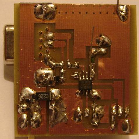

Have revised the code and made a simple test cct. the picaxe micro code posted produced glitches in PWM output. too many decisions had to be made. I have simplified the code and with only 11 lines of code within the control loop I have a glitch free output. The full span response is quite slow, about 2 seconds. real life testing will see if it can meet the task. Oscillations may occur as the cct responds to the changing wind. In comparison the analogue version can respond in < 2ms.
This is a pic of the test cct. This includes micro, regulated power supply, 6V-35V in, and on board serial programming port. the mill cut in and overvoltage can be real time simulated as well as the measured current and a visual indication of the output PWM signal.
The picaxe PC simulator and debug commands cannot respond fast enough.
