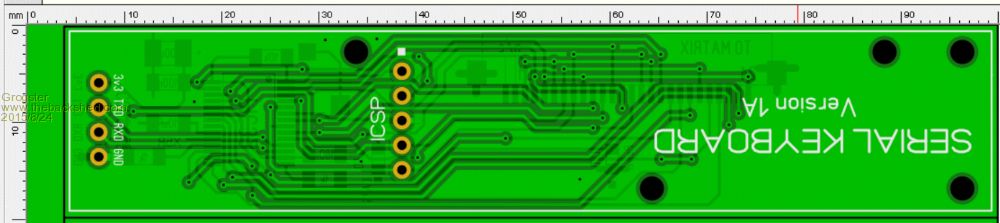

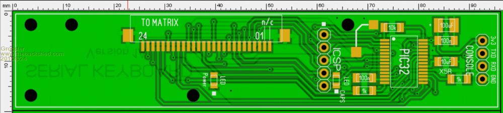

Posts: 10044
Posted: 12:54am 24 Aug 2015
Crafty idea using the 4017 counter.
Here is my version:
TOP LAYER:
BOTTOM LAYER:
This board is designed to directly replace the existing Bluetooth board.
Remove the securing screws and FPC cable, plop this board in it's place, and replace the FPC cable and screws. This board will then output plain serial for any key pressed at 19k2 baud.
This one is not near as fancy as your one TZA, but it is a start.
3v3 supply from the host system, as my concept is designed to work in close proximity to the host, rather then on a big long cable, so one meter or so is all the cable I have allowed for.
That, and I was too pressed for space to fit a 3v3 regulator!
I could get the reg in there, but there is no real-estate left for routing tracks!

I am not perfectly happy with this little blue keyboard but can use it to test a matrix. I need something that can be used with lots of keypads/keyboards als long as they have a matrix of 9x8 or smaller. The pic 1459 is such a versatile chip that i choose it to base all my little modules on. Concentrating on a single pic will make it easier to understand all its details. Great for 'close to the metal' and when speed is needed. For everything else the Mites are the way to go.
