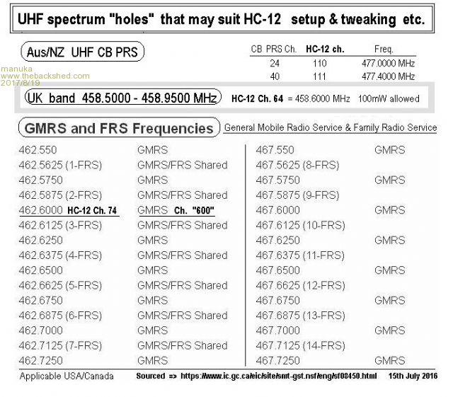

Agreed ! As HC-12 cover >100 "channels" at 400kHz spacing a further benefit is that they may feasibly suit use on other frequency spots, some with higher power.
The legality of this should of course be verified, but reception (at least) on several UHF CB channels is possible - see attached summary.
manuka
Joined: 18/12/2006
Posts: 19
Posted: 07:26pm 18 Aug 2017
Aside from NZ/Aus UHF "PRS", several UK & USA spectrum slots match up too. At the very least a cheapie UHF CB set can be used to check if your HC-12 transmitter is actually working,along with it's range,duty cycle & antenna/elevation benefits etc. Stan.Edited by manuka 2017-08-20

  Alastair said  Have you encountered any problems with interference in & out with other rf devices? This aspect worries me somewhat with the vast number of wireless devices we have around us now. I connected a long piece of wire to the input of my cro and turned the FFT on. There are certainly lots of signals around the place!
I have not encountered ANY interference issues at all with the HC-12's I have used.
The trick is to use a band that many others may not even know about as manuka was showing in his images.
Here in New Zealand, I use the HC-12's on channel 64 as he was showing(458.6MHz) as there is a nice little unrestricted slot of frequencies there at 458MHz where you can run up to 500mW of power
This applies to New Zealand - other countries would need to check their own regulations.
Anyway, at 458.6MHz, I can run the full 100mW output power, and with a 1/4 wave whip on the receiving end, and just the tiny supplied 433MHz helical on the transmitting node, I was getting very reliable transmissions out to about 350 meters - THROUGH WALLS/BUILDINGS/WET PLANT LIFE. One city block, really. This is excellent performance for the price of these things.
Just to be very clear: 1/4 W 433MHz SMA antenna(which is a 20MHz mis-match!) on SMA-U.FL adaptor lead plugged into receiving end HC-12, INSIDE house. Walking around with a polling transmitter HC-12 node and an RT to talk back to a helper at the house to tell me if the transmissions were getting there or not, and just holding the transmitting node in my hand and putting houses and plants in the way, all the way, as I get further and further down the road. The helical antennas I was using were 433MHz antennas, so I cut 1.75 turns off the end of it to re-tune the helical up to around 458MHz, but that was the only "Mod" really. I have no doubt that up high with decent tuned antennas at each end, you would get the 1.8km they claim they are capable of.
If you have a look back on Page 3 of this thread, you will see that I posted some spectrum analyser shots of their output, which surprised the hell out of me that they could be that clean considering how cheap they are! Usually with this cheap stuff capable of more then a few mW of output power, the RF output filter is the bit that gets no attention at all to save a few cents per-unit, resulting in a dirty output with harmonics all over the spectrum, which is NOT what you want.

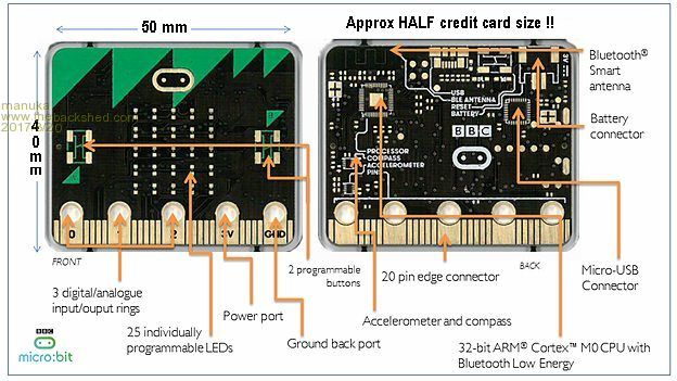

Extra-re PICAXE developments. With the likes of the near throwaway BBC micro:bit now gaining rapid educational uptake,it's increasingly possible that Rev.Ed have left things too late...
Edited by manuka 2017-08-21

Yes the BBC micro seems to be making an impact - I hope that Picaxe can lift their game but perhaps they have had their time in the sun.

re "time in the sun"
Not sure how this can be justified. The picaxe takes a more basic approach to electronics, interfacing, program development and satisfies all the coding requirements in most curriculum statements.
Check out the digital technologies statements in the Australian curriculum.
Most of the micro:bit coding is done with Blockly format and I mentioned that this would be an excellent environment for the micromite. As usual, the forum deviated in about 1ns (1 nanosecond) to discuss the relative merits of text coding and other languages.
The Blockly support for micro:bit and picaxe may have served as some inspiration to lift the excellent micromite to a higher level.
Imagine having a text window that replicates the LCD display and allows text, images, lines etc to be drawn and converted to BASIC micromite code?
Or a maths text window. Or a ........
