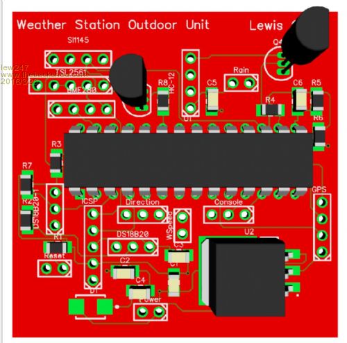

MicroBlocks
Joined: 12/05/2012
Location: Thailand
Posts: 2209
Posted: 06:52am 22 Mar 2016
Lewis,
I see you got some more practice.
It gets more easy after a while. I am already using it over two years so i am familiar with what can be done.
One of the things i never use is depend on the auto router.
I sometimes use it to see if placement is good, and for some simple designs it gets close. I then decide to use the auto routers result as a starting point or if it is really a mess i start from scratch and route everything by hand.
Most of the time at the end every trace is hand placed/moved as auto routing is still not good enough.
This is what i got so far:
All the screw terminals are facing to the outside of the board making connections easy. They can also be headers as the pitch is the same 0.1".
Not sure if the silkscreen for the screw terminals are right, the little dots might go on the inside, but that does only matter when the screw terminals have plastic notches that go into small holes in the pcb. I did not do that as the screw terminals i have in stock are flat on the bottom.Edited by MicroBlocks 2016-03-23

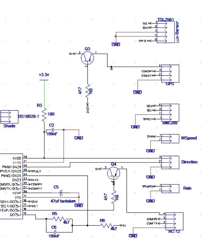

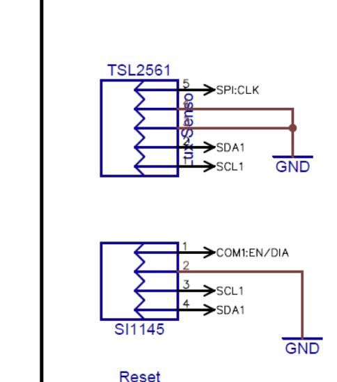

lew247
Joined: 23/12/2015
Posts: 1709
Posted: 07:33am 22 Mar 2016
That is really impressive
A couple of notes:
I changed the diode (D1) to a STPS1L30U
It's cheaper and smaller - it uses an smb footprint
DS18B20
could pin 2 labelled Sun
could Pin 3 labelled Shade
and Rain pin 2 labelled Speed
GPS needs power to go via transister/resistor/5V (or 4.7v) and pin 23
although I can use Pin 7 if you want as thats already on the board?
See image below (this is to conserve power)
lew247
Joined: 23/12/2015
Posts: 1709
Posted: 07:34am 22 Mar 2016
IF there is no room for the transistor for the gps power then it's ok, leave it as it is, it only uses around 5mW so as long as the battery does get charged every day it should be fine.

HankR
Joined: 02/01/2015
Posts: 209
Posted: 08:23am 22 Mar 2016
MB,
On the right side of the uC there are resistors R9, R8, R4, and another surface mount part I can't make out.
These are a little close to the uC, especially if a socket is employed.
Could there be just a smidge more room opened up, perhaps by simply sliding the uC a few hundredths of an inch to the left?
HREdited by HankR 2016-03-23

HankR
Joined: 02/01/2015
Posts: 209
Posted: 02:54pm 22 Mar 2016
I hope I can persuade Lew to make a slight change in what has become two power saving switches driving the GPS and the HC-12. We've been PMing about it.
As now drawn, NPN transistors (Q1, Q2) are hooked up as "emitter followers" so it's not possible for them to deliver more voltage to these emitter driven loads than the base voltage, because these circuits have 100% voltage feedback where the output follows the input with an AC voltage gain of 1.
That's where the name *emitter follower* comes from.
For DC levels it's actually even worse, because the B-E junction voltage drop subtracts from the output, so it's going to be something like 3.3-.6 = 2.7 out (depending a little on load current and other factors).
The solution is very easy: change to a PNP (2N3906 is the exact complementary part, but almost anything works) and switch emitter and collector leads. I've sent Lew the circuit. Even if the board stays as is, a twist of the two transistor leads will work.
Hank

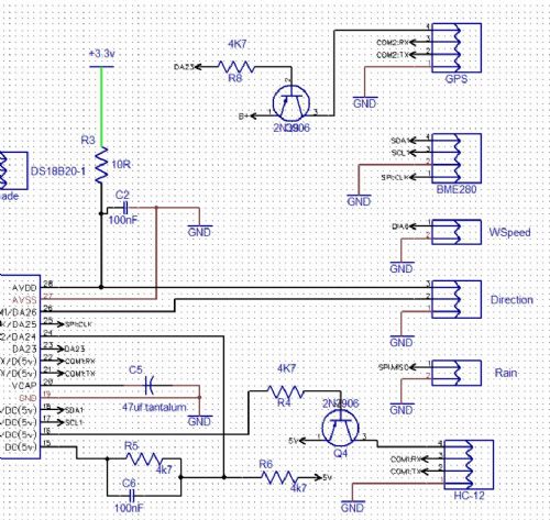

lew247
Joined: 23/12/2015
Posts: 1709
Posted: 10:53pm 22 Mar 2016
Hank's suggestion is a good one
All it really needs is the silk screen for the board to show the the 2N3906 pinout instead of the previous one (pnp instead of npn)
(pins reversed)
Edited by lew247 2016-03-24
Posts: 2981
Posted: 11:02pm 22 Mar 2016
Hi Lew,
You have the emitter and collector reversed. In your schematic... (If my transistor logic has not left me far behind)
lew247
Joined: 23/12/2015
Posts: 1709
Posted: 04:08am 23 Mar 2016
Sorry you're right
corrected below (hopefully)
I wish there was a way to delete posts that need deleting like the circuit above!!!!!

Posts: 2981
Posted: 12:25pm 23 Mar 2016
Hi Lew, All,
I have been looking at your transistor circuit again and I dont think it will work as you expect it to.
The basic premise is to conduct across the emitter/base to turn the transistor ON.. This means applying a LOW to the BASE will conduct across the emitter/Collector... OK that works..
BUT
The maximum voltage you can apply to the base driven as shown is 3v3 which would still mean that as this is more than 0.6v less than the emitter's 5V level that the transistor is still ON.. Personally I think a better solution would be to use some Opto-Isolators to do the job..
Open to feedback.. There are many cobwebs in my brain where I stored my transistor logic theory..
Kind Regards,
Mick Edited by bigmik 2016-03-24
Posts: 2981
Posted: 12:30pm 23 Mar 2016
GDay Lew,
  lew247 said   Got the board a nice 50mm X 50mm now
Looks OK, but some constructive criticism....
Firstly you would not be able to use screw terminal blocks the way you have them layed out, you are limited to male/female headers (not that that is a realy problem if that is what you want)
Secondly I would increase the track thickness for all of the power rails, (5V, 3v3, GND)
I generally use 0.01" for signal tracks and 0.025" for power tracks (or 0.20" if space is tight)

HankR
Joined: 02/01/2015
Posts: 209
Posted: 04:39pm 23 Mar 2016
  bigmik said   Hi Lew, All,
I have been looking at your transistor circuit again and I don't think it will work as you expect it to.
Mick,
You are correct with the present state of the circuit. So good catch there.
As originally conceived by Lew, the feed to the peripherals was 3.3 volts, just like the uC.
In that instance, no problem in the standard configuration shown in the schematic (except going back to 3.3 volts on the emitter) which is used all the time.
uC output pin low = switched loads supplied with 3.3 volts (across load terminals) and current.
uC output pin high = switched loads have no current.
and, just to be thorough,
uC pin floating = switched loads have no current.
To stay with 5 volts going to the switched loads, a circuit mod using only one more transistor and resistor will do it nicely. Details in a later post.
Of course, with an optoisolator you can do almost anything, even controlling an AC load.
Hank
