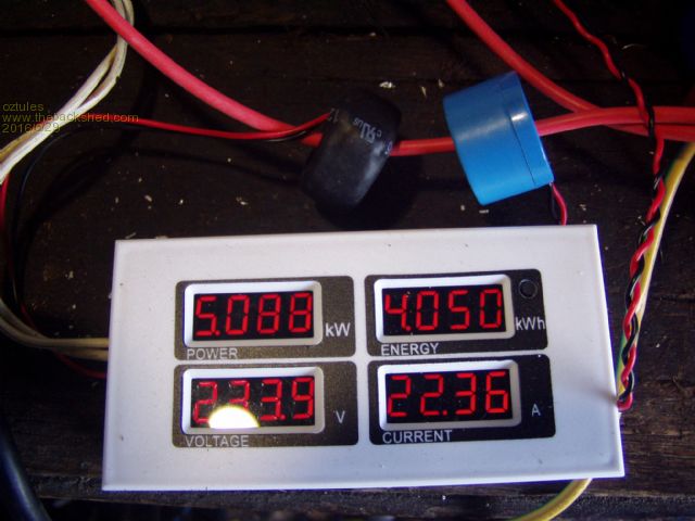

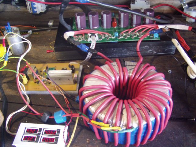

Well done Grogster.
For encouragement, here I am testing the response of the heat sink to no fans and the flat style power board both me and Mad are using.
I am running the whole house, and the HW is on, the washing machine is on, as is the water pump, tv, and countless other gadgets at the moment.... and then the kettel.
So this shows the usage while the jug is on.
The tranny is a quick test thing well under rated, but still holding the 5kw fine...
and this shows the mess making it:
The transformer stabilised at 70C after 2 hours of average 2.5kw, with excursions up to 5.3kw. This is a test transformer only!
Heat sink temp which is what we are really interested in here slowly climbed from 20c to 37c... and stabilised there.
No attempt to cool, or even give it convective cooling opportunity.
It is using an inspire heat sink... and thats it. The fets are sandwiched to the heat sink under the power board ( from clockman thank you).
It looks like you may need no extra cooling if you use an average load of 2.5kw
and mount it sensibly.... no houses use this sort of power that I am familiar with... normally 500w-600w max average over 24hr period... about 14kwh/day
48v gives you flexability, as the currents are not killer material.
My place uses this sort of power for the 3hrs used for the HW to heat.... and I may mitigate this with some caps to pull the peaks down, and the time longer.

Yes, I was pleased with the test...
If you rotate the box to portrait from landscaoe orientation, there will be good convective cooling, and fans will probably never be required on any normal house duty... ie if 3 hrs didn't bother it at at least 2.6kw continuous.... then we are pretty safe when we put the thing vertical I think.
Cooling holes in the top and bottom made from fan grills for the 120mm units should cool the transformer easily.
What could be the problem with your plan, is getting the transformer in there without interfering with the tops of the caps....
At the 2-3kw levels, the caps did not heat appreciably or noticeably, they are big and there are 6 on this board.
I suspect we may not need the fans at all down here, maybe up there on a 40c day, your possible for 70c.
When the HW turned off , the heat sink ( after a long time) came back to 25c or about 5c above ambient at the time, and later towards the end of the day it came back to 22c and loads came back to 200-400watts, with a few more big excursions.

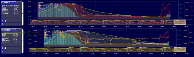

Hi Grogster,
I have one of the meters the same as OZ, before I began this project, mounting it was a pain as I had no where to put it so the DIN version would have been much easier. However now I am building my own inverter it will be going into the inverter front which will be very easy to do. Think about where it would be more convenient for you to read it. No doubt you want to see what your new DIY inverter is up to.
After I get my inverter finished I will be working on a Arduino based monitoring system with data logging and network access so I can read what is going on via a computer. My charge contollers do this and I like it a lot as I can see at a glance what has been happening at any time.
White in bottom graph is state of charge
Brown battery current
yellow battery volts
green battery temp
Edited by Madness 2016-06-30
