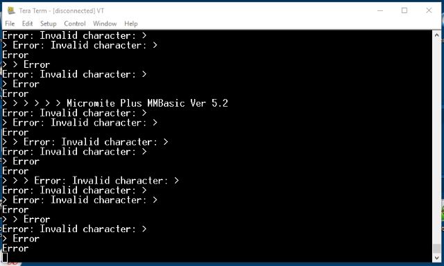

Just as an 'aside' here is the 'dump' I got at the 'command prompt' when I had shorted 'console port' pins -
At my stage of life I like to think about problems before 'posting'. I like to think it wards off Dementia
Note that this was a continuously scrolling dump. Edited by mikeb 2016-08-21

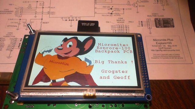

Posted: 03:59pm 19 Aug 2016
One picture worth a thousand words..!!

@ Zonker - Glad to see it arrived to you OK. Nice image. 4.3 inch screen?
