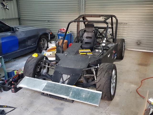

The second last event of 2018 was the Noosa Hill Climb. It was only my second time at the event and I improved by 4 seconds. The car was still understeering but was managable. But the understeer prevents me from gaining too much confidence and holding corner speed. So I am still focused on improving that aspect of the car. Here is a video from that event:
https://www.youtube.com/watch?v=O0FDh_p_rbk
The last event of 2018 was an autocross/khanacross. But it was very very wet which emphasised the understeer to the point where is was not managable. I don't have a video for that event.
I started with a check of all the suspension geometry including Castor, camber, king pin inclination, roll centres, toe in and Ackerman angle.
Castor was about right on the driver side but significantly more aggressive on the passenger side. This will be resolved as I complete the new front contro...l arms.
Camber, king pin inclination and roll centres were about where they need to be.
Toe in was correct but will need to be adjusted again as it will be impacted by all the other changes.
Ackerman angle was a little out on the passenger side but not enough to warrant a change in the short term. The driver side was out by a bit more and I have now replaced the adaptor plate to bring it in line with the passenger side.
I have made some solid progress on a second nose for the car. The first nose is for lower speed events where it is an advantage for the tyres to be in front of the nose. The new nose is sleeker, and will include a wing for additional downforce (maybe). The two noses are interchangeable depending on the upcoming types of events. The nose and wing are structurally complete and just need the panels to be added.
I have created some ballast in the form of a 10kg lump of lead. This can be added or removed depending on conditions. I intend to only include it in wet weather where the understeer characteristics seemed to be pronounced.
I have made new front control arms. These are designed to address the inequality in caster from left to right. They are also designed with a slight bend in the front bar of each arm. The bend is to improve the angle of the rose joint attaching to the chassis mount. I was concerned about the bend creating a weak point in the control arm. So you can see I added some significant reinforcing to ensure it can handle the forces.
I am also part way through a modification of the hydraulic handbrake setup. The existing setup has a single master cylinder serving both rear wheels equally. The braking capacity was insufficient to overcome the grip of the rear tyres. The new setup will have dual master cylinders opposing each other with a handle in between the cylinders. Pushing the handle forward will operate the right rear brake and pulling it back will operate the left rear brake. Operating one of the rear brakes at the same time as some mild acceleration should enable the car to perform very tight turns when required (one of the requirements it has struggled to satisfy in the past). The car will retain the cable handbrake for parking and as an emergency brake. I have created the adaptor brackets required for the modification but I will need a full weekend to install system, rerun all the hydraulics and bleed the system.

Here is how the car looks since the Christmas break.

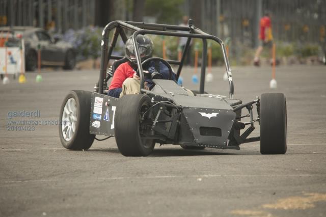

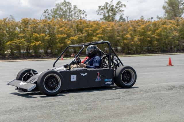

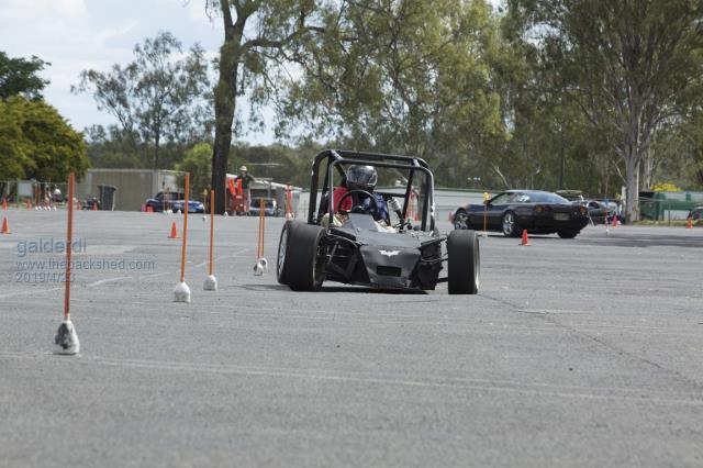

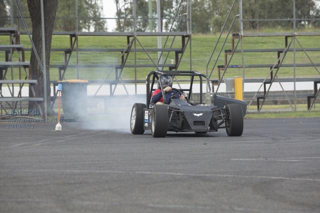

Posted: 07:26am 23 Apr 2019

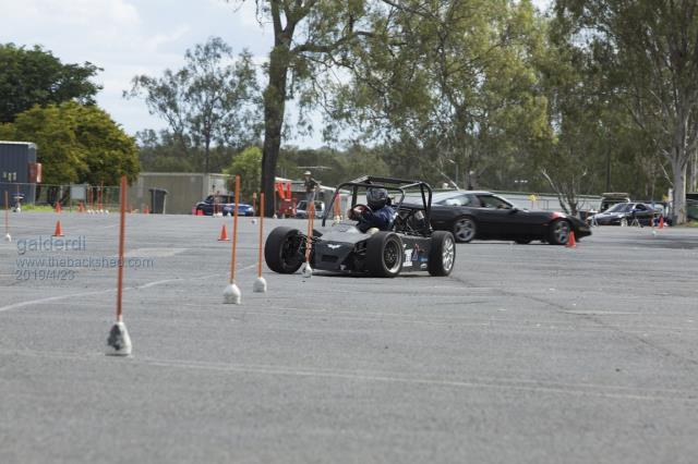

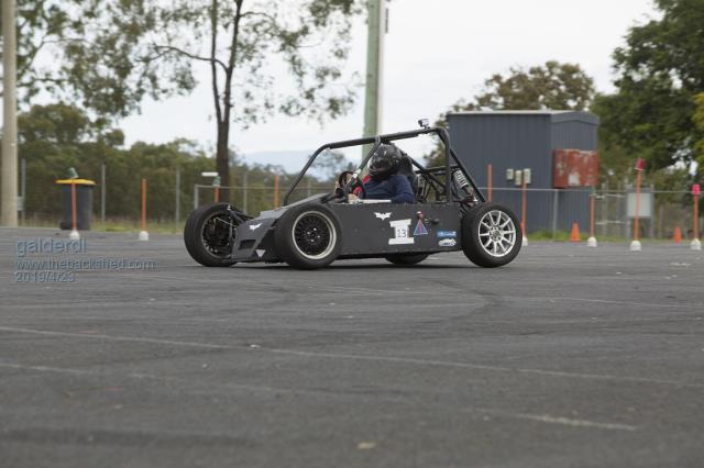

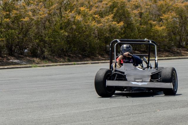

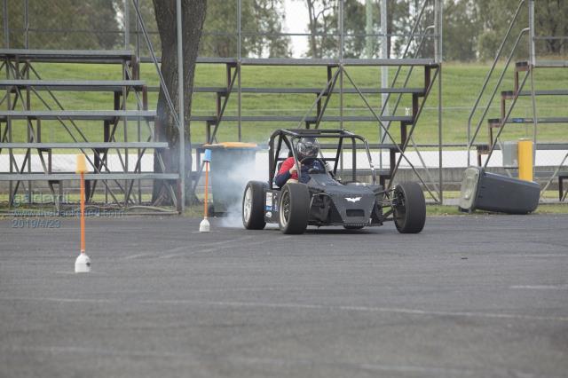

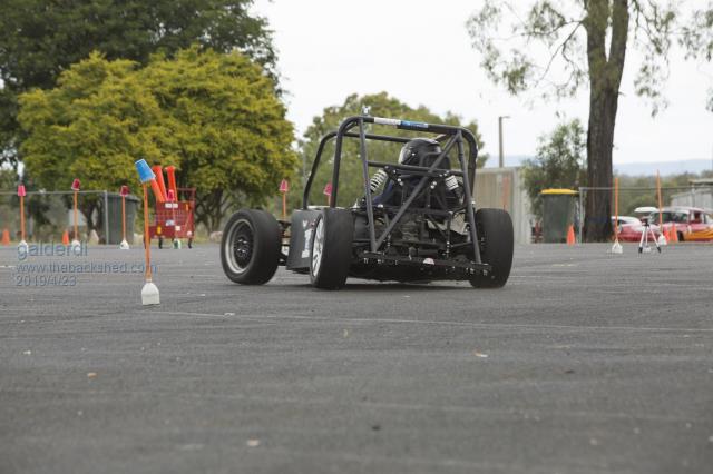

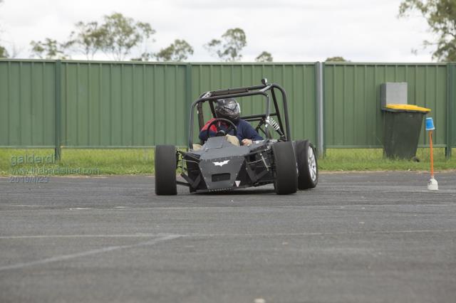

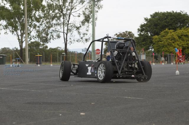

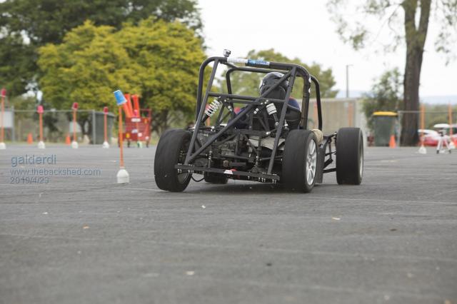

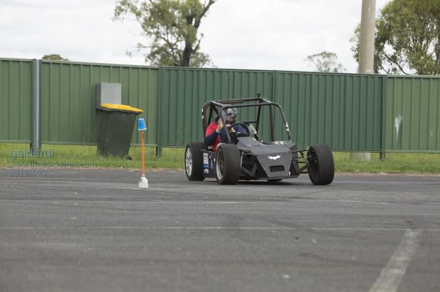

Here are some images from the event last week:

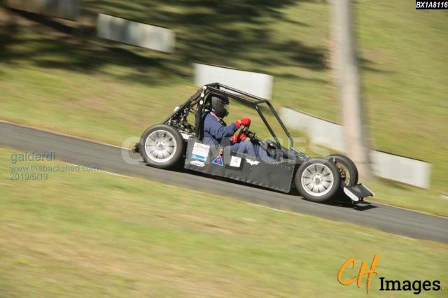

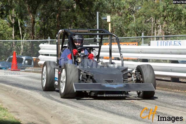

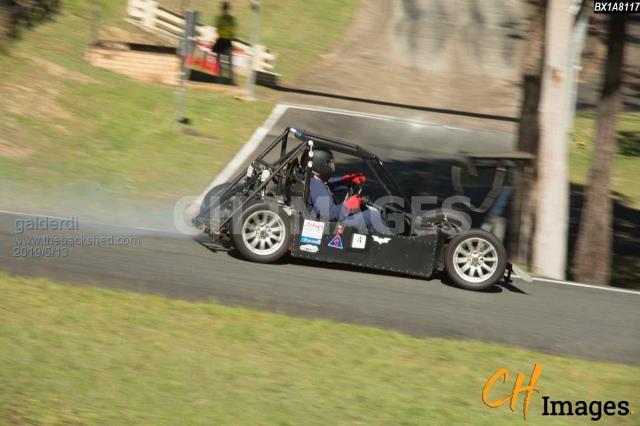

I had a great day at the Mt Cotton Hill climb on Saturday. My results were not all that impressive but quite respectable for a first attempt. I did end up in the Macadamia nuts (quite an effective safety barrier) on my second run. This event has made me realise the "understeer" issue I had been trying to resolve is gone and what I am suffering from now is actually a brake bias issue. On the successful runs during the day I was forced to brake very early for the tight corners and enter at rather conservative speeds. On the second run I left the braking too late for the brakes to handle and as a result continued straight ahead into the nuts. There was no damage to the car or driver apart from some dents to the ego. All in all it was a very successful day as I now know what is required to make the car more competitive. Here are a few photos from the day.
