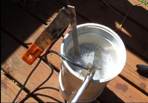

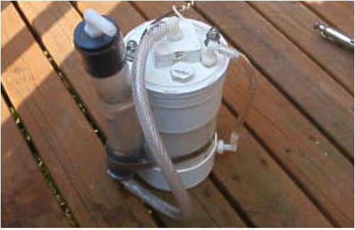

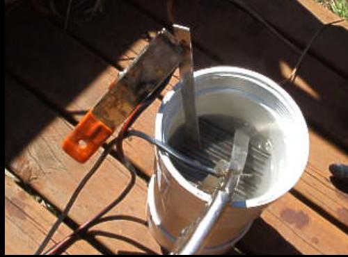

would short circuit the battery.The Photo's below are my own, The smacks design shown in the first photo is my first Generator. Later I modified the smacks, i junked the 304 alloy wall switch plates and purchased a sheet of 316 alloy S.S., Then fabricated 16 plates but only 14
would fit in the PVC Pipe Cell The Second picture is the
modified version with bubbler. My battery charger showed
14 anp at 12 volts input, notice the 2 large bubbles in the bubbler, they were coming pretty fast. Sodium Hydroxide was used as electrolyte.

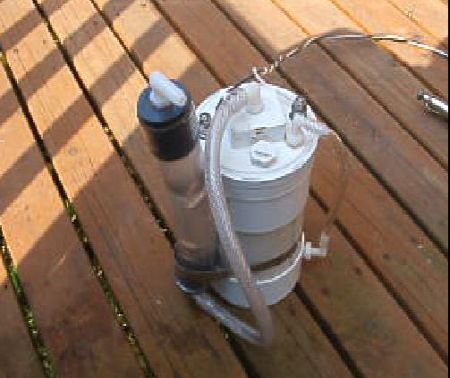

I sent the wrong pic' of the bubbler even though the large bubbles are present in that pic. only one small one shows
here is the correct one

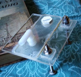

I have not had time to mess with the HYD. generators lately but here is a pic. of the top that
would fit on this design. I previously made up a how to build it instructable for a different web site
but decided not to post it.
Here is a introduction statement for that post.
Introduction;
What ever you call it, This Device Rip's up Water.
With its multiple atributes it can rip up a shop bench blow out windows and ruin a good life.
I have seen on the net where people claim to have lit the output hose with a match or lighter,
Don't fall for this invitation to get hurt badly. Bang bang fun, Is it worth a lifetime of blindness from Lye, flying pieces of metal and plastic "You 're the Judge". If you smiled when you read this you should not build one.
Booster 0 is a drawing of what you are building, it contains the info necessary to build one but it also looks like too much to deal with. This is not at all difficult to build, what I found difficult was bonding the acrylic container (CASE) When I finally succeeded to stop the leaks it looked like kids had played with it while I was away. all through the steps to follow you will see a nag to clean your parts with alcohol , also use gloves when handling. I thought that soap and hot water rinse would do the job. wrong.! another mistake was using acrylic bond from" Lowes", a double tube that was difficult to operate when trying to extract equal parts of the resin. And it does not dry clear.
When all sides were bonded to the bottom I filled it with water, only 2 seams did not leak.
Now trying to get the resin mix into a V corner from a swab is messy-messy.
Step #1,
Determine the size of your booster plates acording to the displacement of your engine.
That is 240 square inches of total plate area for each Liter displacement. A 2.2 liter engine would need 528 sq. ins. I do it like this, 528 / 16 plates = 33 / 2 sides =16.5sq. ins. surface on 1 side
Now you will need to locate a mounting place in your Engine compartment. In some cases the booster will fit better if it is wider than it is tall, Only You can decide the shape of the plates.
The one I built Had 432 sq. in. for a 1.8 liter subaru. the plate size, 432/16 = 27/2 sides = 13.2 on
1 side. 13.2 divided by my chosen plate width 3 1/4". resulted in 4" tall. Keep in mind that a Bubbler will have to be mounted near the booster, Both in a cool area. Between the grille and the radiator is a good place if there is room.
Step #2
Order the S steel plates or pick them up from your local supplier, in my area the nylon rods were not easy to find, this may be something you will have to order.The "Weld On" bonding cement is
not stocked at Lowes or Home depot but can be ordered on line. may also be available where
aquarium's are sold.
Make a run to the local building supply store, Lows, Home Depot, etc.
Acrylic sheet .22 thick.
2ea. Stainless bolts and nuts #12 X 2 1/2"
1 Nylon elbow male, 1/8 pipe thread X 5/16 hose
1 PVC, or grey plastic pipe plug 1/2"Pipe thread
16 nylon washers 1/4" thick X 5/16" hole size
16 nylon washers 1/8 thick X 5/16" hole size
