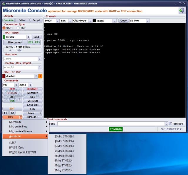

Posted: 10:04pm 30 Nov 2018
Hi to Everybody
In "Console" sheet:
- added CPU frequecy for all MMBasic family
announcement for those interested on "MYSQL"
- Micromite Console will be equipped with mysql potential
- the editor will have the possibility to interact with DB MySQL, save/load/search code
- the scripts will be able to dialogue with the UART/TCP and the DB, this will allow an exchange of data
- the application will give all the support to create the tables that need to start the MYSQL management
I personally already use this method with raspberry/linux server or with internet/cloud that offer free services with limited DB up to 200MB.
Those interested can expand future features by describing other ideas.
Here the link for download v.0.943
Every comment and / or suggestion is appreciated
Antonio
KeepIS
Joined: 13/10/2014
Posts: 2265
Posted: 01:37am 01 Dec 2018
Am I missing something? I cannot get the program to remember its window size, it always defaults to a small window with the bottom controls hidden.
[quote]
added CPU frequecy for all MMBasic family [/quote]
Is the Armmite H7 @ 400 Mhz included?
NANO:Inverter V 8.4ksLinux AvrDude GUI script V4.1
sagt3k
Joined: 01/02/2015
Location: Italy
Posts: 313
Posted: 08:03am 01 Dec 2018
Hi KeepIS
- according to the specifications of matherp and following the last manual page 14:
Unsupported commands
The Armmite H7 does not currently support dynamically changing the CPU speed or the sleep function. Accordingly the commands CPU speed and CPU SLEEP are not available ..
- about the position of the application, I do not memorize the last position. So when the application is restarted, it is positioned at the center of the monitor and in restricted mode. Is it necessary to store the size at the next start?
Antonio
