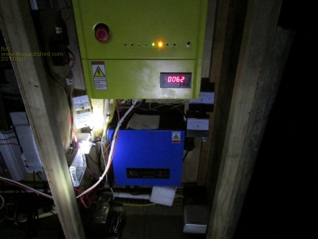

I like the analog meters with the moving needle
getting a mate whos a certified electrician to check it all.Edited by flc1 2017-09-07

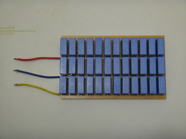

Have made up an improved 'Power Factor Correction Capacitor' set, version 2 that should give you some improvement with the top end power output.
Here's a photo of it assembled on a circuit board.
It should allow the 12x 1p Delta stator connected to your new 40 - 540 V Grid Tie Inverter to output 1 kW at just over 400 RPM. The peak power output of that new inverter (1.2 kW) should be possible at around 500 RPM.
I'll send it down to you tomorrow so you get it next week.
David

Nice work , thanks Dave, I look forward to hooking that into the system

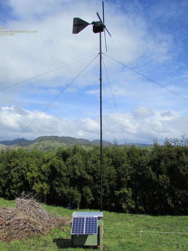

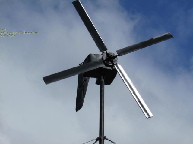

Il send that furling controller back to you for a slight tweek to improve things,or if you come for a looksee visit you can pick it up?
Had a bit of wind today and it put out about 1.3 kw.
It seems to start in lower winds than my old turbine,and puts out more power already without going through a storm to do it,
It runs smooth at the mid rpm range so I must have got the blade pitch, tracking and balance right this time.So far its a success, still trying to learn how to operate the new inverter, the pigeon english in the owners manual doesn't help things ,and the inverter only switches on if theres wind, so if there is no wind then the inverter is switched off.Edited by flc1 2017-09-08

haveing another moderate wind day today with the turbine getting to or near the 1kw output mark fairly easily,the new inverter amp meter seems to read about .3 of an amp higher than what my analog meters do

just had one gust come through which made the turbine put out 1570w
the 45-90v inverter put out 780w for the two stators, and the 40-540v inverter put out 790w for the single stator.
I was under the turbine at the inverter box when the turbine started going hard, I ran away ha!
don't want to be near it if it decides to fly to bitsEdited by flc1 2017-09-09

The turbine starts turning at about 2.6ms wind.

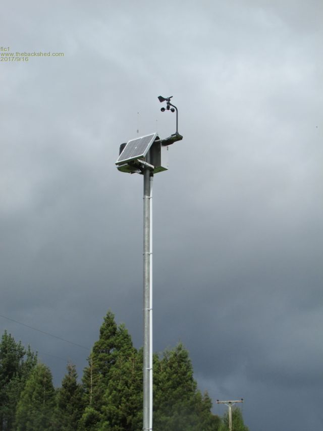

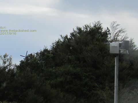

I have got access to the online data from an anemometer above an orchard about 100m away from my turbine, Not 100% accurate because its not right next to my turbine,
but still good enough for a approx wind speed reading in relation to output,
so tonight I used it for first reading of 35kmh= approx 1500watts output,
will be able to do daily average etc.
I will eventualy buy a good pole mounted anemometer,one day lol
only have a handheld one at the moment, which is only accurate up to about 30kmh.

neighbours anemometer/weatherstation
anemometer with winturbine in the background,
The turbine will be getting a good workout for the next few days with some rough weather passing through here.
5kwh output for the last 24hrs from average windspeed max of 20kmh, with gusts up to 43 kmh Edited by flc1 2017-09-17
