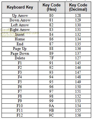

Thanks for looking at the bugs; just noticed one more in the DOS version.
I found key-presses using INKEY$ in QuickBasic very handy when doing text-mode dialogs.
In MM when keys are pressed which generate compound codes [e.g. up-arrow CHR$(0) + CHR$(72) ] then the second code is delayed until the subsequent key-press...and so forth..until a key which doesn't generate a compound code is pressed...everything 'catches up'.

  flip said  In MM when keys are pressed which generate compound codes [e.g. up-arrow CHR$(0) + CHR$(72) ] then the second code is delayed until the subsequent key-press...and so forth..until a key which doesn't generate a compound code is pressed...everything 'catches up'.
That issue and the other bugs are fixed in the attached version 5.04.05 Beta 4:
2017-07-15_143318_DOS_MMBasic_5.04.05_Beta_4.zip
This version generates the following codes for special keys:
The manual has been updated to reflect this and the other errors listed above.

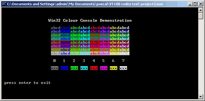

Posts: 2552
Posted: 05:43am 18 Jul 2017
have done a bit of digging - getting VT-100 compatibility is indeed complicated. however, positioning the cursor and changing colour attributes is relatively simple using the win32 API calls SetConsoleCursorPosition(h, xy) and SetConsoleTextAttribute(h, at).
the attached demo (source included in delphi/pascal) provides three functions:
gotoXY(x, y)
colour(attribute)
clrscr
i reckon these three functions would be a neat addition to the DOS version of mmbasic. there are also console functions in the win32 API to handle keyboard (and possibly mouse) input, but these look a little more involved. see:

Posts: 2552
Posted: 08:15pm 18 Jul 2017
but if the goal is to simply replicate the PIC32 version, would one then not want to also think about putting in stubs to in some way handle all the I/O? i rather like the alternative idea of DOS mmbasic being something that has it's own unique set of festures - running on a PC there are a whole swathe of applications that are out of reach of the PIC32 versions.
the below .zip file contains an external program (cursor.exe) that can be called from within mmbasic to provide colour and cursor positioning. there is a demo program (colour demo hack.bas) included to show how to use it. painfully slow, but it does demonstrate the idea.
2017-07-19_060844_cursor.zip
note: you can't just drop the 'colour demo hack.bas' file onto the mmbasic icon to run it, as mmbasic will start up in the wrong directory and not be able to find cursor.exe. instead you need to start mmbasic.exe, then type:
load "colour demo hack"
run
