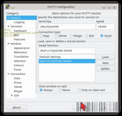

I have Putty Linux installed, so this should connect to /dev/ttyACM0

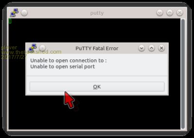

Following pic has capital ACM

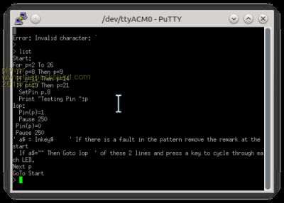

Following pic shows succes
Now the device has acm lower case in the name
The picture shows linux putty differentiates between upper/lower case
So using Putty Linux I now know I must not use lower case, so I should stick to upper case only from here on.

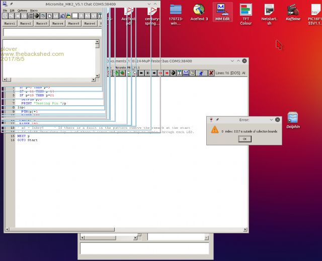

At this stage there does not look like pre assigning links will work because Opening MME cleans the slate except for com1..2 in some cases and in others leave one port. I wonder if it has something to do with settings in the Registry but I think I will leave that at the moment. Perhaps I get a better understanding of what is going on I can reconsider.
I have 3 different installs running, at the moment this is the oldest of the new KDE5 I am trying to get up and running after the disaster getting KDE4 and 5 mixed up.
One of the other systems is partly usable the last has gone bonkers (flickering mouse pointer, eventually locking up MME) so I will reinstall wine and take it from there if I can find time.
Early this morning I took a copy of your portable MME and tested it on a Win 7 laptop, of course it only took about 15 minutes to get it working on one of the Micros. Time mostly spent finding the driver for the USB serial port. Going for Window session was a low point. I hope this is a real turning point Edited by plover 2017-07-30

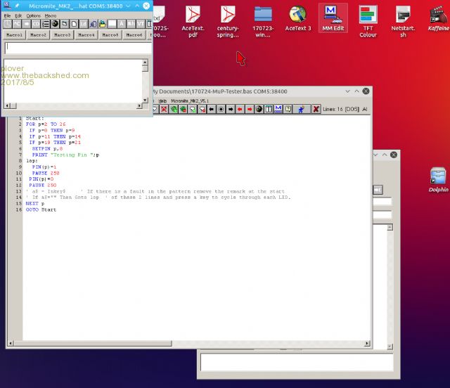

I have tried to write down student proof method to get my two Micromite systems running with MME every time starting up. I am very close to have it working every time but still not quite.
I can almost certainly connect with MME each time on my KDE5-os2 (my second system running MME) this system have however developed an unexpected problem (no doubt my tinkering but I have little memory of what it might have been.)
Assuming I have the linking in order and keep a close eye on any links getting kicked out when I open MME then.
1.. Clicking on the MME icon on the desktop will open MME nicely, you will see on the picture following.
2.. At the moment I almost invariably start MM Files, which comes to the front of MME window. I use this step to ensure the comport is connected, if not I will get an error.

4.. The logical thing is to resize the window to a bigger size (used to open to a comfortable big size). Attempting to resize puts a spanner in the wheels and the MME is locked up. Killing the process the quickes way out. The two following pictures shows what goes on.
Small error message:
[quote]0 index: 1117 is outside collection boundary[/quote]
These are original screen cuts, I reduced them to about 1/3 but for some reason those would not upload. Sorry about the size.
The first picture is what shows before I try to resize. The second picture is when I have locked up MME and then Kill the MME process to get going again.
I wanted to resize because the small windows a too much to put up with. I have a workaround for the moment, perhaps. An application window can be configured in a number of ways, one it the open size. I did that in Linux and seems to work, or is a better workable situation. I have only done limited resizing, lock up not hit me yet.

I can repeat the "index: 1117 is outside collection boundary" error on my Linux setup so I will have a look at it.
The error doesn't occur on Windows.
You can get around it by closing the file manager before opening the chat window.
Because the error only occurs with Linux and there is a workaround, I will not put too high a priority on it.
