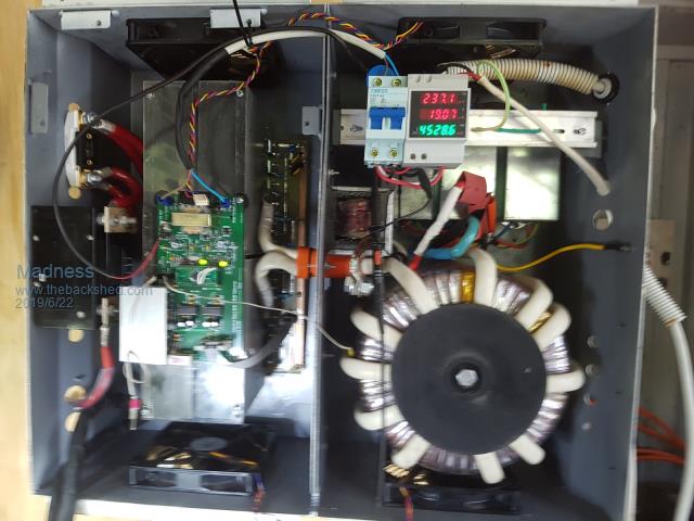

Hey Warp.
Thanks for you answer. It helps a lot.
So, this is correct?
To avoid radiation from the transformer wiring, you recommend putting some aluminized tape or copper tape on the wiring?
Thanks.

This works for me.

  Madness said   This works for me.
Looks like ~20cm each wire.
Here i will be running about 80cm. Maybe this is a problem? I can try to reduce this size.

The way I built it was to take advantage of natural convection. There are 140mm fans top and bottom on both sides as you can see. Most of the time the fans do not run but the top of the case is noticeably warm. Doing this way also allowed me to keep the Toroid as close as possible to the power board. The cables between them though is still close to 300MM when straightened out.
BTW that was the first homemade prototype of the TOTEM pole power board.

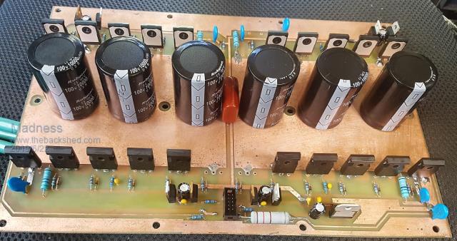

  Madness said   The way I built it was to take advantage of natural convection. There are 140mm fans top and bottom on both sides as you can see. Most of the time the fans do not run but the top of the case is noticeably warm. Doing this way also allowed me to keep the Toroid as close as possible to the power board. The cables between them though is still close to 300MM when straightened out.
I've tried to make your power board at home some months ago using silk transfer but it really went bad. Much better to have the original Mad power boards.
To keep the EI transformers cool i will be using some old server fans. My cooling design is not good as yours, but is the only chassis i have at the moment.
So, the better is to keep this wiring small as possible?

If you were told the wires have to be less than 200MM you would find a way.
It is not worth trying to make the PCBs when I have them for $30AUD each, It cost nearly that much for the materials then a lot of time to etch and drill plus failures and you can never make anything anywhere near as good as the professional boards.
I have few left at that price, if I get more made I won't be selling them that cheap as costs have increased.

Yes that is how to do it.
Its mainly about keeping the wires very close together to prevent noise possibly radiating into the control system. With close spacing, the electrical and magnetic fields tend to cancel at a distance.
To get some scale the long side of the main PCB is 300mm long. If you take a piece of wire and bend it to the shape of the white wires going to the toroid on your screen and then straighten it and compare to the PCB it is very close to the same length. This does not take into account bends towards the front or back that are flattened out in a 2D photo.
If you look at this Video of Clockmans the Toroid primary wires are quite long. So don't worry about what I have been saying about length.
