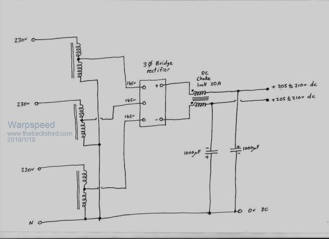

Posted: 11:52pm 17 Jan 2018
Haha o/k George, you win.
A three phase rectifier produces some really nice dc with minimal ripple voltage as the wind turbine guys will already know.
The problem with an inverter is that it draws a very heavily pulsing load at 100 Hz which may not be a problem from a big battery, but it becomes more difficult to do from a rectifier, especially a single phase rectifier where the inverter and mains frequencies may be constantly drifting in and out of phase.
A three phase rectifier solves all of those types of problems, especially if the dc output voltage is fairly high, requiring minimal extra filter capacitance.

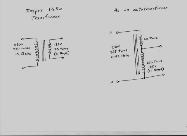

Now my own sine wave inverter requires split high voltage dc power supply rails, because its a half bridge design, ideally about +220v and -220v dc to provide 230v rms (325v peak) output.
As a three phase six diode bridge produces a dc output about equal to the voltage peak, three transformers will be required to lower the mains voltage going into the rectifier to produce the required dc output voltages.
I used three Inspire 1.5Kw grid tie inverter transformers to do that, but they are not connected as normal isolation transformers, but as auto-transformers.
That has several benefits, the biggest one is that the 230v primary and 135v secondary are now connected in series across the incoming 230v, which greatly reduces the flux in the transformer core from 1.5T to around 0.95T and no load idling current of these three monsters shrinks to around 11 watts each.
The other advantage is I can use the three original unmolested Inspire transformers without going through the whole rewinding drama ..... and I am lazy.
That should give me something like 4.5Kw of solid dc with excellent voltage regulation and a minimal idling power loss of only 33 watts. (0.8Kwh over 24 hours).
Its turned out to be vastly larger and much more powerful than it really needs to be for my very modest night time loads. But its now built and working fine, and it will do until I get my lithium battery system up and running.

The original idea of monitoring the power flow, and basically doing what the spinny meter does is still possible and quite practical.
Feeding only sufficient power back to just cancel out usage over time.
I have a smart meter here, dropping power usage completely to zero by going completely off grid may not be the smartest long term strategy.
What could be much more sneaky would be to still draw some small power from the grid, and make it look like a normal daily power load profile, but much much lower.
I could arrange things so that 90% of the power comes from solar and battery, but the other 10% always comes from the grid. Day or night. That may be the next step forward after I get the battery part of my system hooked up and running.
It could all be done on the dc side of the system. Monitoring dc current coming from battery, solar, and rectifier, and arranging things so that the rectifier always carried some small fixed proportion by throttling back the battery at night and solar during the day.
