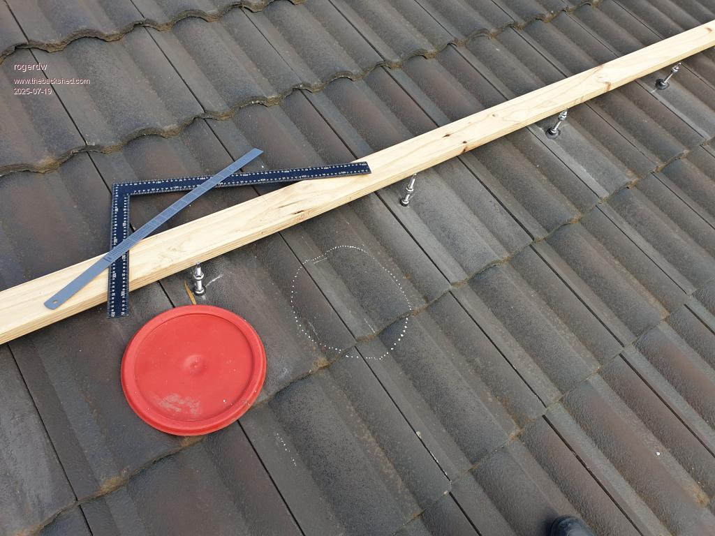

  Revlac said   just some method (the frame can sit in) that doesn't require lining up holes,
That there is wisdom! Wish I had realised that before.
I have actually marked it all out and drilled the holes now  ...  and am pretty comfortable that they are correct  ...  though I'll have egg on my face if they are wrong. But it has taken a lot of time getting them correct.
I took a long length of timber up on the roof and pressed marks into it from the heads of the studs.
Then I drilled my first hole in the frame and worked from there, triangulating all the distances and transfering them over. Was especially nice to see a third angle cross over the centrepoint of another two marks  ...  gives me a lot more confidence.

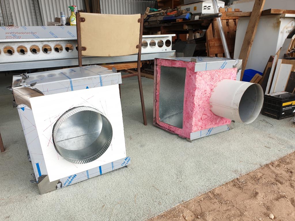

Well I finally got the end cowls from the young lad who was bending them up and welding the ends in. He did a great job and they fit well. One overlaps on the outside of the main cowl and the other fits inside  ...  to help prevent water creeping in on the downward slope.
He suggested rivnuts to attach them, so I bought a cheapie set from Supercheap  ...  and they also worked well. Coulda saved 20 bucks from aliexpress but a bird in the hand  ...
I lined up the inner 90 degree duct inside the outer cowl for the hot end and filled it with fire resistant expanding foam. It didn't work all that well but I got the job done and it's still all lined up.
The cold input end required a lot of space to be filled  ...  and so I thought I could do the bulk of it with just normal polystyrene foam, which we have a great stack of from the previous owners  ...  and then finish off any small gaps with expanding foam.
It turned out that I was able to fill the whole thing really tightly with the foam sheets, so didn't need the expanding stuff.
I've test fitted the ends a number of times  ...  and I dread the thought of fitting them on the roof  ...  having to feed the ducts through the Dektites first  ...  but I'm sure it'll work okay.
This is the cold duct 90 degree input. I had found the short 250mm spigot and plate in the local scrap yard for $10 and I fabricated the rest.
And this is it safely encased in the end cowl. I probably should have had the cowl made much smaller but that would have required a fairly complex shape and fabrication  ...  so it's huge and matches the other end.
And this is the hot air outlet all lined up ready to be "encased". You can see the rivnuts and they seem very solid.
And now fitted to the end  ...  along with just some of the excess expanded foam. Half filled a garbage bag with it all.
Bit of a mess, but I've vacuumed it since and looks a bit more respecable now.
Should also look a lot tidier once I peel off all the protective covering from the stainless  ...  but figure I should leave it there as long as I can.

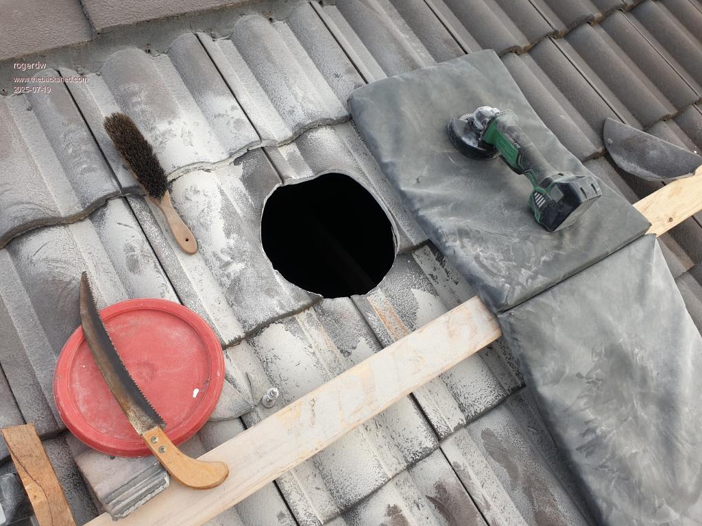

Made some fairly major progress today. I think the whole time I've been planning this job, cutting the holes in the roof has scared me the most  ...  but it all went very smoothly. Phew.
Used the timber that I had marked and drilled to locate the anchor bolts  ...  and transfered the positioning for the ducts that will go through the tiles. Then took that up on the roof and marked out the holes.
Certainly didn't want to get it wrong, but pretty happy with how it worked out. I used a tile blade from bunnos in my angle grinder and that chewed through nicely.

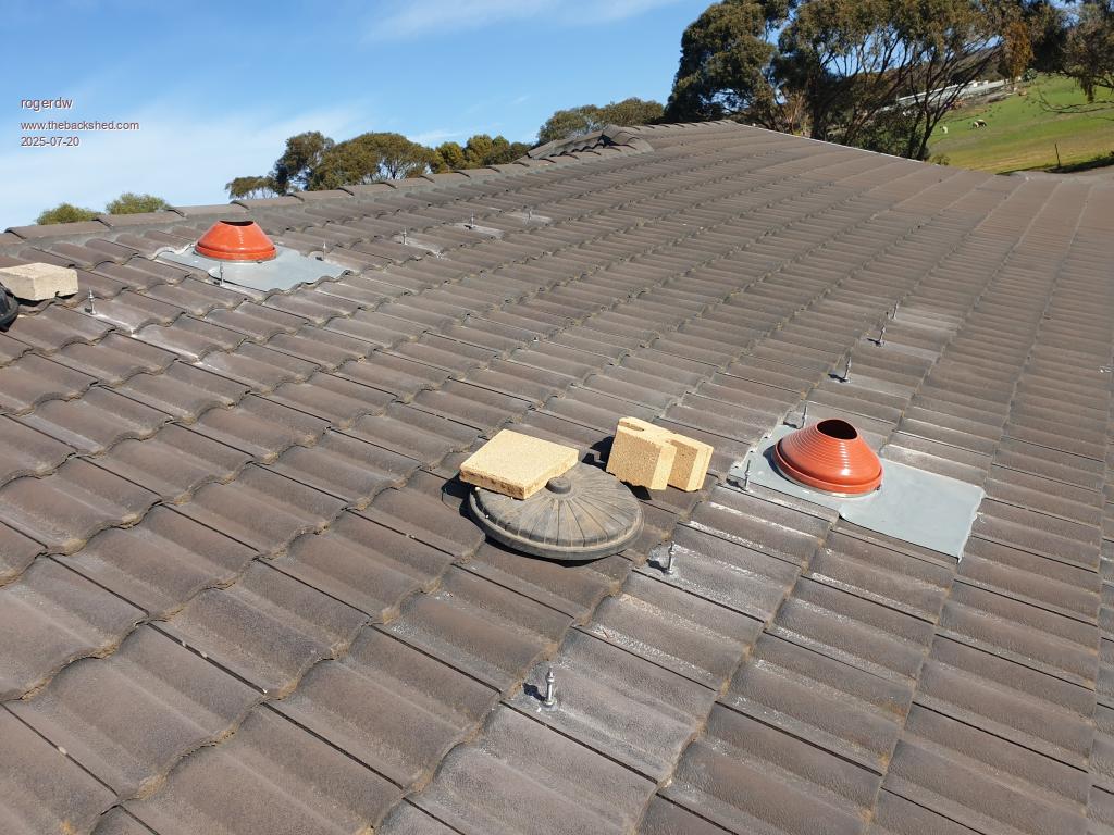

I then fitted the Dektite roof flashings and sealed them up to keep out any rain. Forgot to take a photo of that.
Not really a lot more to do now  ...  just get the beast up on the roof and hope it all lines up. The ducts on the ends that have to go through the Dektites will be fun to fit  ...  but they go on afterwards, one at a time.
Here I'm transferring the markings out onto the roof  ...  not just relying on using my tape measure  ...  not that confident.
Pretty messy work, but they're done now.

Hi Roger, wow they are some seriously large holes in the roof.
I guess you won't be long before the unit goes on the roof now.
At least with tiles flashing is easy to fit.

Yeah, I must have measured everything a hundred times so I had to pull the trigger eventually and make some holes.
Once I decided to spend the money to buy the flashings it certainly got easier  ...  and they fitted well  ...  a lot better than I expected really. The top one was close to the ridgecap and I didn't want to loosen the mortar  ...  so I tapped in a couple wedges, just enough to create a 2 or 3mm gap  ...  then I preshaped the "lead" sheeting on the lower tiles  ...  and it slid in perfectly.

These are the Dektite flashings.

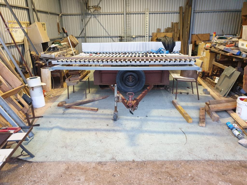

Posted: 12:16pm 27 Jul 2025

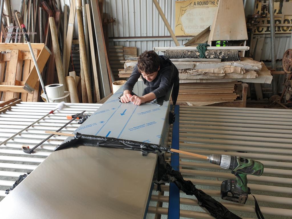

The crane guy hasn't given me a day yet for this week, but I'm as ready as I'm ever going to be.
I drilled out some larger holes, cleaned up where I'd welded the galv pipe and put more paint on them  ...  and a final coat today.
Got my lad out to help me peel off the protective film from the stainless. A few scratches but no one's ever going to be close enough to see them. It looks a lot smaller for some reason without the film, which is a good thing.
I put a bead of silicone around the mating surfaces and covered them with gladwrap  ...  then fitted the endcaps on so the silicone would fill the gaps to prevent air leaks. I need to keep the endcaps off for when I lift it on the roof  ...  and fit them last.
Will be a bit tricky feeding the ducts through the Dektite weather seals, but with some help should be doable.
The silicone seal actually worked better than I expected and when it set, the gladwrap peels off well. I don't think there'll be any air leaks.
I then jacked the whole unit up a couple inches at a time and fitted more chocks each time  ...  then pushed the trailer in under it and lowered it back down.
When I know the crane is coming, I'll tow it around where it's needed to be ready for lift off.
I told him he's going to be famous when he can tell everyone he helped build it. I think the rolling eyes means he doesn't believe me.
Don't dob me into OH&S  ...  it does look kinda bad  ...  but it all went smoothly.
Finally secure on the trailer and ready to be installed. Has been a long road.
Cheers,  Roger

Posted: 07:41am 28 Jul 2025
Hi Roger after looking at the frame on this I am worried when we try and lift it everything may go pear shaped.
With no cross bracing on the lower frame there is a good chance it may buckle at worse when lifted.
So while you still have it on the ground some diagonal bracing should be welded in to reinforce the frame.
If you like I can come over in the morning and give you a hand with it as I do have a few idea's that may help.
Cheers Bryan

Posted: 01:45pm 28 Jul 2025
Hi Bryan, I hadn't considered that.
The centre is very solid with cross members all tied together  ...  so if we lift it closer to the centre, rather than from the extremes, I feel reasonably confident.
But if you're coming into town, I'd still appreciate you looking it over just to be sure.
I am aiming to put some corrugated iron under the tubes  ...  as bright and shiny as I can find  ...  so that would add some rigidity, but had only planned to do that once it is on the roof. Perhaps I should do it before it goes up. I'd better go shopping.
Looks like I have enough time now  ...  I got a call this arvo to say he can't lift it till NEXT Wed arvo!!
Cheers,  Roger

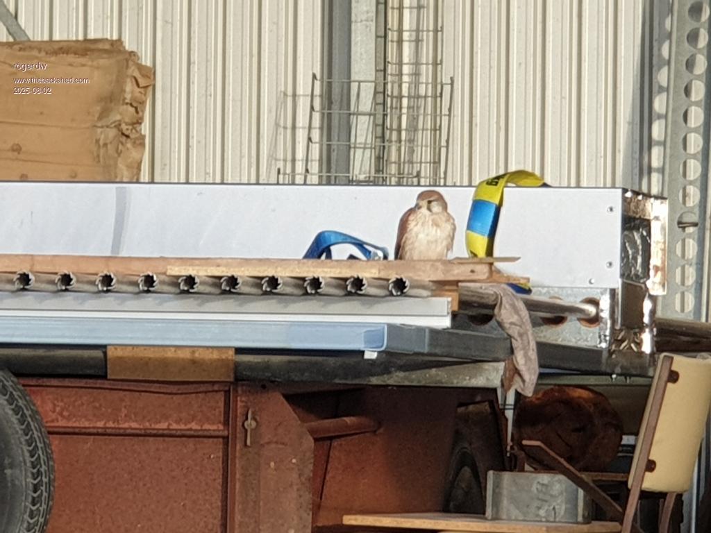

Just for something different, we have a small hawk that has taken up residence in the shed above the heater  ...  and every night I'm out there working it just sits there watching  ...  and eventually sticks it head under its wing and goes to sleep.
When it first arrived, any time I went out there and turned on the lights, it would fly out in a panic  ...  but it's got so comfortable now  ...  I can be grinding and cutting away making a terrible racket  ...  and it just sits there watching.
I quite enjoy its company.
This morning I backed the car out  ...  and there it was sitting on the corner of the heater.
