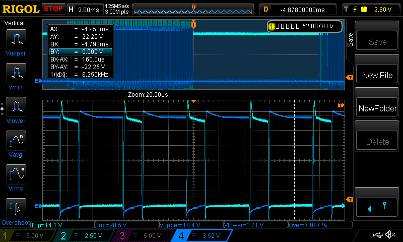

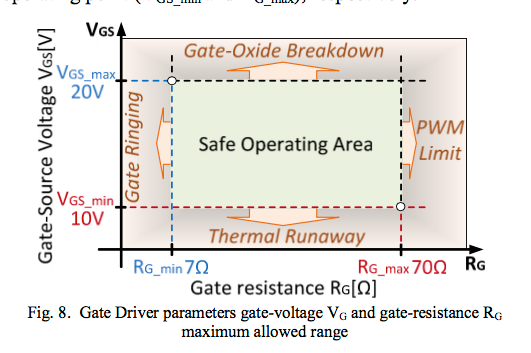

Part 35: Gate voltages and MOSFET longevity
After the recent blowup of the MAdness power board & nanoverter combo,
I am wondering what constitutes OK, best and damaging Gate voltages.
The perpetual victim in these stories is the HY4008.
Specs say +/- 25 Volts, measured with the Drain as "ground".
This is absolute maximum.
But what is best, for long life.
Maybe the +/-25V is the voltage where HY4008 will survive, for a while.
And we need to define "a while" in units of time.
Searching around I found a nice paper looking at MOSFET degradation
in PV applications and I attach a copy.
It's worth a read, in particular for those people here who think Gate voltages
don't matter as long as they are high enough.
Gate-Driver Parameters Variation and Device Degradation in the PV-Inverter .pdf.zip
The important bit:
Here is the high side gate voltage of the Madness power board.
It's sort of standard, at least it uses the 18V Zener for high side supply.
Once all the high side supply does it's voodoo we can see high side gate voltage
peaks at 22.25V
Dark Blue is voltage across the 20K Gate pulldown resistor.
Light Blue is low side Gate voltage.
I checked the calibration of the Blue trace's probe setup.
And it's very good.
Now what I have been working at with the previous 32 things I have discussed here
is how on Earth we can make these Damnned inverters run for a few years as a minimum.
Applying 22.5V to a MOSFET with Vgs specified as +/-25V is skating on thin ice.
In the case of the test Madness powerboard I can easily change the 18V Zener to a 15V
and things get more better. High side Vgs is now about 18V.
I think I will experiment further.

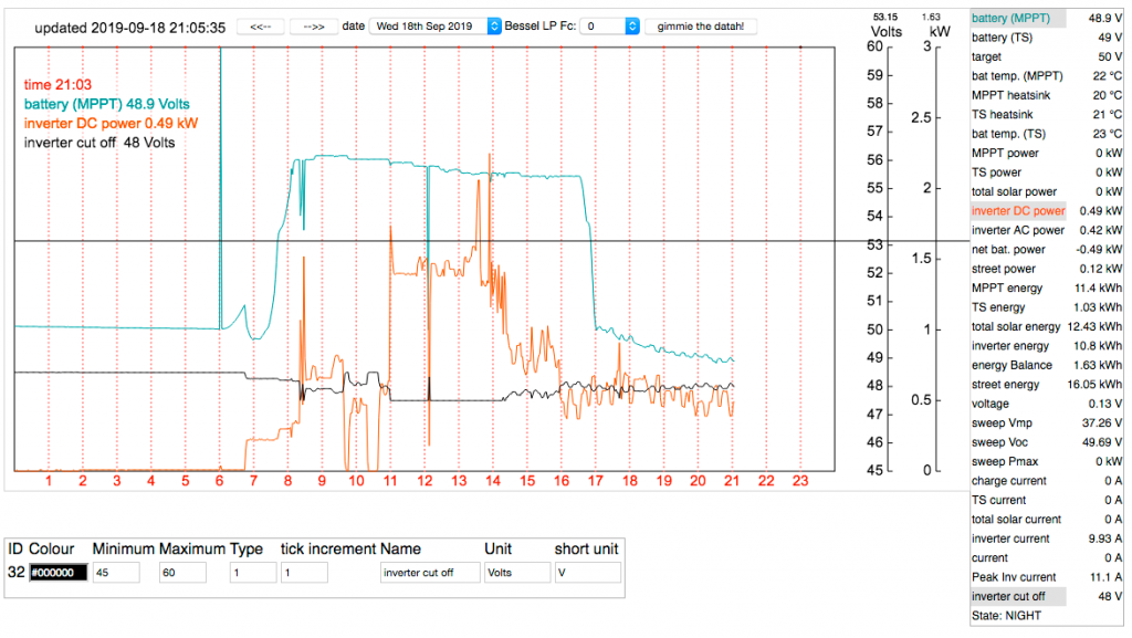

Part 37: Low voltage cut off schemes
Up until now, I have had my inverter automatically stop running when
another controller senses the battery voltage has dropped below a defined set point.
I have Navada REC type SLA 12 batteries. I have determined from plenty of tests
that what I measure as "48.5V" under zero load and after about 8 hours rest means
the battery has about 65 - 70% capacity remaining.
I want to cycle these batteries only about 30% or so, no more.
And the Navada REC type is supposed to be good for extended times at partial states of charge.
Anyway, up until a few weeks ago, I had my system controlling the inverter in such a way to stop it once 48.5V was achieved. Some days I get more sun that others so the run time for inverter might be many hours longer. Or shorter. Some days my son has his mates over for a huge xbox/pizza evening. And I see rather shorter inverter run times for that those nights.
When the inverter stops, the automatic change over relay switches the power source immediately over to street power, and stays there until the battery exceeds 51V the following day during the morning's charge and the inverter automatically restarts.
I found that the LV cutoff of 48.5V was a good "overall" choice. It kept the battery safe from over discharge. But some times there are large loads present, dragging the battery voltage down, even when the capacity is 80%. Then LV cutoff is executed and I did not use the full 30% of charge I could have for that evening.
I know, I know, I should use 1 inch thick copper cable everywhere. I do not.
So there are voltage drops due to high loads.
Now I have a scheme in place that takes the DC current and modifies the LV cutoff voltage, each time the calculations are run (every 2 minutes)
The scheme is:
for DC loads less than or equal to zero Amps, LV cutoff = 48.5V
For loads greater than zero and less than 20 amps, linearly interpolate
LV cutoff from 48.5V to 47.5V, where 0A = 48.5V and 20A = 47.5V
For loads greater than 20 Amps, just set LV cutoff = 47.5V
This permits the system to keep running for longer periods, in my case extending
inverter run times on some nights for 4 hours or more than before. (when the xbox was running hot & my wife was printing something on the laser printer at the same time, the current would be huge and prematurely cause the inverter to stop for the night. Not any more.)
Below is a graph of the battery voltage, DC load due to inverter and the LV cutoff in effect at each of the time intervals.
Black is LV cutoff, Orange is DC power (or current, divide by battery voltage)
Blue is battery voltage.
I like the way this works and so it means I now have to disable the LV cutoff function in the nanoverter, so as to implement it in the raspberry Pi controller code where I have much more control over it's performance. The nanoverter of mine does not have DC current sense capability at this time.
I expect further tuning of this LV cutoff scheme as the seasons change and I learn further how it performs.

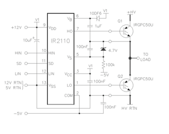

poida
Joined: 02/02/2017
Posts: 1497
Posted: 01:49am 23 Sep 2019

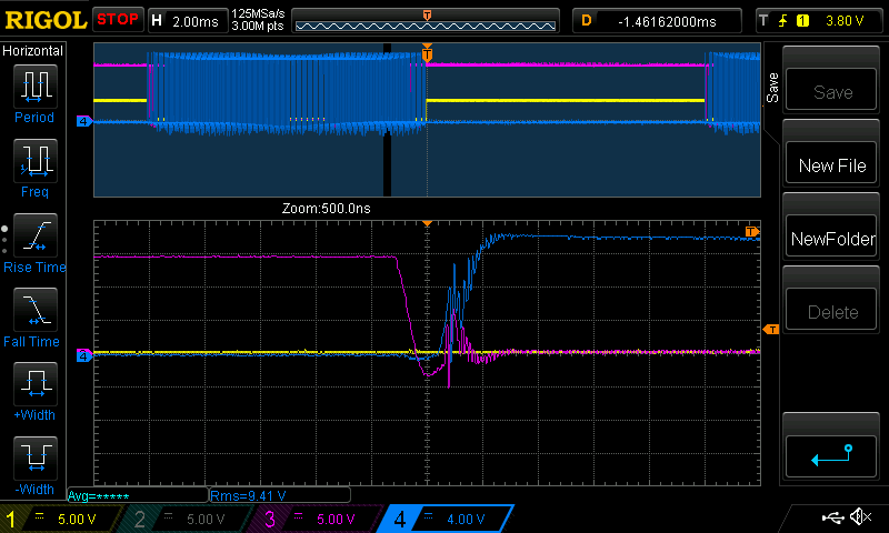

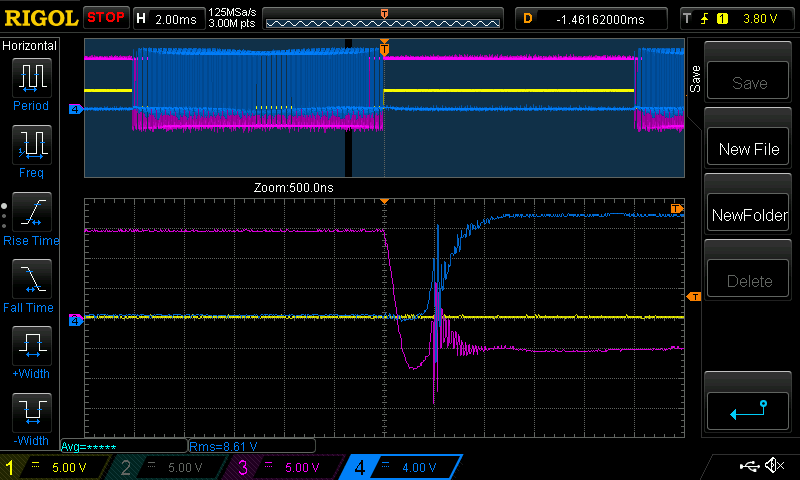

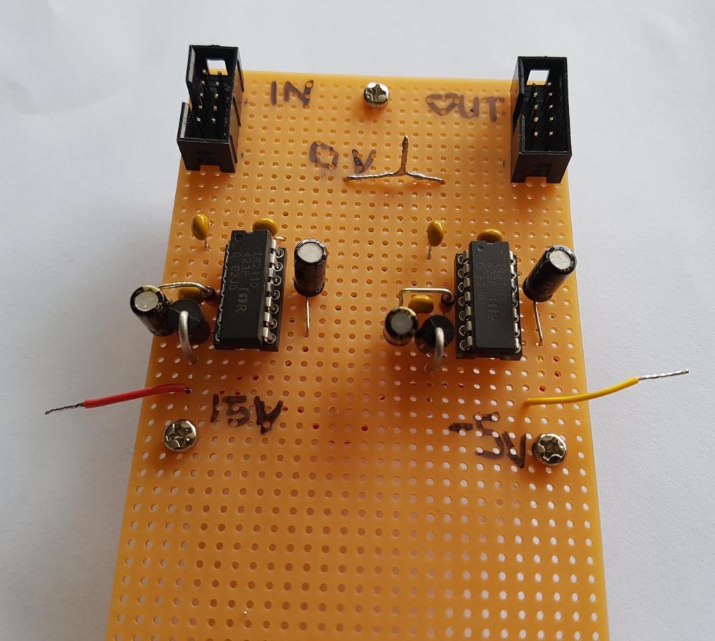

Part 38: Negative DC bias on gate drive voltage
Yesterday I built this:
It permits me to put a -5V bias on the gate drives.
Instead of having "off" as 0V and "on" as 15V, it's now
"off" = -5V and "on" = 15V.
I have been obsessed with shoot through and I want so see if when I pull
the low side gates down -5V, do things improve?
The above board takes the output of the nanoverter (or Madness control board)
and uses those outputs as inputs for a pair of IR2110 ICs.
Simply use the 10 pin ribbon cable plugs. Change over from using it to straight
through takes 10 seconds.
I feed the IR2110 with a -5V offset on the low end of their output stages
and things work well.
I used this circuit exactly. I think I might need something smaller than 100K on
the Pin5 (Vs) but anyway..
obtained from here
I see the worst effects of shoot through at locations near the beginning and end
of the 1/2 cycle of the AC output.
I look at 1.5 ms before the end or zero crossing of the AC output.
Pink is LOW side gate voltage (i.e. Vgs), Dark Blue is HIGH side gate voltage
200 W load, the exact same PWM cycle in both cases.
50V DC supply, standard toroid and choke..
No negative offset:
Bad oscillation of both gate voltages indicating shoot through and uncontrolled short circuit of the DC bus, but only for a short period of time.
Now with -5V offset:
Certainly the oscillation remains. Bugger. It did not cure it.
But it did pull the low side Vgs down 5 V below low side's Source...
The oscillation amplitude has increased a lot and maybe this is due to the inductance of the now 2 lengths of ribbon cable? And ground loops?
Anyway, it's food for thought and that means I'm going for a walk and a think.

At the point of hi side turn on, the low side mosfets are subject to very fast rise time drain voltages that get reflected back across the gate input by the miller effect capacitance within the mosfet.
Now the low side gate circuit has an effective short across it, but located some distance away at the driver chip, ie at the end of an inductive length of wire, thus the extensive gate ringing you observe on your scope.
To minimize this, place the gate driver close as physically possible to each mosfet, this keeps the lumped inductance down; also add a small resistance into the circuit to act as a damper to the oscillation currents reflecting back and forth between the gate and driver (1-5r).
None of this is easy to retro fit to an existing layout unfortunately; however if you arrange for the low side mosfets to switch at the 50 hz rate, then add a small capacitance (10,000pf) across the gate to source (distributed between the number of mosfets in parallel); the effect is to partially absorb the very short ringing spikes, noting that the driver chip will have to work harder to charge and discharge this extra capacitance and will slow the turn on\off a little (should be ok at 50 hz though), depends on the driver chip being used.
Welcome to the world of RF circuit engineering....
Mike

Solar Mike
Joined: 08/02/2015
Posts: 1255
Posted: 11:39am 25 Sep 2019
You should be able to reduce the high side ringing by fitting a suitable snubber RC across the Drain\Source, google will tell you how to work out the RC values. You can measure the ringing frequency on your scope.
Reducing that may also reduce the reflected ringing on the low side gate circuit.
Mike
wiseguy
Joined: 21/06/2018
Posts: 1326
Posted: 01:37pm 25 Sep 2019
Poida, what value gate resistor are you using in series with the driver ? If too high, fast dvdt on the drain will/can try to turn on the FET briefly. As Solar Mike says keeping series resistance and inductance loops as short as possible definitely helps.
It looks like the upper side gate drive voltage is turning on the upper side FET, this pulls the lower side FETs drain rapidly high and cdg couples this back to the lower FET's gate causing the shoot through glitch.  Having a gate clamp transistor right at the gate or lowering the gate drive inductance/resistance should minimise the effect.
Is there just one FET in each of the bridge legs - the oscillation you are getting looks very similar to what I have seen before when there is more than 1 FET per leg.
I forgot to mention, if you are not using a diode across the gate resistor (cathode facing away from the gate) it can help a lot by being a much lower impedance when the driver is driving the gate off, to counteract the parasitic dvdt turn on. In theory it should clamp the gate at 0.7V with no resistor in series with the diode. However circuit inductance and resistance can still work against you. Also with no resistor in series with the gate diode, the FET turn off speed may be increased to the point where it starts to become problematic too, so some juggling of values may be needed.
Edited 2019-09-26 10:25 by wiseguy

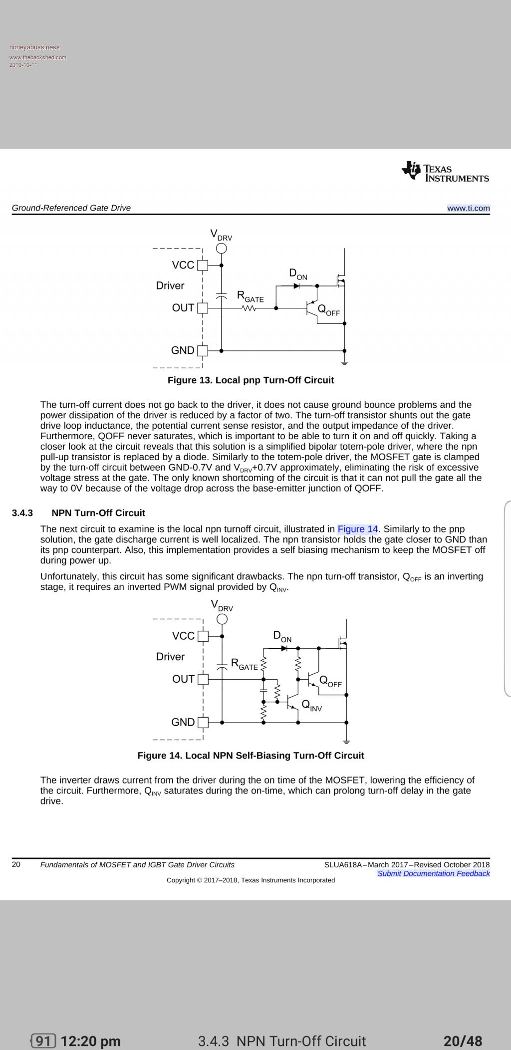

Oh and maybe something like this for EACH mosfet, figure 13.. may help dv/dt as it shorts it at the mosfet instead of back to the driver...easy to implement in current guise as its a diode and a pnp...
I think it works !!

Ok , pics are not working for some reason,  its figure 13 on Texas Instruments app note SLUA618A... it will pull down individual mosfets to ground AT the source pin, so as to avoid the driver to mosfet gate inductance... just a thought...
