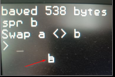

HDMI/USB/2350 RC23  default options
I must be doing something wrong but it`s so simple I do not see what ??
Print @(0,0) "a"
Sprite read 1,0,0,8,12
Print @(0,0) "b"
Sprite read 2,0,0,8,12
Sprite show 1,50,50,1
Sprite show 2,90,90,1
Sprite SWAP 1,2
Pause 1000
[9] Sprite SWAP 1,2
>Error: New buffer already displayed

Swap swaps a hidden sprite for a showing one. It is not a two way thing

  matherp said  Swap swaps a hidden sprite for a showing one. It is not a two way thing
Understood.
Result I am observed at first was merge, not swap.
Print @(0,0) "a"
Print "spr a"
Pause 1000
Sprite hide 1
Print @(0,0) "b"
Print "spr b"
Sprite show 2,80,50,1
Pause 1000
Sprite hide 2
Pause 1000
Print "Swap a <> b"
Sprite SWAP 1,2
End
This made me confuse and I dived into old forum records.
It seems manual is somehow incomplete/unclear, as optional [,orientation] is not explained
Sprite SWAP 1,2,4  <-- makes it swap correctly
0,1,2,3 MERGE (!) 2 to 1 with orientation
Another observation was - after Sprite SWAP 1,2 I can SPRITE HIDE 2 which is not displayed  but I can not SPRITE HIDE 1 which is displayed.
