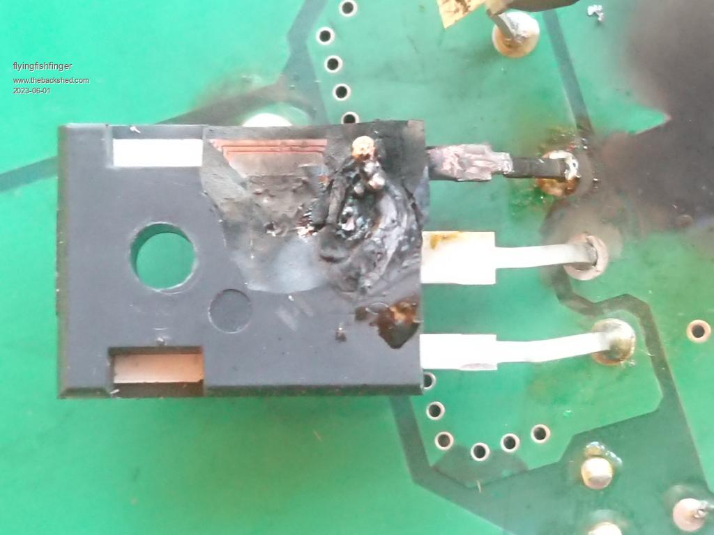

  flyingfishfinger said  Well, here's a fun one. I blew up some diodes! My mistake actually, I feel silly.
The MPPT has been running great for a year on 2 panels (OC something like 90V) but I really want 3 panels in series (-> 130V). I had upsized the switching transistors to FDH055N15A as planned (150V).... but I forgot to swap out the "diode" transistors and stuck with HY5110 (100V)
Attached 3 panels, at the 60 second mark the thing quite spectacularly exploded.
Sadly I think there is more damage than just this transistor, there is some charring around the FOD3182's output pins as well, but the 12V output of the isolated regulator is still present. Will have to debug further when I have some time.
Question for the group: What transistor would you recommend as a diode that will handle 150V properly? Should I just use two FDH055N15A? EDIT: Looked through the thread and saw suggestions for Vishay VS-60EPU02-N3 or ST STTH6002C.

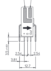

Question?
For current sensor is it posible to use lem ltsp 25-np?
This is current output hall, not voltage out. I have few of them.
Pozdrav iz Srbije
poida
Joined: 02/02/2017
Posts: 1497
Posted: 12:15am 02 Jun 2023
I think you can use these but you might have to mount it
in a way that permits you to fit a resistor across
M and ref
the pcb is designed for the 3 pin voltage output type so it's not ready
for the 4 pin current output version.
One of my mppt has the LEM sensors mounted upside down, with the pins pointing UP
and I have 3 wires leading from pins to the pcb.
It's not pretty but it works fine.

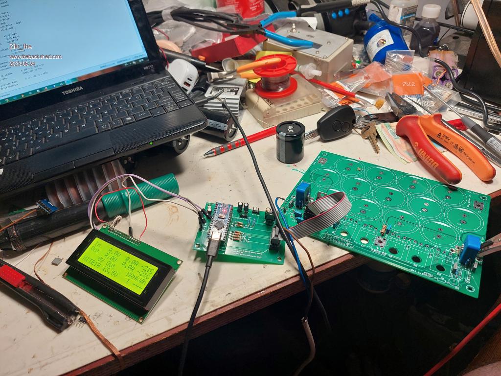

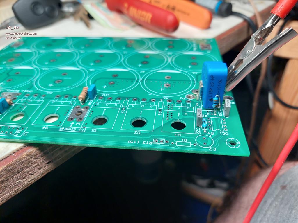

Ziki_the
Joined: 13/04/2023
Location: Yugoslavia
Posts: 39

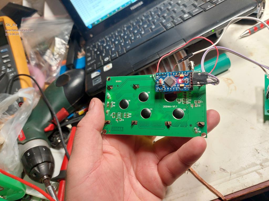

Posted: 08:25pm 23 Jun 2023
So i have done a little work on one board.
Pro mini clone is used for display board.
For current sensors, do i need to put one more wire in the midle hole?
Just this work for now.
Pozdrav iz Srbije

Ok, I rebuilt the blown parts. Turns out the exploded diodes took 2 out of my 3 FETs with them... now it's back to working.

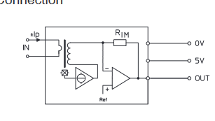

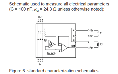

poida
Joined: 02/02/2017
Posts: 1497
Posted: 10:23pm 11 Jul 2023
Zikki,
I think you have it connected up OK.
The 5V and Ground are lined up and soldered in, the "O" and "Ref" need
a resistor.
If it works then no need to do anything else.
(for those who might be wondering)
the 4 pin LEM sensor schematic is
and the 3 pin sensor is

Progress report: Fixed up my unit and it runs at 1000W with no issues so far - the higher input voltage (130V) is also handled nicely with the new diodes.

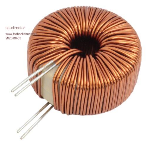

soudirector
Joined: 14/05/2023
Location: Nigeria
Posts: 26
Posted: 11:36am 03 Aug 2023

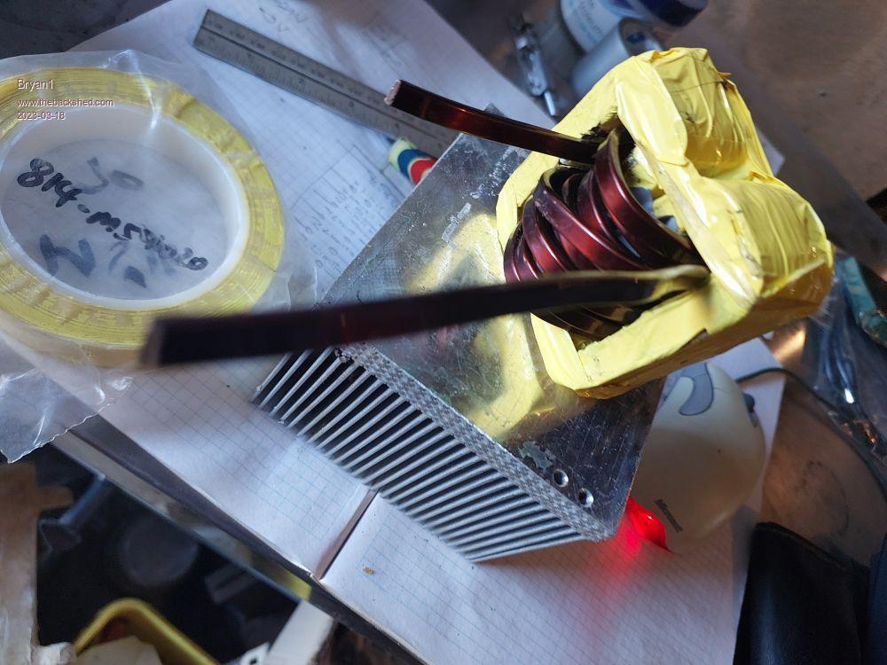

  Bryan1 said  G'Day Guy's,
            Well the choke is wound
got 10.5 turns using new 6x3mm enameled wire and I do have another length so I can do a join and solder it so I can get those few more turns if needed.
I live in the Adelaide Hills so for SA guy's a drive up the hill will save postage, those M4 connectors haven't even left to get on the slow boat so still no ETA.
Wiseguy if you want I do have some 6mm, 14mm, 20mm and 25mm rolls so you can have one of each and 2 off 20mm if you like.
Cheers Bryan
I was wondering if this can work without issues.
how times flies
Ziki_the
Joined: 13/04/2023
Posts: 39
Posted: 04:12pm 03 Aug 2023
Look like ATX choke.
Maybe 5pcs stocked and some thing like 15-17turns with multply coper wire, litz..
My sugestion..
Pozdrav iz Srbije
soudirector
Joined: 14/05/2023
Location: Nigeria
Posts: 26
Posted: 09:41am 09 Aug 2023
  Ziki_the said  Look like ATX choke.
My sugestion..
this inductor is for mppt not ATX choke
