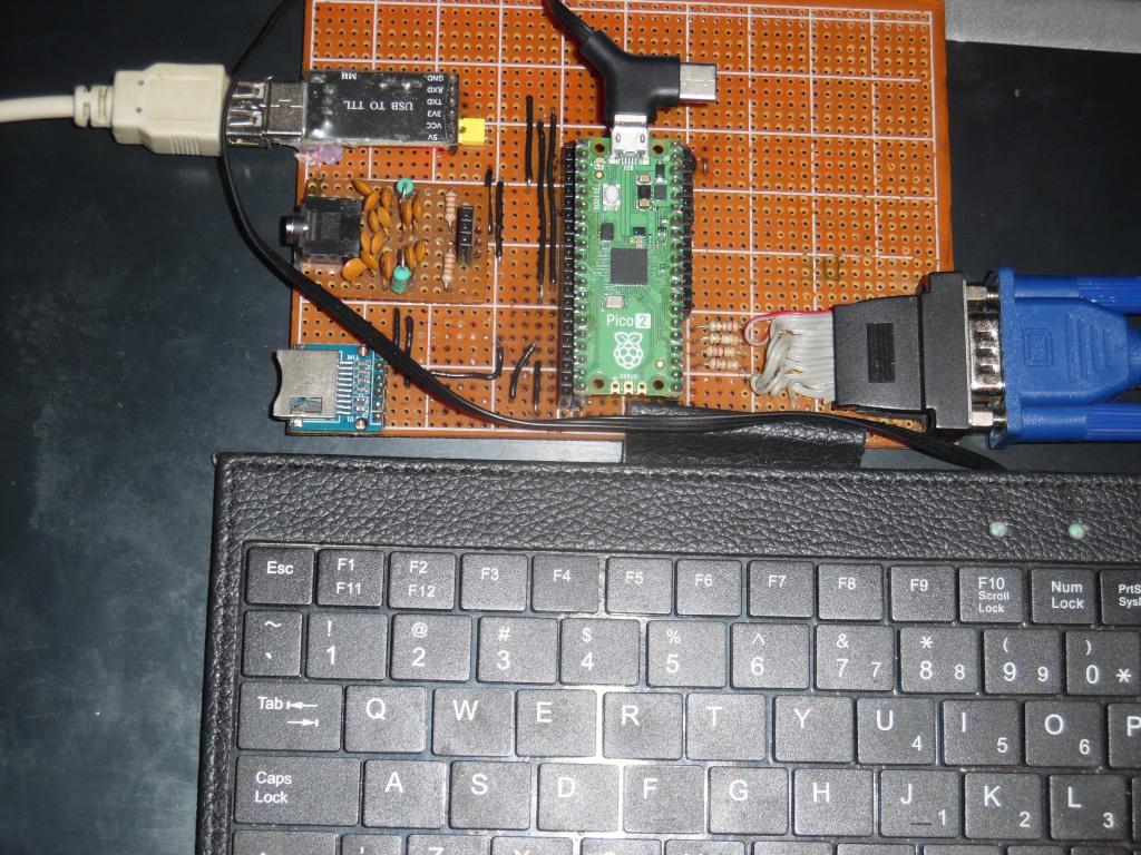

looking at vga pico and it's set higher. thinking of using it again. vga lets you input sound via 3.5 coax. hdmi don't
 Connected to COM9 at 115200
option list
PicoMiteVGA MMBasic USB RP2350A Edition V6.00.02b8
OPTION FLASH SIZE 4194304
OPTION COLOURCODE ON
OPTION KEYBOARD UK, 0, 0, 600, 150
OPTION CPUSPEED (KHz) 378000
OPTION SDCARD GP13, GP10, GP11, GP12
OPTION AUDIO GP0,GP1', ON PWM CHANNEL 0
>what's better hdmi or vga?
Edited 2025-05-21 06:54 by stanleyella
Posts: 9242
Posted: 09:30pm 20 May 2025
No MMBasic Pico system lets you input sound. There is no A/D converter in the Pico. It might be that your monitor has an audio input that only works when VGA video is being used, but that's a different thing. You can get VGA-HDMI converters that have an audio input, but you are stuck with VGA video modes then. DVI doesn't carry audio, HDMI does. That's only one of the differences. The Pico provides DVI, not HDMI.
The Pico firmware is now optimised for DVI/HDMI displays and you'll almost always get better performance using that rather than VGA. The DVI displays are much more flexible.
Posts: 2807
Posted: 11:03pm 20 May 2025
using vga for lisajours1.bas as ref with vga and and mode 3 I found a while back. luvvin it.so spent time making hdmi 2350 ... after going back to vga is it bad on 2350a compared to hdmi? both usb 2350
vga seems faster than hdmi..?
