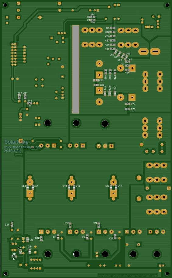

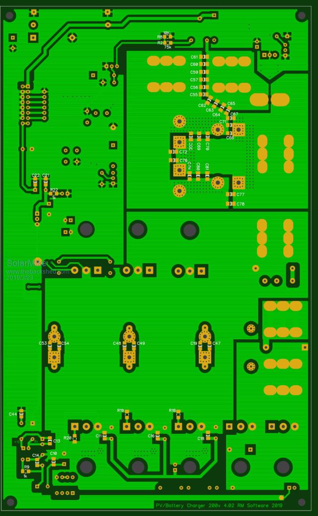

Solar Mike
Joined: 08/02/2015
Posts: 1255
Posted: 04:21am 23 Mar 2019
It's been awhile getting this project off the ground, my initial intention was to build a controller that would handle 100 amps or more charge into a 50v bank, built using modular boards that plugged together. However other more pressing projects intervened and now the humongous mppt controller idea has been sidelined for awhile.
My more immediate requirement is something smaller that will accept up to 200v PV and output 60 or so amps into the bank. From a spin off from another project have designed new pcb's, using a single power mppt pcb and a controller cpu pcb linked by ribbon cable. I want the size to be smallish and not limited to any particular CPU. My idea is to bolt 4 of these units into a low profile metal box with large door, so 4 PV arrays can be connected.
The main power board is 2 layer 2oz copper, this sits atop a large finned heat sink, with the mosfets bolted to under the pcb using 3mm bolts and insulation washers. The large holes allow allen key access.
Synchronous rectification has been used in the buck stage using a dedicated control chip. The main switching mosfets each have high current buffer drivers and connect to the cpu board by a high speed opto-coupler.
Intended switch frequency is 100Khz, with the cpu having secondary control of the PWM to effect the MPPT and charge function.
PCB sizes 243 x 150mm, the EasyEDA gerber viewer I'm using doesn't show the top silk layer very well, resulting in some components with no outlines (Big Caps) they all show correctly on the JLCPB cart page ??
Top:
Bottom:
More to come...
Mike

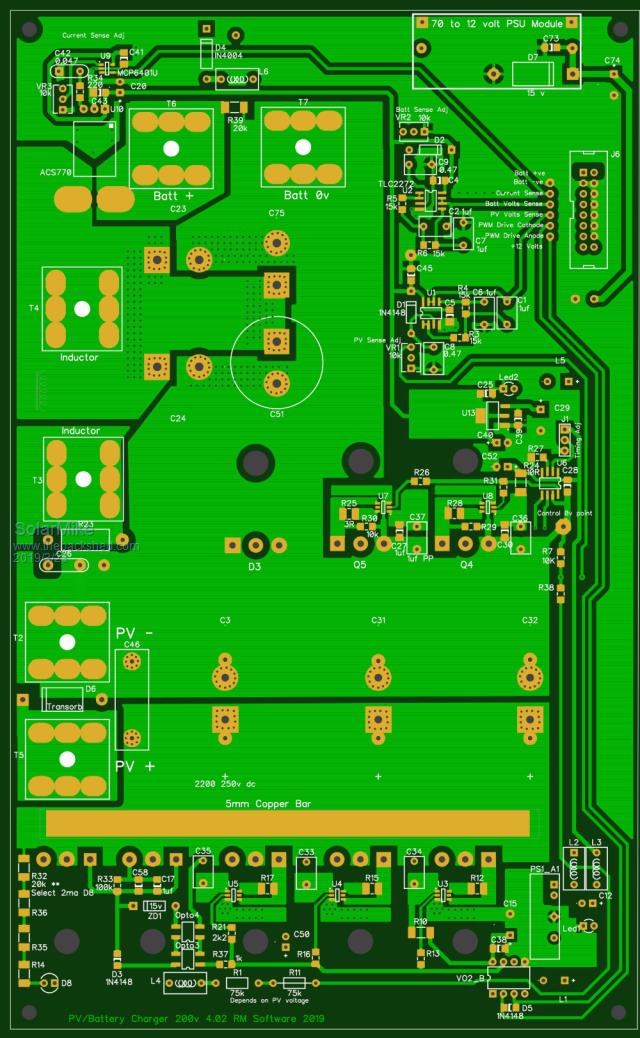

Solar Mike
Joined: 08/02/2015
Posts: 1255
Posted: 07:41am 24 Mar 2019
  azhaque said   Just a quick comment. Don't you think some kind of fan control circuitry is needed here. I haven't been able to locate any on the PCB image.
Fan control and other intelligence is set on the CPU driver board that plugs in via the ribbon cable.
I have a PIC cpu board from another project that will be used to test it, it may be possible to cram a cpu controller on the main board as there is a lot of free space. Others may want to use an Arduino or similar, easier to do on a separate pcb.
However prob wont need a fan, heat calculations work out about 30-40 watts in the electronics + some heat in the inductor with 3KW output power.
Mike
Solar Mike
Joined: 08/02/2015
Posts: 1255
Posted: 10:53am 24 Mar 2019
Made changes to pcb to allow soldering of additional 5mm sq copper rails to pcb in areas of high current, existing tracks should be good for 60 amps. but you know how we want to push things a bit. The mosfets are good for > 300 amps, so .....
Mike
