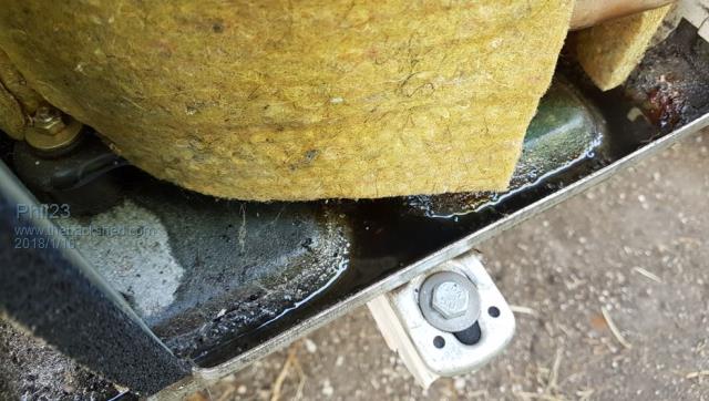

Achieved a big reduction in base load today....
The 8kW Mitsubishi Split System is now out of the equation....
Gas & oil are probably as important as smoke in making this sorta sh*t work....
Still hovering in around the 28°C mark for the next few days,
but expecting 37-37° come the weekend; not a happy scenario.
Phil.
Posted: 10:24am 16 Jan 2018
So Phil, what am I looking at on that picture you posted above?
Posts: 5203
Posted: 10:36am 16 Jan 2018
She sprung a leak?

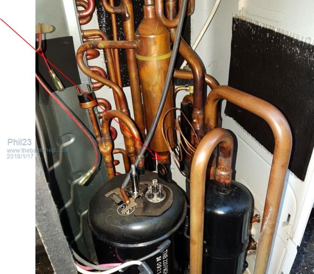

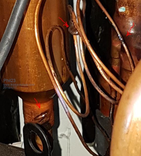

Posted: 07:59pm 16 Jan 2018
  Madness said   Is that a Mitsubishi Electric or Heavy industries,
Mitsubishi Electric, & turns out I bought it in March 2006.
Tracked the leak down to the capillary tube rubbing against the bottom of the "fat thing".
Figured at 12 years it would be a scrap/replace job, but the Solar/Fridgie I've had a bit to do with lately reckoned a repair was worth a try.
Dropped in at 5:00 yesterday, sweated the leak & other thin patch & pumped it back down.
Still holding the vacuum this morning, so looks like a win.
Just need to wait for more 410a to arrive to have it back in order.
I know a lot in there industries, & they predominantly have the "5 years old; Replace it" attitude.....
I'll be more than happy to not cough up that $2500 right now, even if it only makes another year.
Phil.

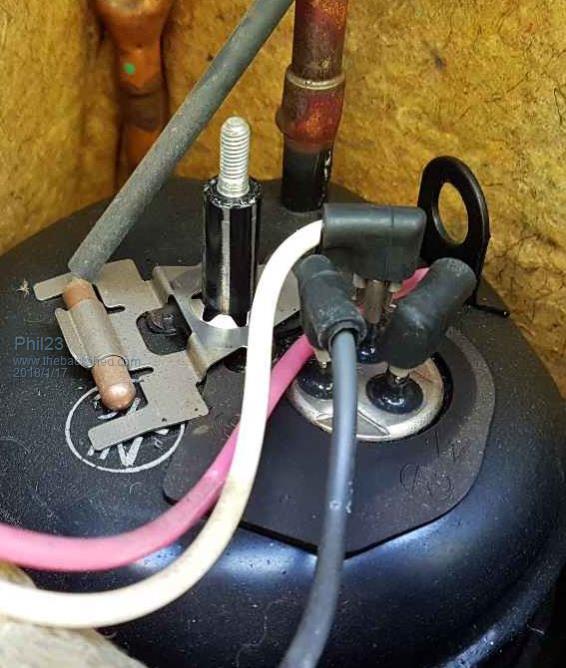

Saddest think about both my A/C's is they have a bit too much standby usage.
Mostly attributed to the sump heater to keep the gas out of the oil.
Not sure it can be disconnected, of the temp that needs maintaining.
The Mitsi just has 3 wires to the compressor, & haven't check out the schematic that I spotted under the lid.
And yes, the capillary tube would be well worth checking in all cases. It's probably been rubbing there it's entire life.
Phil.
