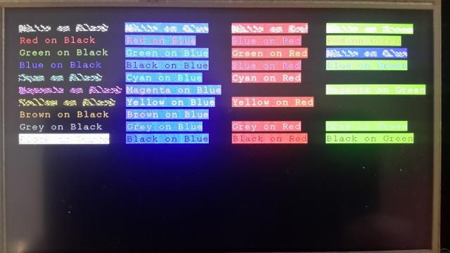

I have tried using the new speed related drivers with no luck.
I have moved on to the 7 inch just to see if it might have been my 5" display causing the problem, again no change.
Here is a screen shot of some "text" tests, quality from my Samsung Tab not the best.
'Testing different text colours on different colour backgrounds for the Armmite
'Using 7 inch ssd1963 TFT with OPTION LCDPANEL SSD1963_7_16,RL
cls
text 20,20,"White on Black",,2,,rgb(white),rgb(black):text 220,20,"White on Blue",,2,,rgb(white),rgb(blue)
text 420,20,"White on Red",,2,,rgb(white),rgb(red):text 600,20,"White on Green",,2,,rgb(white),rgb(green)
Text 20,45,"Red on Black",,2,,Rgb(red):text 220,45,"Red on Blue",,2,,rgb(red),rgb(blue)
text 420,45,"Blue on Red",,2,,rgb(blue),rgb(red):text 600,45,"Red on Green",,2,,rgb(red),rgb(green)
text 20,70,"Green on Black",,2,,rgb(green):text 220,70,"Green on Blue",,2,,rgb(green),rgb(blue)
text 420,70,"Green on Red",,2,,rgb(green),rgb(red):text 600,70,"White on Blue",,2,,rgb(white),rgb(blue)
text 20,95,"Blue on Black",,2,,rgb(blue):text 220,95,"Black on Blue",,2,,rgb(black),rgb(blue)
text 420,95,"Blue on Red",,2,,rgb(blue),rgb(red):text 600,95,"Blue on Green",,2,,rgb(blue),rgb(green)
text 20,120,"Cyan on Black",,2,,rgb(cyan),rgb(black):text 220,120,"Cyan on Blue",,2,,rgb(cyan),rgb(blue)
text 420,120,"Cyan on Red",,2,,rgb(cyan),rgb(red)
text 20,145,"Magenta on Black",,2,,rgb(magenta):text 220,145,"Magenta on Blue",,2,,rgb(magenta),rgb(blue)
text 600,145,"Magenta on Green",,2,,rgb(magenta),rgb(green)
text 20,170,"Yellow on Black",,2,,rgb(yellow):text 220,170,"Yellow on Blue",,2,,rgb(yellow),rgb(blue)
text 420,170,"Yellow on Red",,2,,rgb(yellow),rgb(red)
text 20,195,"Brown on Black",,2,,rgb(brown):text 220,195,"Brown on Blue",,2,,rgb(brown),rgb(blue)
text 20,220,"Grey on Black",,2,,rgb(gray):text 220,220,"Grey on Blue",,2,,rgb(gray),rgb(blue)
text 420,220,"Grey on Red",,2,,rgb(gray),rgb(red):text 600,220,"Grey on Green",,2,,rgb(gray),rgb(green)
text 20,245,"Black on White",,2,,rgb(black),rgb(white):text 420,245,"Black on Red",,2,,rgb(black),rgb(red)
text 220,245,"Black on Blue",,2,,rgb(black),rgb(blue):text 600,245,"Black on Green",,2,,rgb(black),rgb(green)
The lower left below "Grey on Black" is "Black on White" and resembles top left "White on Black", not clear on photo.
It's weird certain colours react differently.
Trevor.

Just a thought, am I the only one getting this problem with the Armmite & TFT?
Anyone??
Trevor.

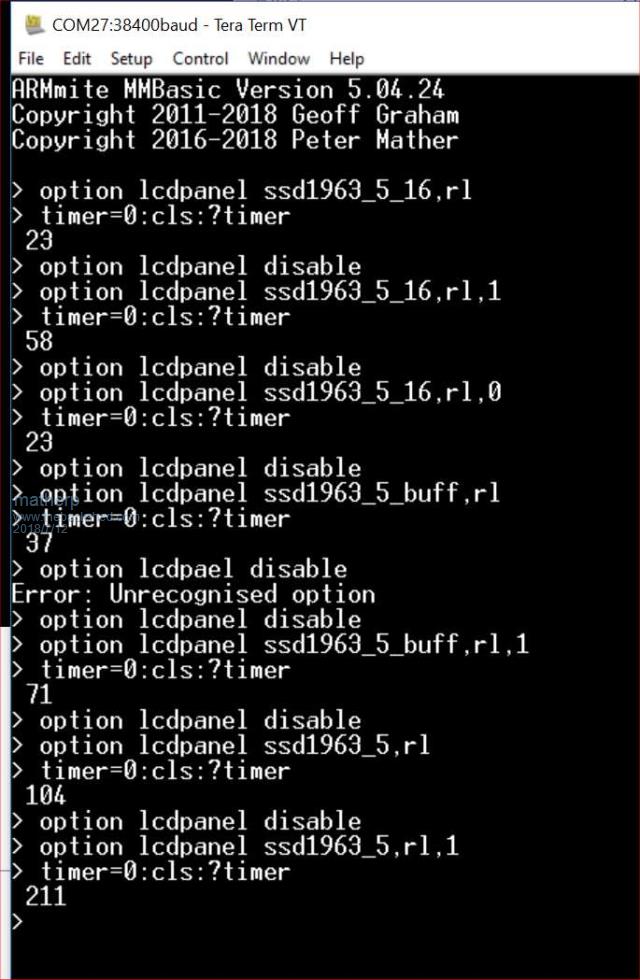

Posts: 11882
Posted: 03:02pm 12 Jul 2018
  Quote  Just a thought, am I the only one getting this problem with the Armmite & TFT?
No there is an issue but I'm certain it is electrical rather than code:
My original results with your test program:
option lcdpanel ssd1963_5_16,rl,1 - perfect
option lcdpanel ssd1963_5_16,rl,0 - Corruption of white-on-black and black-on-white otherwise OK
option lcdpanel ssd1963_5_BUFF,rl,1 - perfect
option lcdpanel ssd1963_5_BUFF,rl,0 - Corruption of black-on-white otherwise OK
option lcdpanel ssd1963_5,rl,1 - random small sections of background missing (typically 2 chars per run)
option lcdpanel ssd1963_5,rl,0 - random small sections of background missing (typically 3 chars per run)
BUT
I then put a 47pF capacitor between WR and GND on the display and the results for all the 16-bit driver versions were then perfect but the 8 bit results were worse
Basically I think we need a daughter board to get a good connection to the display. The signals from the STM32 seem to "ring" more than those of the PIC

Are you introducing WR wait states or are you slowing down the processor in the ...rl,1 drivers?
Trevor.

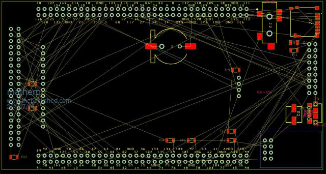

Posts: 11882
Posted: 06:24pm 13 Jul 2018
Here is a first cut (as yet unrouted) for a Nucleo-144 daughter board. It supports:
Battery for RTC
SSD1963
ILI9341
ESP8266 module connected to COM3
OV7670 camera I/F
I2C pullups
Micro-SD card
Jack socket for DACs
Micro-USB socket for 5V input power (use Pi3 PSU or similar)
Comments and ideas appreciated
  Quote  Are you introducing WR wait states or are you slowing down the processor in the ...rl,1 drivers?
Much more complicated than that
You can access a GPIO port by writing to the complete port (ODR=output data register)
GPIOE.ODR = 16-bit number
or you can write to a pair of registers that either set one or more bits
GPIOE.BSRRH = 16-bit mask (any bit in the mask sets the IO bit)
or clear one or more bits
GPIOE.BSRRL = 16-bit mask (any bit in the mask clears the IO bit)
To set an individual bit using the first method you first have to read the register change the bit and then write the complete register back (read-modify-write). C does this for you with instructions like:
GPIOE.ODR ^= GPIO_PIN_4; GPIOE.ODR ^= GPIO_PIN_4; //Toggle pin GPIOE4 off then on
The second method is a single atomic instruction and is much faster
GPIOE.BSRRL = GPIO_PIN_4;GPIOE.BSRRH = GPIO_PIN_4; //Toggle pin GPIOE4 off then on
The fast version of the drivers use the BSRRL and BSRRH registers to toggle WR.
The slow versions use the ODR
I have a slight suspicion that mixing the two can cause problems in that the BSRRL, BSRRH, and ODR registers may be out of synch for short periods in particular circumstances but I'm unable to prove it.
Edited by matherp 2018-07-15
