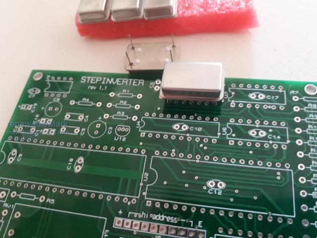

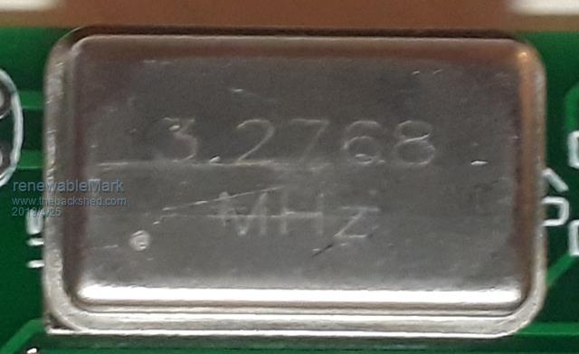

Just going over all the parts that came in.
Is this crystal correct it only has 4 pins, but the holes on the board look like the others don't go anywhere anyaway.
3.2768mhz dip14 but it only has 4 pins
Cheers Caveman Mark
Off grid eastern Melb
Posted: 05:42am 25 Apr 2019
Yes Mark, that is all correct. It uses the 14 pin package size so ten of the middle holes are not used. Make sure it goes in the right way around !
With the writing on the can the correct way up, pin one is the bottom left hand corner.
Pin one sometimes has a dot, and the corner of the metal can next to pin one will be "different" to the other three corners.
If you are still not quite sure, pin 7 (of the 14 pin footprint)lower right hand pin is connected direct onto the metal can.

Posted: 10:57am 25 Apr 2019
Mark, it looks like that crystal oscillator is the wrong way round in your picture.
I had the same problem finding pin 1. The 'collar' of the metal can has 3 rounded corners and one square corner which is pin 1. The little covered 'window' is on the left then when you look at the board as in your picture.
You have 5 crystals there? I guess you do not trust them . Now I know where I can get another should I need one .
renewableMark
Joined: 09/12/2017
Posts: 1679
Posted: 11:47am 25 Apr 2019
Yeah bottom left has a square corner.
Looked all over for them, finally found them on ebay in a 5 unit deal
here
Cheers Caveman Mark
Posted: 01:26pm 25 Apr 2019
That was a lot cheaper than the single unit I got from More-Suns Electronics Co. which was $US 15.07. Mine, however, has a much better accuracy, 0.1ppm against your 50ppm.
I had to search a lot too to find that one, never found anything on ebay like those you found.
I fitted mine on a IC socket, perhaps a good idea for yours too as you then can select which one gives the closest frequency to 50Hz if you have something to measure that.
Your oscillators don't seem to have that little 'window' on the top, I think there is a trimming adjustment behind it.
In case you are still searching, the little caps that go inside the IC sockets are available from RS in a 25 piece pack. Most other caps are too tall to fit under the IC's.Edited by Tinker 2019-04-26

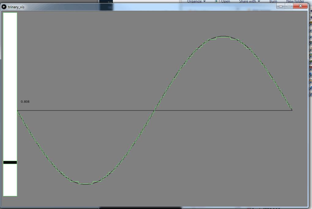

As an aid to visualising the stepped sine shape, I made a small demo program.
It runs under Processing. Just load it and run, use the up/down keys or drag the black rectangle with the mouse to change the magnitude of the sinewave.
( get processing from https://processing.org/download/)
Maybe this will help some here to understand how subtle the changes to the times when each of the 4 inverters switch on high or low or short, when maintaining as close a match to the required sinewave shape and other aspects of the approximation.
The uploaded image is distorted for some reason. I tried 3 times, 1x png, 2x gif to get
a decent representation but no luck.
2019-04-26_120826_trivis.zip Edited by poida 2019-04-27

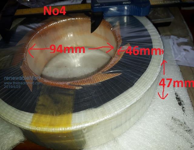

It's been School holidays so we took the little demon on a couple of caravan trips.
Back onto it now.
I spoke to Warp about the torroids and decided to use the ones I have here since they are already stripped, and may as well use what I have on hand.
So No3 will use a 2kw core
No4 will use a 1500w core
ID 94mm
ID to OD 46mm
Height 47mm
All the bits for the warp control card are in and have ordered the 8 driver boards and their components.
I should start a different thread for that build, but the torroids will be a common use for either build.
Poida how are you going with the torroids?Edited by renewableMark 2019-04-29
