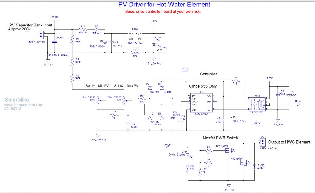

For Dave and others whom want to build the most basic version, I have drawn up a circuit and despite some reservations on how dangerous it is, will also make a pcb design to match. So it is strictly build at your own risk.
If anyone sees any obvious errors please let me know.
Note this circuit has not been tested live; I have stipulated a Cmos 555 timer chip here as it has a much higher input resistance, it wont work if a normal 555 is used. The optical mosfet driver can be substituted for others of similar spec.
Mike

I am a bit lost, will assume it is my lack of understanding of the solar cell behavior.
The input to the circuit, the approx 260 V is used to set the min 4V and max 8V points for the 555 it is here I get lost. the 260V is that not floating "slightly" up and down depending on solar irradiation?
OR
Is the circuit actually working in a way that it stabilizes the input to approximately 260 V with the shown values.
For the pcb: would there be enough room to also replace the potentiometers with say a combination of 3 or 4 selected resistors. For long term use I have from my industrial work time become suspect of such devices.
Nice for quickly set up final tuning, but as I was on the receiving end of being called 3 am to come and fix the !@#$ thing I became a convert to fixed resistors. My boss had a laugh, even we had picked mil spec pots. I learnt something the hard way.
Again since I do not entirely understand if the pots will be used 'frequently' the fixed resistors may be a dumb idea.
If it already has been explained clearly in previous posts, just tell me so, I have read all the pages over time but forget too easily.Edited by plover 2019-07-13

Pots typically adjusted once or twice then left, should be reliable, the ones specified are completely enclosed by a plastic housing, ie safer, because someone will zap themselves setting it up, unless you have a ceramic shaft tipped screwdriver set. once setup by all means replace them with fixed values.
The switch voltage points are set by the 555, 1/3 and 2/3 supply voltage, adjust the pots to set correct resistance ratio to suit whatever PV mppt voltage you are using. Upper limit trips mosfets on, dumping element across the 10,000uf cap bank, lower limit turns them off at some lower discharge voltage; enabling a recharge and cycle repeats; pumping high current pulses into the element.
Note this is a "poor mans" mppt, the correct set points are for one mppt setting, in reality this setting varies around with temperature and sunlight level, so it doesn't track. The other version I'm building does track and so will be a true mppt, but needs cpu etc so is more complex.
No I don't know if a true mppt would be much better and worth the added complexity..possibly not.

  plover said   I am a bit lost, will assume it is my lack of understanding of the solar cell behavior.
OR
Is the circuit actually working in a way that it stabilizes the input to approximately 260 V with the shown values.[/quote]
The upper and lower voltage thresholds depend on how many series connected solar panels you plan to use, and the maximum power voltage of the combined solar array.
The upper threshold is set just above the max power voltage, and the lower threshold just below the max power voltage. The system then ramps up and down alternately between the two set points, keeping the voltage on the solar panels swinging up and down THROUGH the most efficient operating voltage.
[quote]
For the pcb: would there be enough room to also replace the potentiometers with say a combination of 3 or 4 selected resistors. For long term use I have from my industrial work time become suspect of such devices. [/quote]
Yes, once you have decided on appropriate voltage set points, you can either tweak a pair of potentiometers, or just fit some calculated resistor values.
A few volts either way are not going to make much difference, its not that critical an adjustment.

For simplicity I would use fixed resistors. I did that for my single solar panel prototype and the voltage thresholds ended up within less than 100mV of the theoretical voltage. Biggest error was the 5v regulator that was 5.06v instead of being exactly 5.0v
I don't see why this is supposed to be so very dangerous. You don't start soldering in parts with the power connected ! Many circuits such as motor speed controllers and light dimmers are connected direct to the mains with live components inside.
Only potential risk area are the potentiometers, assuming there are any, and you can buy potentiometers with a plastic shaft for this exact purpose. I would rather have no potentiometers and problem solved.
The other area of concern might be an exposed metal heatsink. Several ways around that too.
Things like high power variable speed motor drives have heatsinks fully enclosed in a plastic box with a computer fan.
Solar Mike
Joined: 08/02/2015
Posts: 1255
Posted: 04:32am 13 Jul 2019
OK, will allow room on the pcb for a pot with extended plastic shaft, and some extra holes to insert a couple of fixed resistors.
Any more ideas....
Mike
Posted: 10:22pm 13 Jul 2019
You have it all covered Mike.
isochronic
Joined: 21/01/2012
Posts: 689
Posted: 12:09am 15 Jul 2019
use an interesting magnet + spring component that appears to have a temperature based behavior
Weller soldering irons used to use this - a special alloy would become non-magnetic
fairly suddenly above a specific temperature (Curie effect) and thereby control the heating / switching. Very reliable, I still have one but the element burnt out - I chased down a replacement element but it was not the aus version ...yada.. anyway... I think now they use inductive heating somehow based on the same principle.
LadyN
Joined: 26/01/2019
Posts: 408
Posted: 05:59pm 15 Jul 2019
Thank you!
Is the Curie effect self restoring?
If the magnet loses its magnetism pass the Curie point, does it automatically regain its magnetism once its back below the Curie point?
Solar Mike
Joined: 08/02/2015
Posts: 1255
Posted: 08:25pm 15 Jul 2019
Logically it must do, otherwise the soldering iron would stop working. I have one of those Weller irons that utilize this effect for temperature control, > 30 years old, still working fine.
Mike
isochronic
Joined: 21/01/2012
Posts: 689
Posted: 12:45am 16 Jul 2019
From memory it is the alloy magnetivity that cycles, not the magnet itself. ie the special alloy blob is in contact with the tip metal, when the blob is cold it is attracted to a magnet and switches the heating on, when it heats up it is not attracted and a spring moves it and switches the heating off.
Kind of weird, the entire blob switches practically all-at-once even though there is a temperature gradient across it. Iron, steel, nickel etc all show the effect but from memory they usually have to be way hot before it kicks in. There is a rare metal called gadolinium that switches just above room temp, but it is excruciatingly expensive
LadyN
Joined: 26/01/2019
Posts: 408
Posted: 12:52am 16 Jul 2019
Sounds so much more complicated than a cheap temp. sensor and a comparator.
Although, I wonder if the cheap temp. sensor and comparator solution would last decades like this setup does.
Truly fascinating.
Why don't they teach these here at school? some nice experiments and fun we can have
